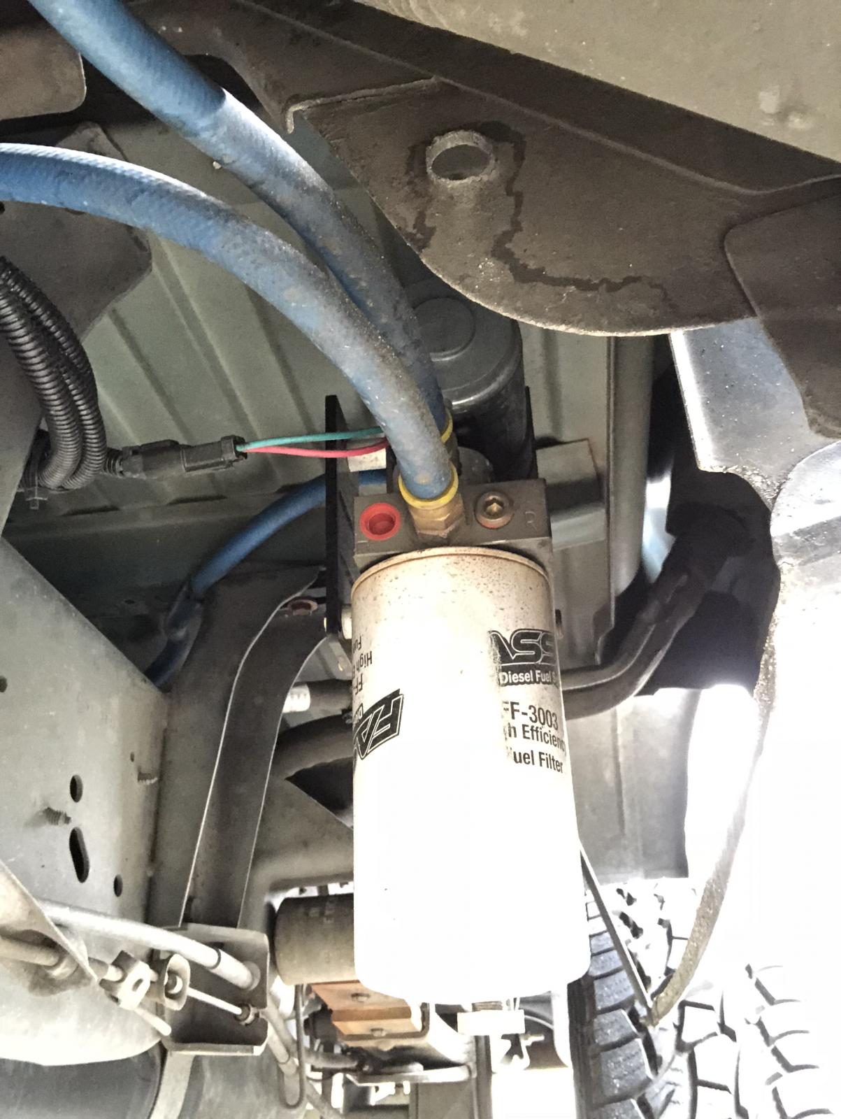

Here’s where I put my relay
I wrapped the excess wire loom around one of the bed mounts. You can see it to the left of this pic.

I really don't like putting any wiring directly on the battery terminals. After a while you have this hairy mess of wires all going to the battery. Like myself I pulled a single ground lead into the cab. Then pulled a single power lead from the PDC. The reason I got away from this is all the ring terminals eventually fail from corrosion issues. So if you mount everything away from the battery this problem stops.
