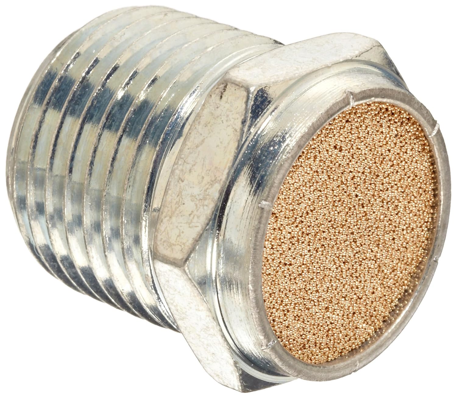

Snubber differences
Are both these things snubbers?  The "sinster" one holds back pressure more, giving it a blow test.  But if any breaks off would not want particles going thru system or are they better?

  • Those both seem to be "snubbers".  But for our application the orifice is too large.   The one I use has a 0.004" orifice in it.   The sintered metal is a filter to prevent a particle from reaching an
  • I am sticking with the needle valve just because it works, not because of any fear of the sintered metal. It has been around for a long time.

"Sinster"one is on right side in both pic's.   And also going to use needle valves for flow control and shut off valve.

Sinister...is real thing.  I thought slang or joke.  Mott Corp makes something like it.
It is sintered metal, not stone. Sintering is the process by which it is made. The vent on my EB is made from it. Google sintered metal.

So in pic's at beginning of post...these are both snubbers?
And no problem with sinister material coming loose in a fuel line?

I guess there’s always that off chance but I’d doubt it. Worse case scenario is some does break off and could clog your gauge or ruin it.

Those both seem to be "snubbers".  But for our application the orifice is too large.   The one I use has a 0.004" orifice in it.   The sintered metal is a filter to prevent a particle from reaching and blocking the orifice.
A lot of places dump all the snubbers in one section and never mention orifice size.  McMaster-Carr lists them by orifice size.
 Does it work ?  with a fass pump, 1/2" fuel line, Tee about a foot from the vp44 ?
The snubber I got from vulcan didnt do anything. I had a extreme gauge bounce
Hmmm,
I use a tapped banjo bolt at the vp inlet.  I have 18" grease gun hose with snubber, coupling, and pressure transducer.  I have a nice steady gauge. (too low of a pressure....but that is the lp's fault....).   I also bleed that line during assembly.  Trapped air can cause weird fluctuations.... It acts like a spring in the system.
If you have the old snubber around, see what diameter hole is in it.  He may have just gotten a batch with big holes in them.
 The snubber I got from Vulcan is .165 hole...
So these sinster metal ones are not even a snubber, its more of a small filter
It looks like the large whole sinster metal one in the picture above
I have a needle valve snubber now. Every thing is workig good now
