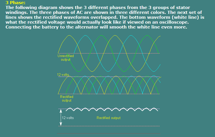

Here is a picture of what is happening:
Notice the rectified output is still wavy. that is "AC noise".   that is what you are seeing.  Those waves in the output get bigger the harder the alternator has to work.  While the diodes are a big part of the AC, there are still the brushes (commutator) also.
