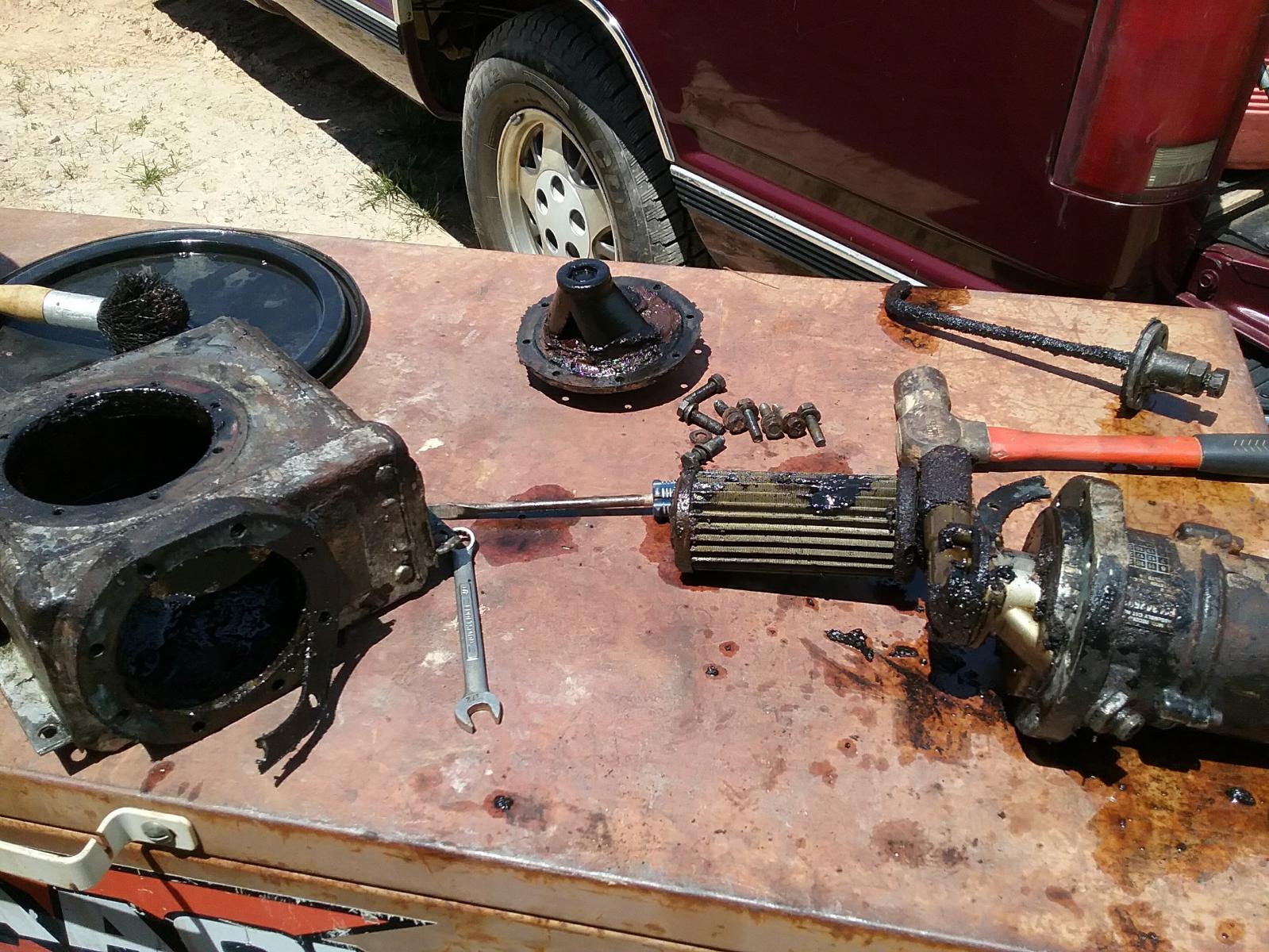

A pre filter makes a huge difference particularly with decades long reliability. We were running stuff that was the original pump from the late 60's.
That is a 15" wrench for size, the two lines came in from 50 gallon tanks of the respective sides of the tank, goes into the box where stuff settles out, through 4 overlapping screens into the pump, then to dual filters before the injection pump. The filters going to the injection pump never had any build up on them. Had a few tanks that would get gunk built up around the pre filter until we pulled the tanks and had them cleaned.
50 years of gunk.
Process of cleaning.
Back together and mostly ready to go back into service.
