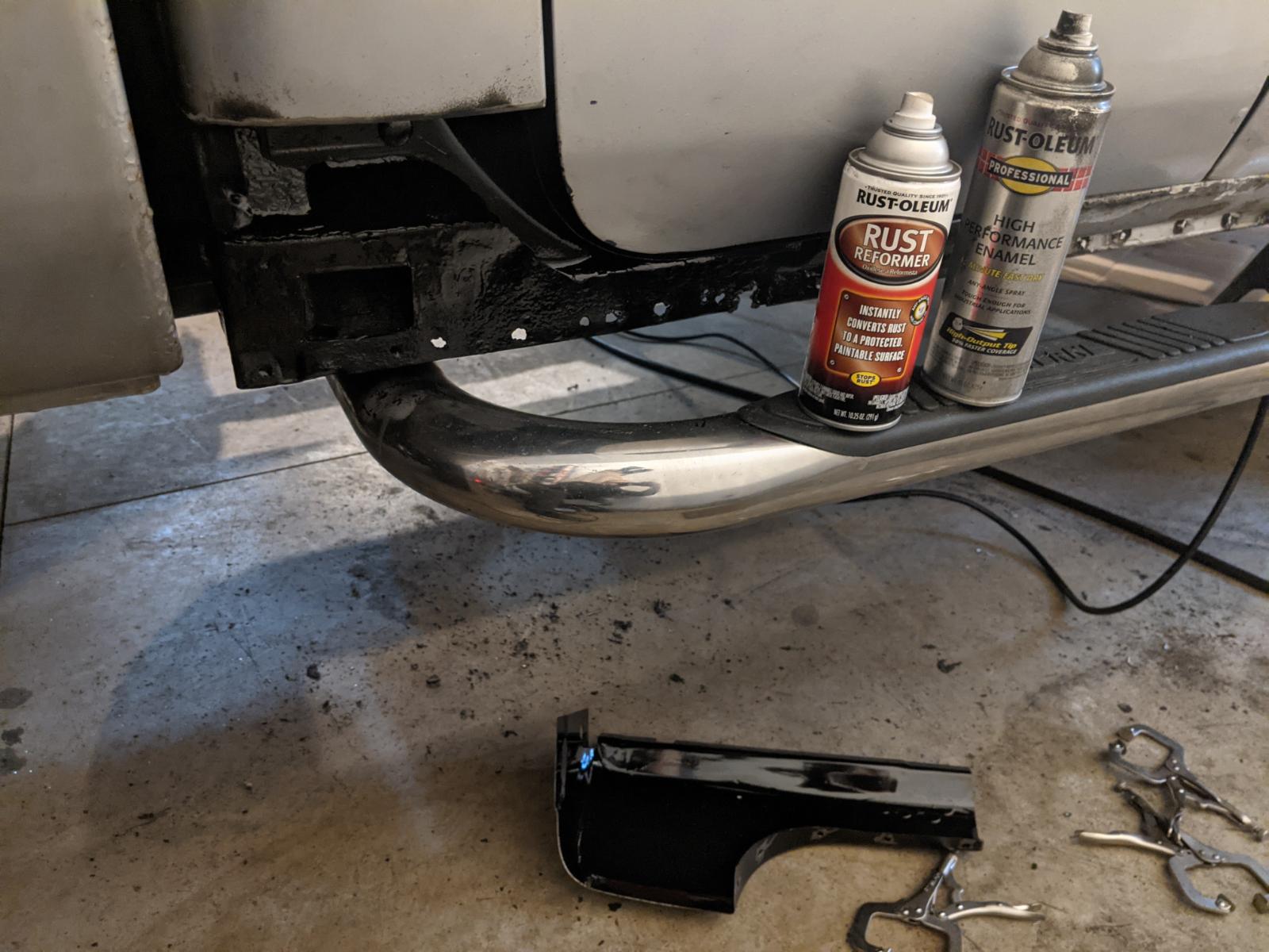

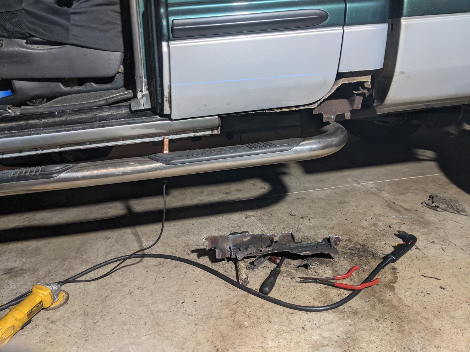

Well one down one to go, driver side didn't look bad until I cut in to it, glad I did need to make a back plate on this one.PXL_20201218_191035332.jpg.858391502e81fb0abe6290f96766c548.jpgPXL_20201219_014446542.jpg.91ca7e289ca6784108586efac70311b5.jpg
So time consuming, especially when you don't do this for a livingPXL_20201219_045723264.jpg.6c643ed6a690e81de83e0534d4bc5e25.jpg
 Can I ask what you used to cut the old pieces out? Just curious, with the bed still on there isn't much room once you get around the corner of the cab.
 Also, are those the "slip on" cab corners you mentioned earlier in the thread? Looking good so far.

Plasma cutter helped, then some salzaw, grinder with cut off wheel, air tool with cutt off wheel, little bit of chisel and few beers. You can get to some of it from under the bed, eventually I'll take the bed off and finish it with final touches, for now will seal it off and paint. Probably going black on bottom now with some bed liner.

Both sides primed just need some pait/bed liner. Cab corners weren't exact match so there's a bit of discrepancy, it'll be fine if it's all black :lmao:, like the song paint it black.PXL_20201220_035400804.jpg.29bd561760f11e621e95d047030e549a.jpg

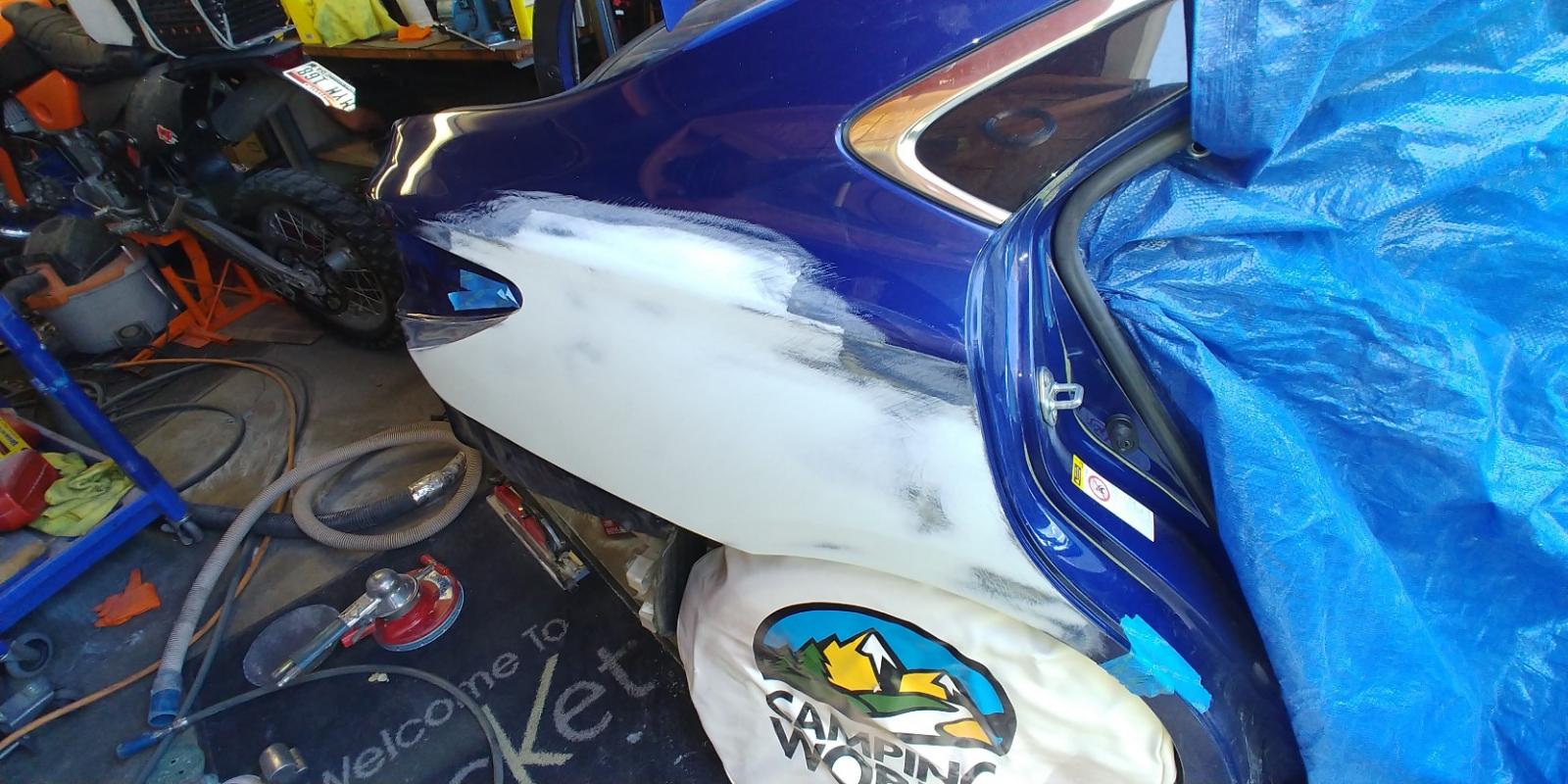

Here's a tip for getting professional paint results on the cheap, take something like your gas cap to a body and paint supply store and ask them to match it, then have them put in an aerosol spray can, (base coat) then finish off with spraymax 2k clear, also spray cans.
Maybe lightly wet sand with 1500 grit and polish. I've done a few that way and got excellent results.
Here's a few pics of daughter in laws I did in driveway last summer.
20200421_124732_copy_1664x832.jpg.71a41f2e0a35262882ea26d0f1a4e24a.jpg20200425_192546_copy_2080x1040.jpg.2b0ea55dfb0ce96c2c058fbc7c3e20b8.jpg20200428_160410_copy_1664x832.jpg.76af9362123ec56e17b2bb818b6a1989.jpg
