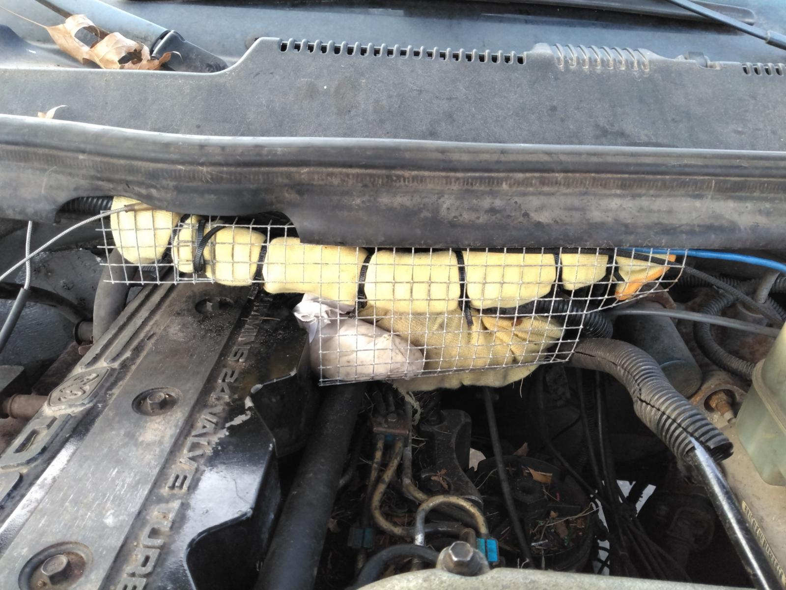

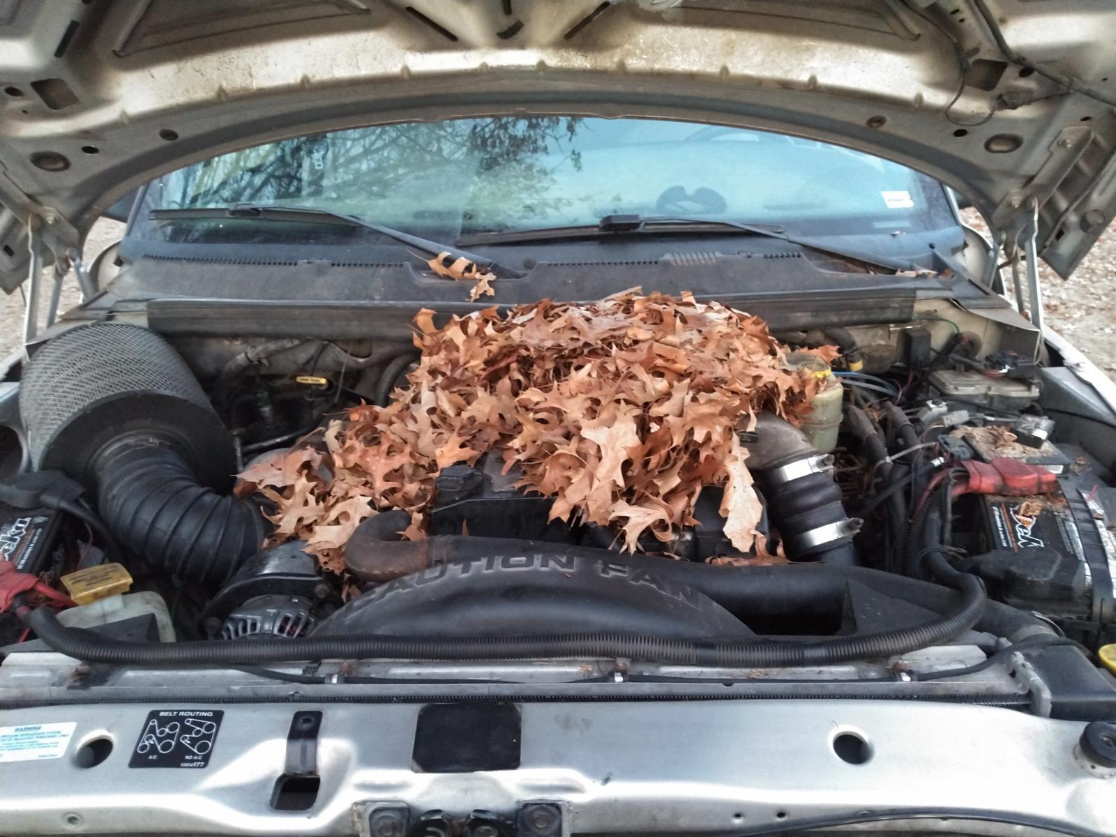

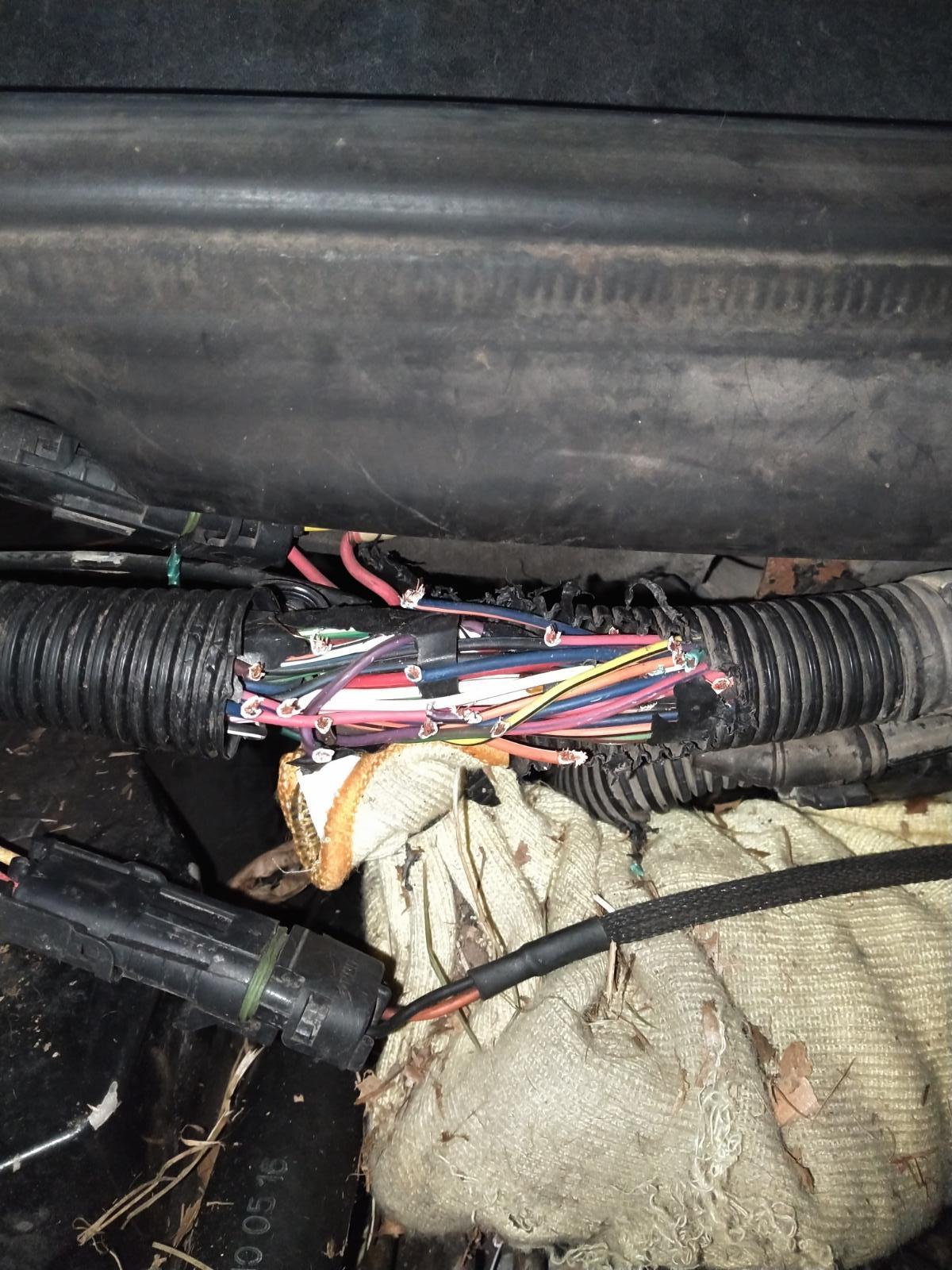

Drove the truck last Tuesday, then proceeded to get awfully sick so truck sat and became a nest.  Wanted to move my trailer, no start, and found this.

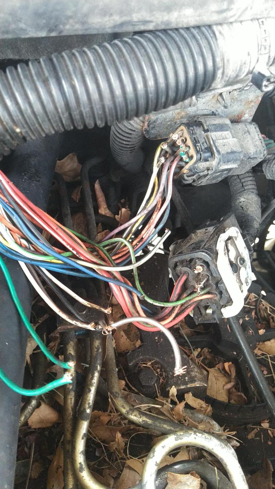

No idea how to take the pins out of the plugs so I can attempt repair. Guess I'll research this over the weekend. Sweatshirt weather today, and Winter begins tonight with sleet and snow, and 4 degrees by Sunday! Late start this year.

When my truck was parked for a while (week or two at most) in the early summer, I popped the hood and staring at me from a partially built nest of firewall insulation was a rat.. like body (not including tail) was as wide as the valve cover.. no munched wires at the time but I have a feeling he just moved down to the tranny tunnel. A while later found a nest on top of my tranny by the shifter.
I don't think any piece is better than the other per se.. The biggest thing to get right is the crimp(s), followed by the correct sized wire seals and/or plugs. After that its what package/footprint do you want.
For reference, the apps connector is a deutsch connector. Specifically a dt series.
@LorenS, whatever kit you get, just make sure you have the correct crimper for that kit/connector series. Weatherpack, metri-pack and deutsch have different crimpers/way of crimping I believe. Way of crimping meaning how much to strip, where (dimensionally) to attach the crimp, whether or not to attach to the insulation.. It gets complicated the more you dive in to automotive wiring..
ceautoelectricsupply.com has a lot of the info/parts/tools I have found. Don't know their price vs. what's the average/normal.. Also not the easiest site to navigate..

I ordered a supposedly-genuine Delphi kit that includes the crimpers and assortment of seals, pins, bodies, etc.  And the removal tool.  If this setup leaves me stranded maybe "next time" I'll get the Deutsch connector set - or just hardwire it all.  In 21 years and 345k miles this is probably the first time those wire looms have been pulled out of their resting place on the firewall.  They may have needed the connectors in Saltillo, MX to build the truck, but haven't been used since.

I think the connectors that got eaten were the ecu/pcu connectors. Since its a Cummins engine and not a Dodge engine, the engine and body were entirely separate so just have everything needed to make the engine run on the engine, then anything needing to talk to the pcu go into a set of connectors that get attached at assembly. No messy wiring bits just connect and go.
