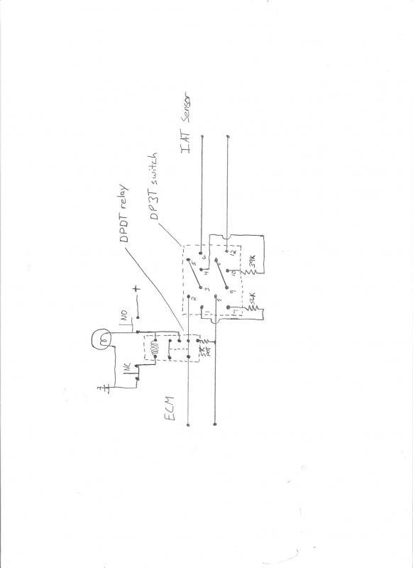

ISX, When I redid the wiring, for a LED lighted switch to know when it is on, I used a positive wire from the switch to the relay, using the same hole for all my gauge wiring, and then to a body ground. This way everything is still a 2 wire hook-up, along with the wiring connectors to the IAT. stodg73

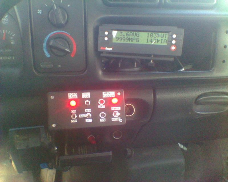

That exactly how I'm hooked up but I got to remember to flip the IAT fooler for the high idle on to over ride the resistor in the plug so I do get grid heaters. PITA really... Because if you forget and then flip it on after the key then it too late and the ECM will not fire the grid heater no matter what you try... So you got to fight it and get started... Rather harsh...:duh:

Mike put in a potentiometer (variable resistor) and is testing to find optimal setting, though I think he is having some issues with the potentiometer he is using (way too high of range resistance). I was wanting someone to use a 5K one so they could change it more precisely, possibly even watch the instant MPG on the scangauge while your driving to find the best resistance setting. But you basically want a resistor around the 2-4k range. 2.2k is what I used in stodg's which should be around 143, 2.7k is 132F (the one mike used before putting in the potentiometer). There is no solid answer as to what the resistance should be, but at least 100F seems to be the key. Hmmmmmmmmmmm, I wonder if you could hook it in with the ECT sensor. Would work perfect, though I think over 200F throws a code? I might know how to get around that.
That’s exactly what I am doing using a dpdt on off on mini toggle and a 5K pot. I like the idea of using phone cable to connect it to the IAT location. I really am hesitating on cutting into the wiring to the IAT. I would like to build a plug compatible harness to just plug into the IAT on one side and the harness on the other. Anyone know where I can get connectors?

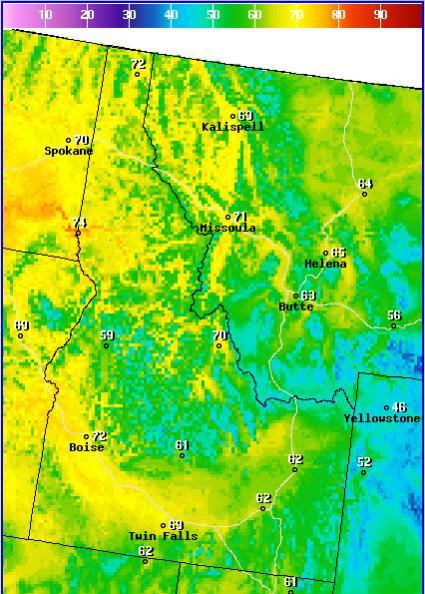

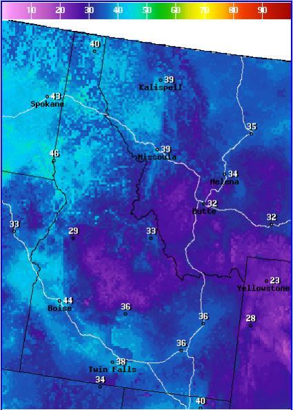

Well just double checking again to see if the there is a change... My weather this morning was -7*F and IAT was hooked up to the sensor (NO FOOLING RESISTOR) I ran my day and topped out at 15.8 MPG with cruise set at 55 MPH and only passed 1 vehicle the whole trip from Home to Donnelly, ID and back home. So the warmer temps are scoring better MPG's for sure. IAT was hovering right around 49-53*F... Cold Air Intakes suck big... :lmao::lmao2: Like I said the only change was the resistor was removed and the IAT sensor hooked up and took a down fall in MPG's.
well thats a good thing then right!?! that proves that the fooler is working and you can continue on with some fine tuning!!! great work Mopar thank you!!!:hyper::hyper:

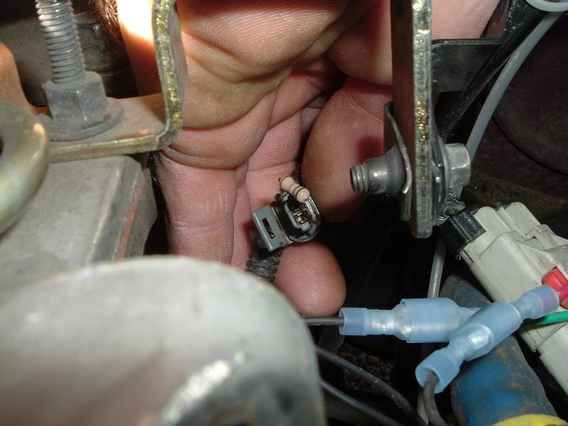

Just unplug the IAT and stuff a resistor into the plug...
Simple enough that's all I'm doing...
