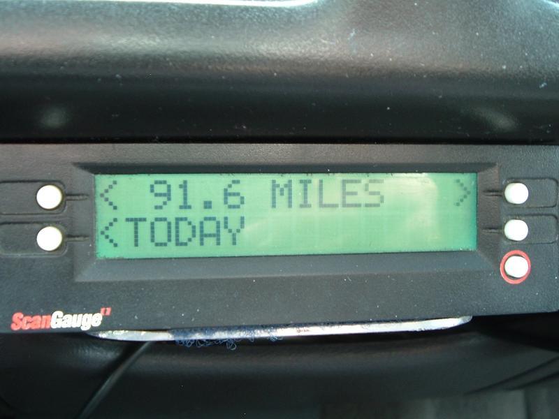

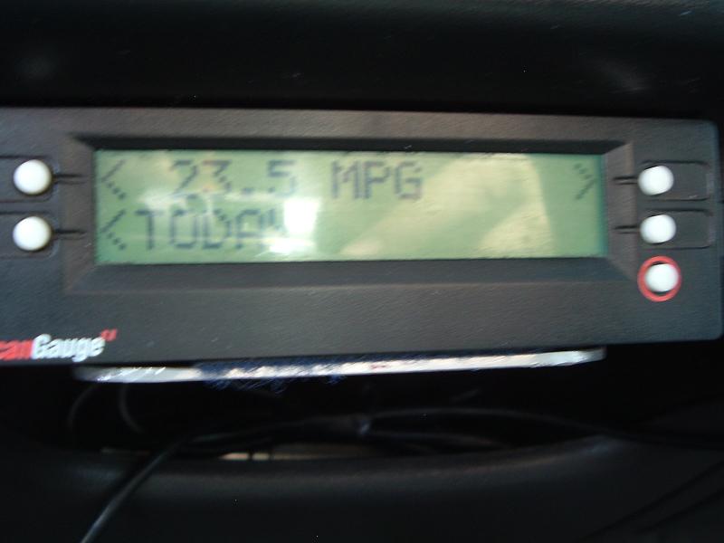

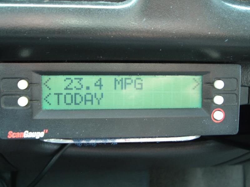

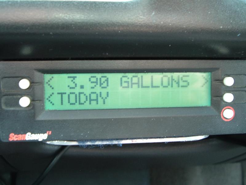

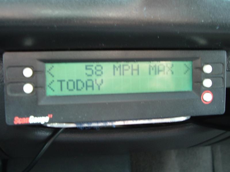

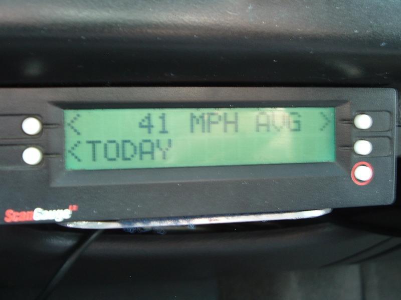

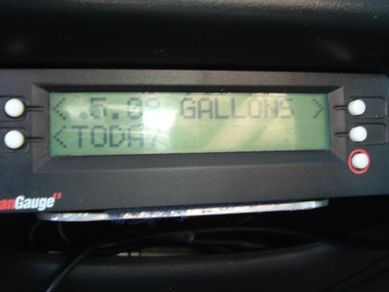

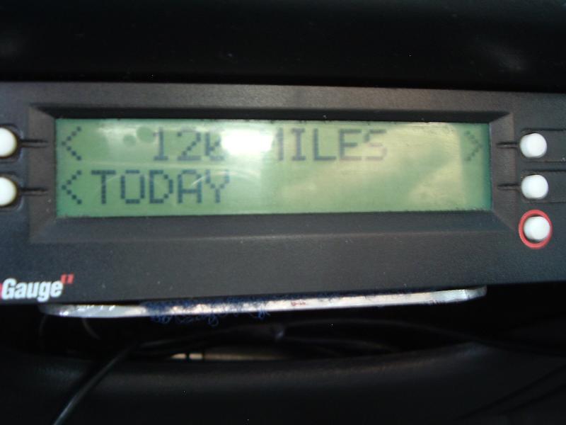

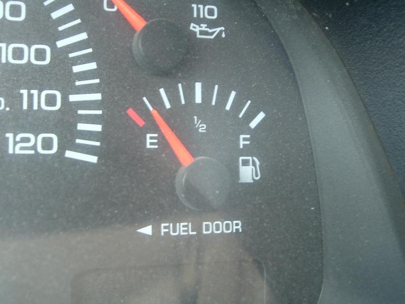

Update... I beat my last few averages I'm now at 23.4... (91.6 Miles / 3.90 Gallons = 23.48 MPG) More on this later... post-2-138698176309_thumb.jpg Used 3.90 Gallons post-2-138698176302_thumb.jpg 91.6 Miles traveled post-2-138698176268_thumb.jpg Max Speed 58 MPH post-2-138698176255_thumb.jpg Average Speed 41 MPH post-2-138698176318_thumb.jpg As for fuel it was just below the quarter mark when I left the house... post-2-138698176261_thumb.jpg Take note of the last fuel entry... 2-14-11 http://forum.mopar1973man.com/attachment.php?attachmentid=2583&d=1298817223 ____________________________________________ Now I add a trip to Riggins, ID... I topped out at 25.3 MPG on the way to Riggins, ID but my way home bucking wind I still held 23.5 MPG... 23.5 MPG post-2-138698176334_thumb.jpg 120 Miles post-2-138698176328_thumb.jpg 5.08 Gallons post-2-138698176341_thumb.jpg Fuel logs... post-2-138698176347_thumb.jpg
