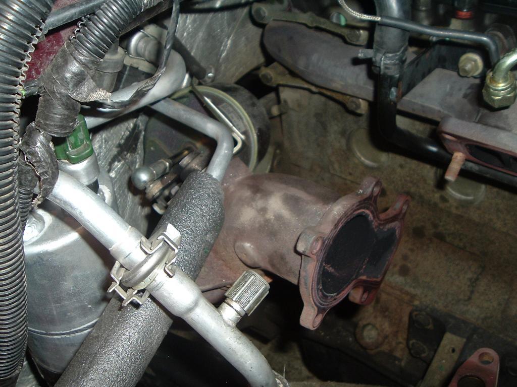

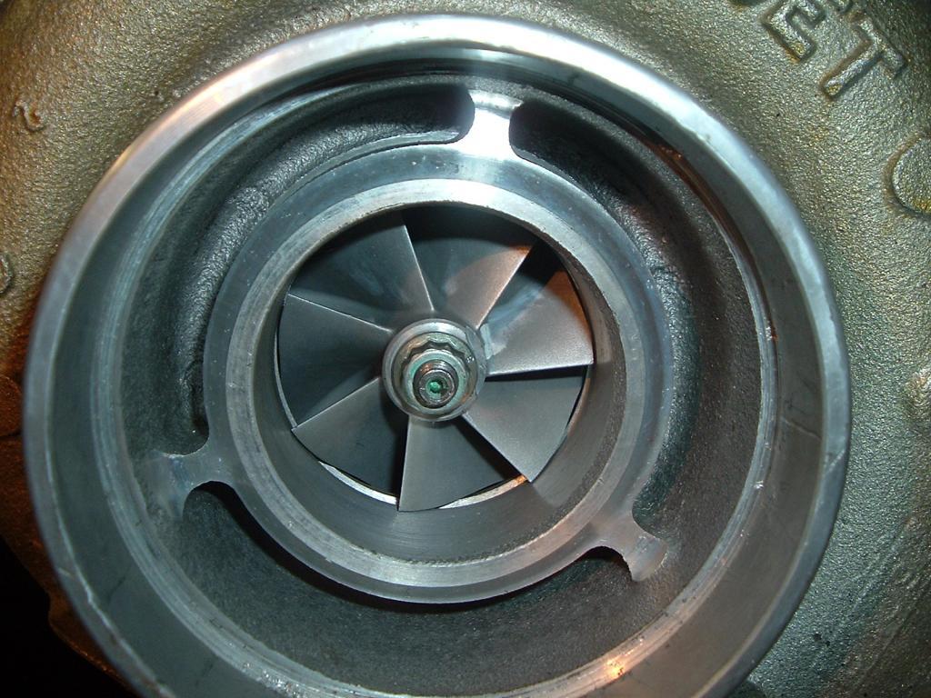

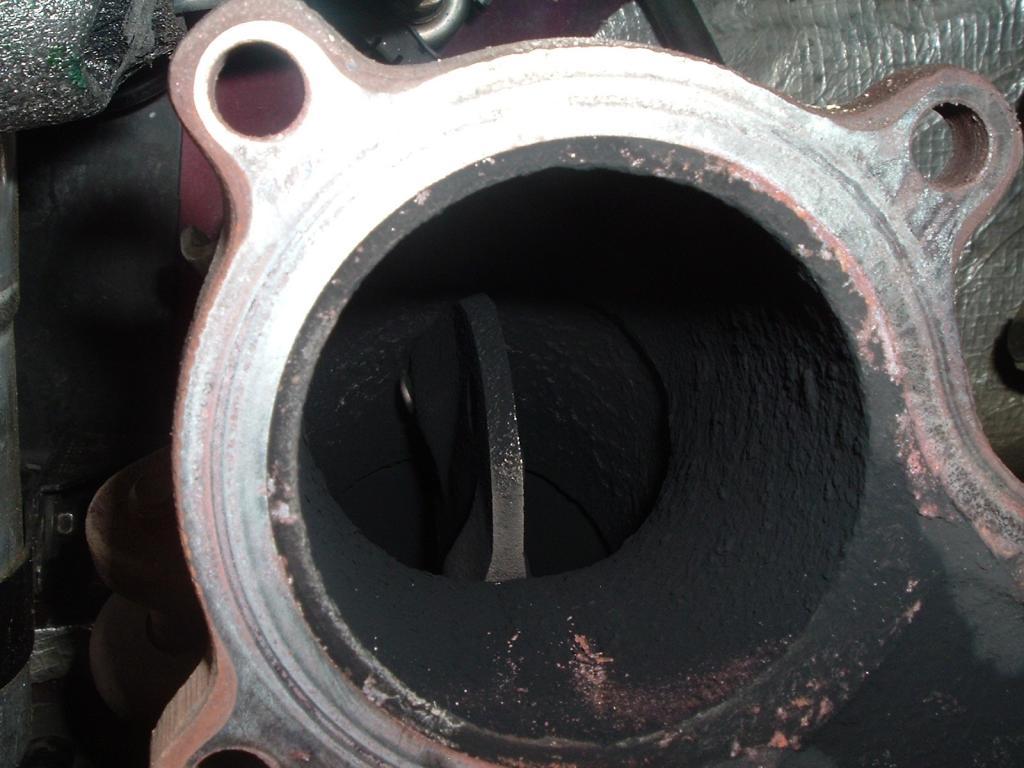

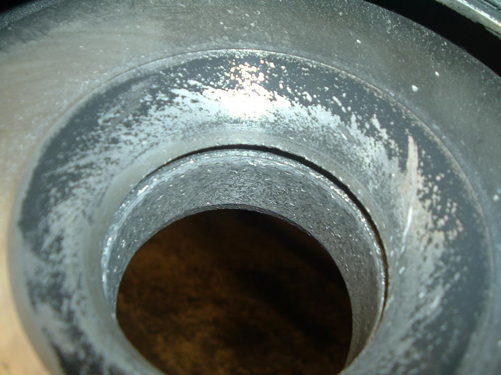

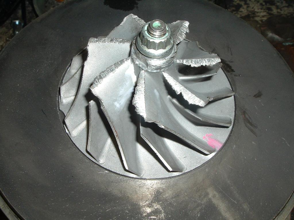

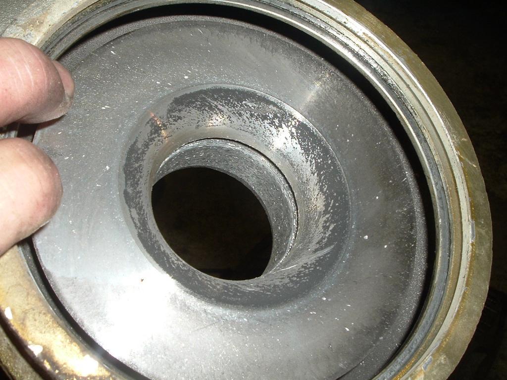

:duh::doh::banghead:Yeah gang... I destroyed my turbo with a wire hose clamp. post-2-138698196468_thumb.jpg During my oil change and boost leak fixing I laid my BHAF on the workbench and inadvertently knocked a wire hose clamp in the BHAF from the peg board above. Installed the filter and took a ride. Boost kept getting lower and EGT rising whistle changed big time. Hua?! Went home to find the first pic and the 2 ears of the clamp in the BHAF. The rest of the ring I'm hoping is in the intercooler. :pray:Engine still runs fine... So I need a turbo... First and foremost.I know that S#!7 happens but man this make me sick... :sick:

Broken studs and compressor housing won't come off??? You didn't let the penetrating oil soak in to those bolts did you :evilgrin: The compressor housing is just a snap ring and it pulls straight off. If it was sommmmmehow welded to the wheel, then you could take the nut off the wheel and the compressor housing and wheel woulda slid straight off. So, what was the deal with it? Sounds like you admitted defeat, I want to know why!
Broke one bolt on the exhaust housing (exhaust brake). Then the 4 that hold the exhaust housing on the one behind the oil inlet is frozen can get it loose at all. But it boxed up and ready to head out.I don't have the tools for drilling, tapping and heli-coil the hole properly. I understand the method of it just lacking experience and the tooling.

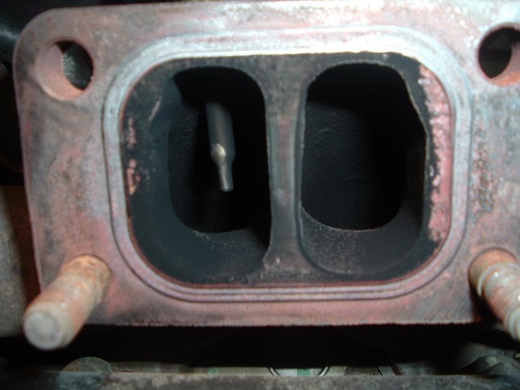

And get some damn pictures of your exhaust brake and inside the exhaust manifold showing your pyro probe! Need to see what yours look like compared to mine.
