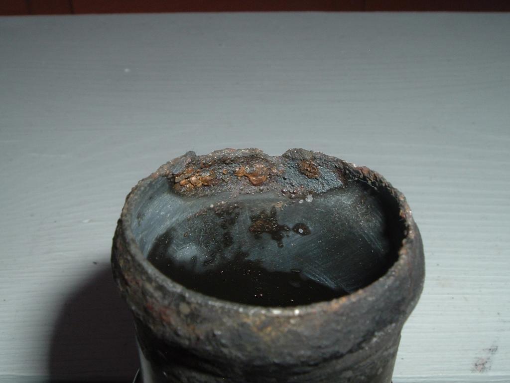

Eeekkk! Change both. Coolant doesn't matter on appearance what matters is the pH level. Fresh coolant will be right close to pH of 7.0. If you want to extend coolants I highly suggest you test the coolant with pH test strips made for coolant. Once coolant degrade it starts eating everything. By the time you see the rusty color its way too late. Coolant was still nice and green in my 96 and it was still factory coolant with 112k miles. Opps... Too late it already started. post-2-138698209895_thumb.jpg Power Steering fluid does break down with heat and pressure. So over time the fluid starts to fail then parts start to wear and BOOM. Now the steering box or htdro-booster is feeding everything else debris (metal particles). Since there is no filter it doesn't take very long for the debris to wipe out a system. Any fluid that is discolor including brake fluid it broke down...

Eeekkk! Change both. Coolant doesn't matter on appearance what matters is the pH level. Fresh coolant will be right close to pH of 7.0. If you want to extend coolants I highly suggest you test the coolant with pH test strips made for coolant. Once coolant degrade it starts eating everything. By the time you see the rusty color its way too late. Coolant was still nice and green in my 96 and it was still factory coolant with 112k miles. Opps... Too late it already started. Power Steering fluid does break down with heat and pressure. So over time the fluid starts to fail then parts start to wear and BOOM. Now the steering box or htdro-booster is feeding everything else debris (metal particles). Since there is no filter it doesn't take very long for the debris to wipe out a system. Any fluid that is discolor including brake fluid it broke down...
