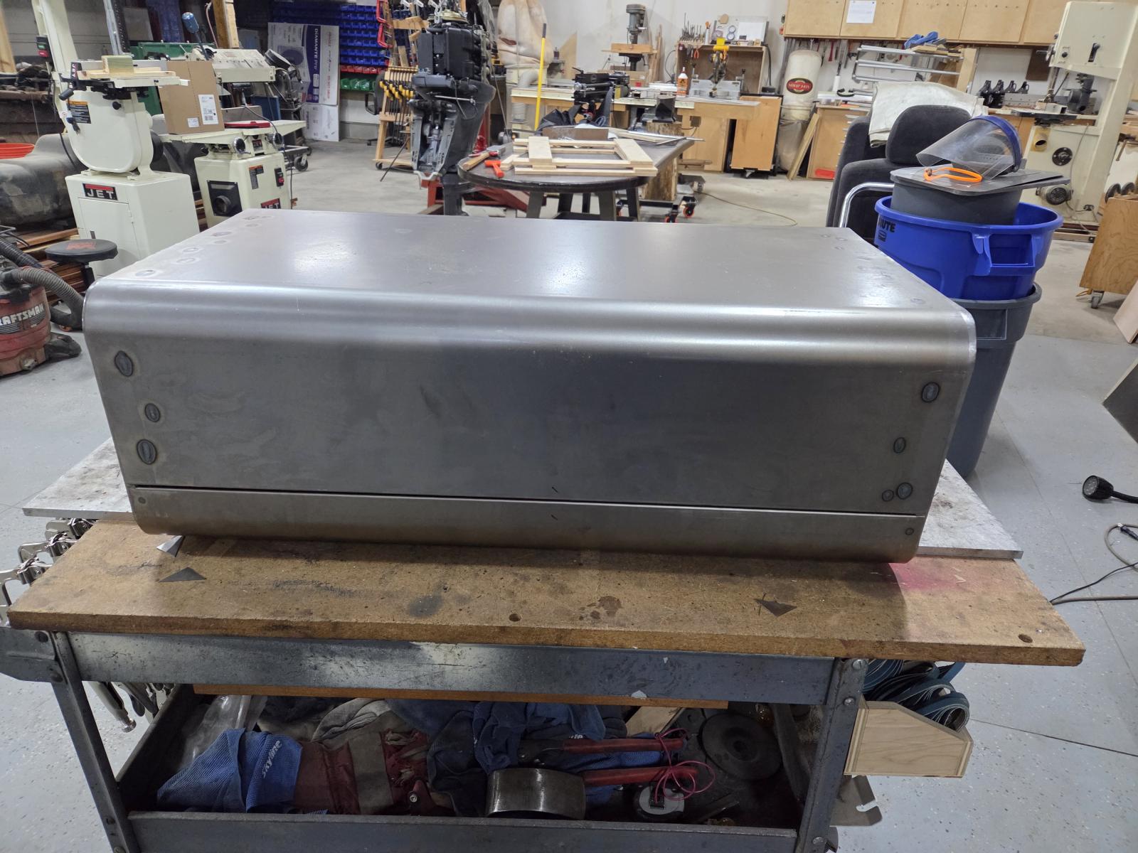

Neighbor runs a car shop and had graciously offered to help for free (beer and food) to help me out over the course of the summer while at the bonfire...well he seems to want to get it done because he's been on my case!  Last night he taught me some BASICS of the English Wheel!  First pass shown here.  A little more crown to add in the middle but close!
