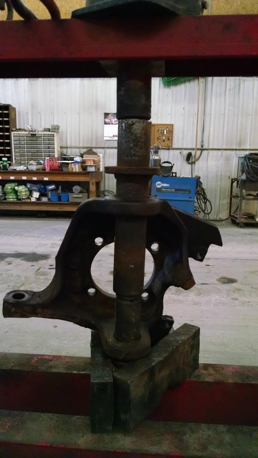

If you have access to a shop press I set mine up like pictured when doing ball joints, most times I never have to touch the torches but sometimes it needs a little heat on the knuckle to open it up some to break the ball joint loose.

That's your issue, I said a little heat, red hot gets everything hot and expands together including the ball joint so you are just as tight as before heating it. A bit of heat to the housing is all it takes but not red hot.
