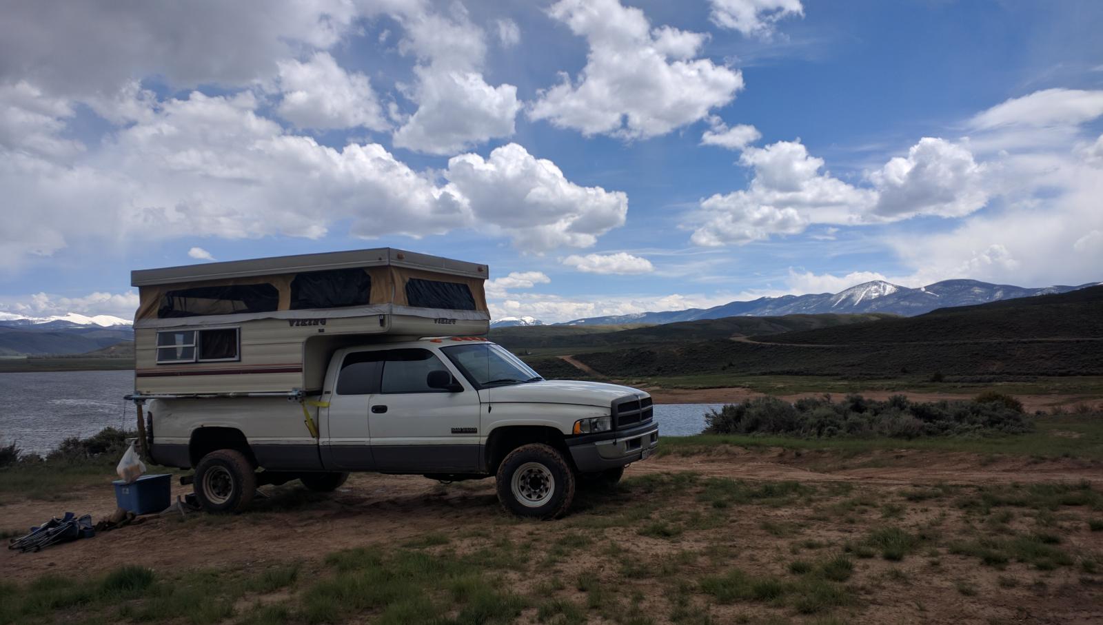

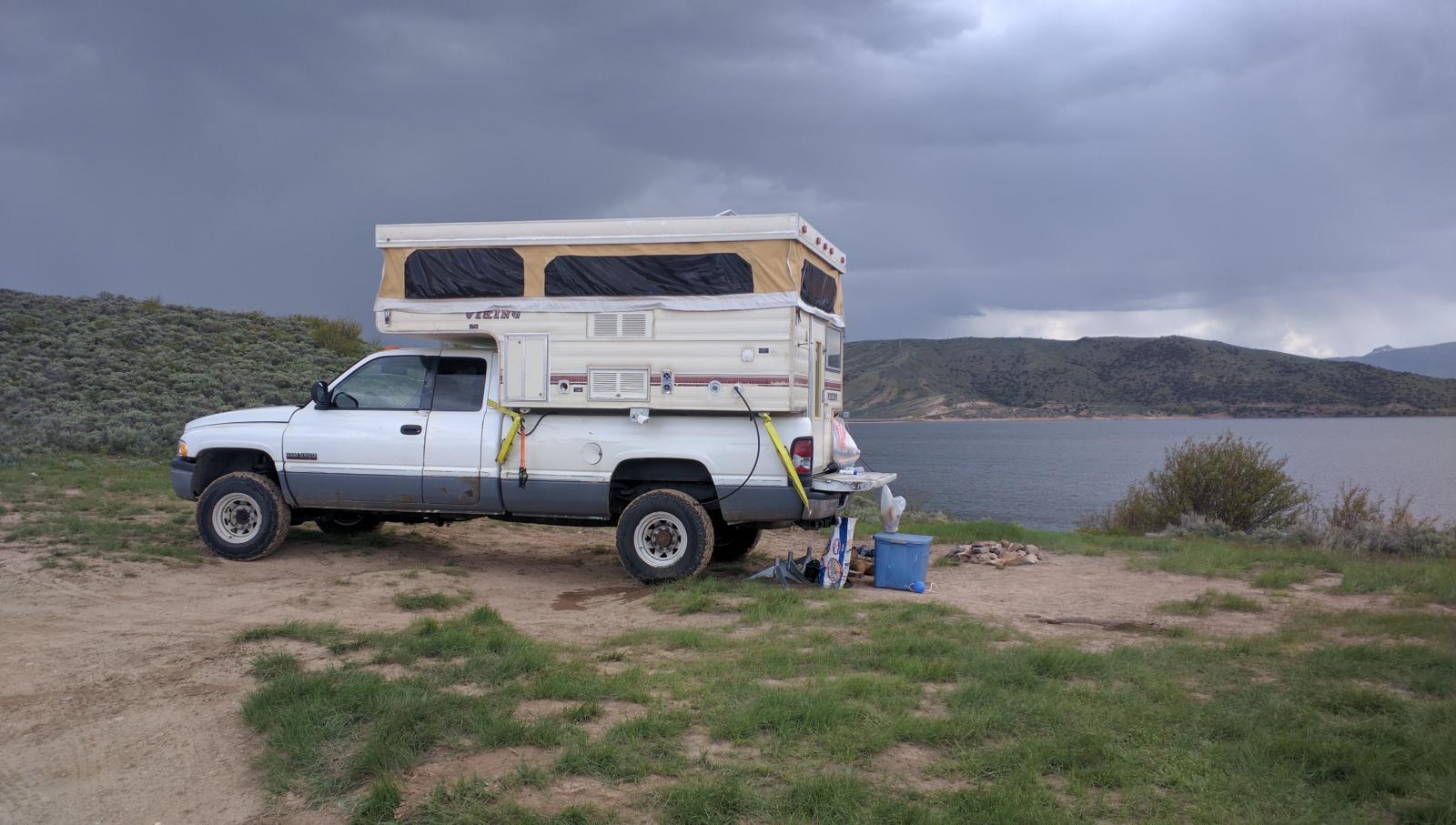

Pictures of the campsite
3 days of power use, lights, radio, water pump, and charge cell phones.   left the site with 12.4v on the group 31 that runs the camper.  I filled the propane at the start of the trip,
last trip was near 0 outside 2 days heater running the whole time used 1 gallon of propane.
Very happy with how the camper worked.

It's beautiful up that way. Did you go up Berthoud or up through silver thorn? I dropped my mom off at my sisters in steamboat Wednesday, worked in Silverthorn and around Blackhawk until Sunday. Did you get any snow? I had a dusting Thursday night north of Blackhawk
Nothing like having a nice truck to go with it. Looks nice for sure.
Now you are ready to meet up with all the rest of us at the 2017 full eclipse in western Idaho, Right?
