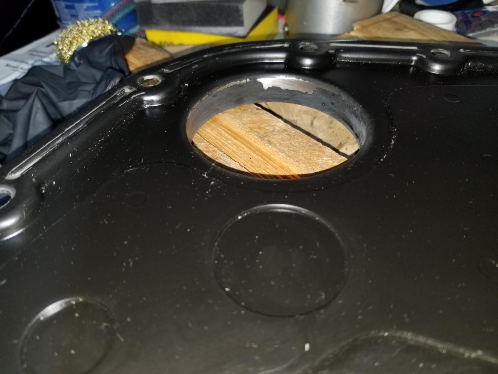

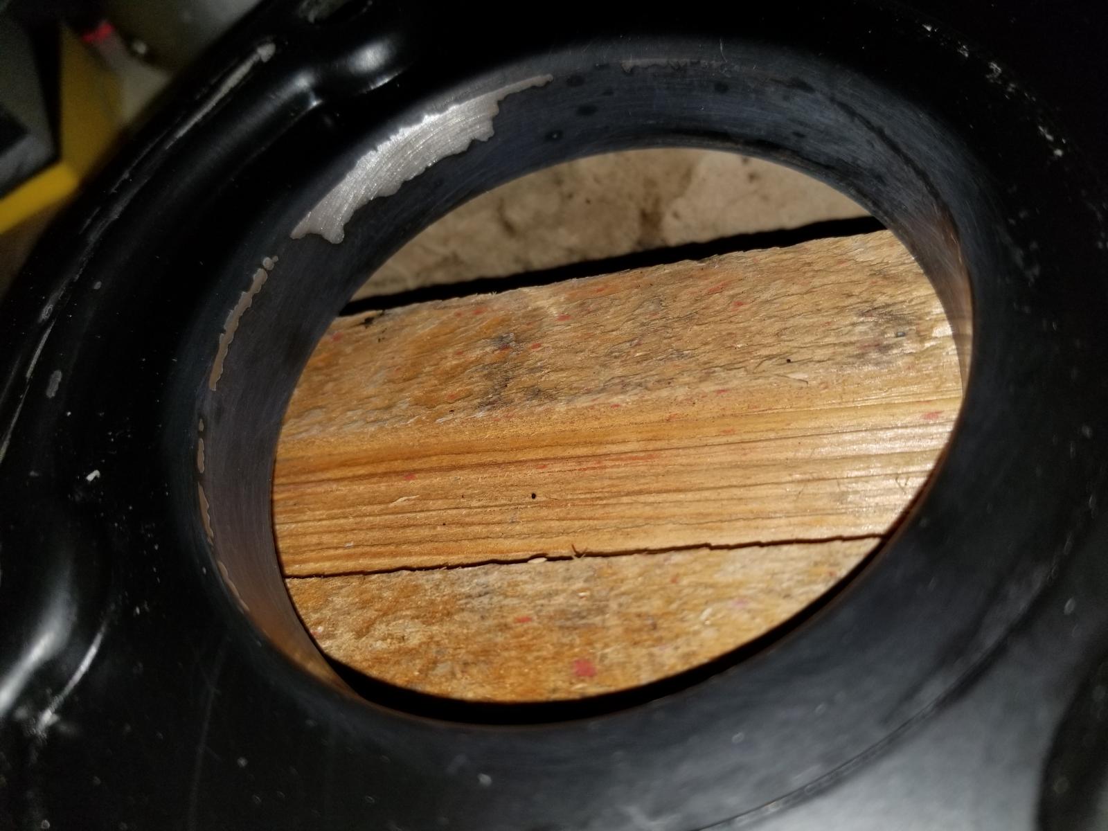

this is what the dealer did to me...... twice.  he put it in the wrong way and not only did he do that he put on gray silicone rtv on both the inside and outside of the seal.  no no no no no!
right hand side of the photo also broke the lip the seal goes into. before i took this apart he told me to buy a new cover b/c he thinks it was warped.  ummmm.... or u broke it.
This one you can see how this is really installed backwards:

Your correct on the seal placement. Just that I typically remove the cover and drive the seal in. Now take notice to the position of any old grooves. I'm sure there is. The plastic sleeve is to get the seal started over the crank once the cover is in place you pull the plastic sleeve out.
Edit I didn't realize till now that seal is in backwards. :thud: No wonder it leaks.
yup. he did every possible thing wrong.

Something to take notice to... Look at the pictures again the seal is installed backwards.
Front side.
That the back side lip.
Backisde...
That is what I initially thought.  I am not 100% sure now when I pulled the cover off I took photos.
Rear of the cover:
this is the front of the cover:

oh and it looks like the seal is installed correct, but how it was installed (from the rear or with improper tool) could have caused the seal to become warped or damaged allowing leakage. Plus that RTV is not helping...
