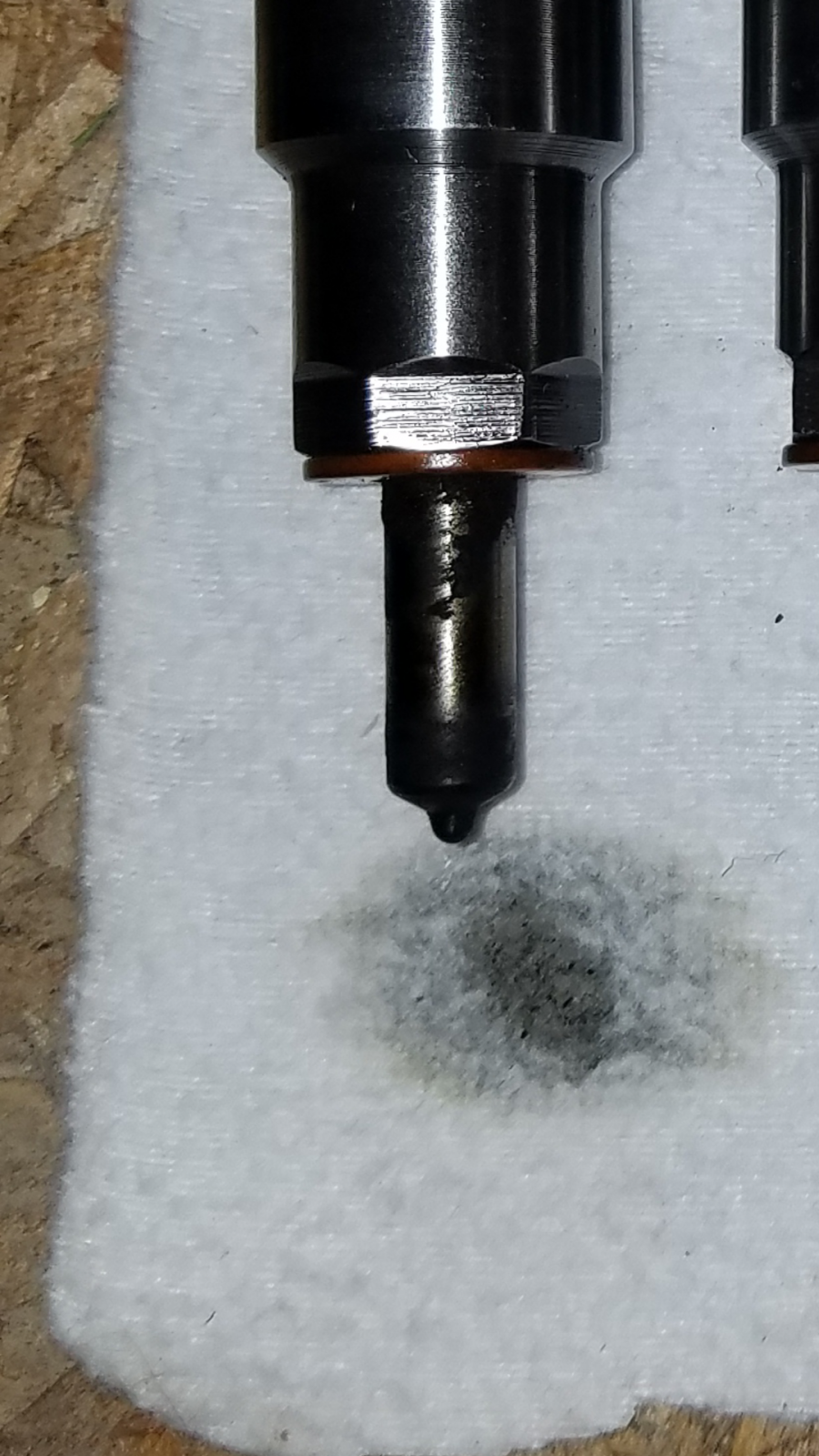

So i pulled my injectors when i installed valve springs and mantons...well they were dirty as heck and full of ash.could barely see the holes,truck has had optilube every tank since injectors went in (2 yrs ago).is this normal??thanks
This is not normal.
Cetane booster tend to add soot to the injectors. 2 Cycle Oil you might try it. I'm going to bet my 80k miles injectors are cleaner that your 2 year injectors.

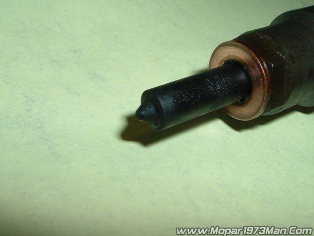

So this is what ive been running and after the look of moparman injector with 2 stroke i will be discontinuing use
