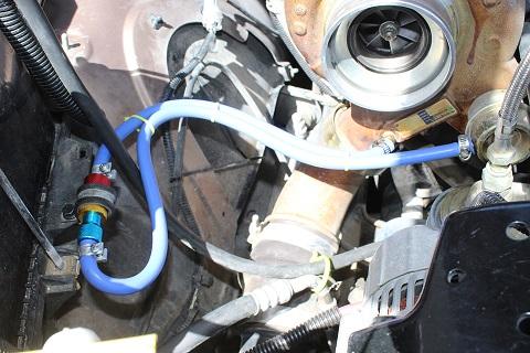

I installed my  man ual boost controller and I never see more than 28 psi no matter what settings I use on the controller.
my turbo says it is HX35W garertT    BDH3536160. I think my next step is to put 30 psi to the boost gage and see if it read correctly. Sound like the next move?

I will  Check the gage for accuracy or there could be a boost leak is my guess

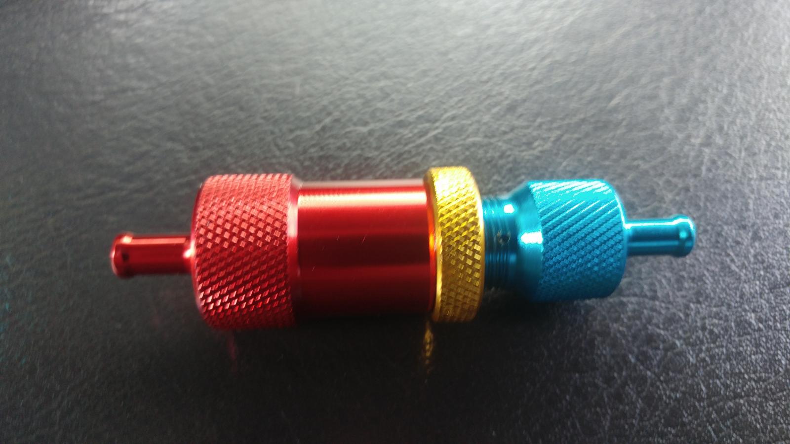

well I can not figure out how this manual boost controller works. I have the boost pressure entering the red female threaded portion. and the blue going to the valve(not sure the name) For one thing if I blow into the blue end the air just flows out a small hole in the threads of the red piece.and can not see how pressure would build up.  I have put it on my compressor at 40 psi and can not get hardly any flow at any thread length setting. So I am confused how this works.
Might be too much spring strength and the boost can't overcome the spring. You are hooked up correctly in on the red side and out in the blue side to the wastegate. Basically, the pressure has to overcome the spring and check ball to apply pressure to the wastegate. The hole is there to bleed off pressure after the pressure drop below your setting. I've got mine nearly all the way lose and the boost just barely hitting 40 PSI
Might be too much spring strength and the boost can't overcome the spring. You are hooked up correctly in on the red side and out in the blue side to the wastegate. Basically, the pressure has to overcome the spring and check ball to apply pressure to the wastegate. The hole is there to bleed off pressure after the pressure drop below your setting. I've got mine nearly all the way lose and the boost just barely hitting 40 PSI. what about this type of controller may have better control https://www.youtube.com/watch?v=w0lxBJ4k8mk
I did recheck the boost gage and it is correct, mine will only develope a max of 28 psi, but I relocated every thing so it is easy to access and will be able to maybe cut some of the spring and do some tests, That does make sense, that it would have to bleed back or the check valve would keep it pressurized. thanks for the input.
