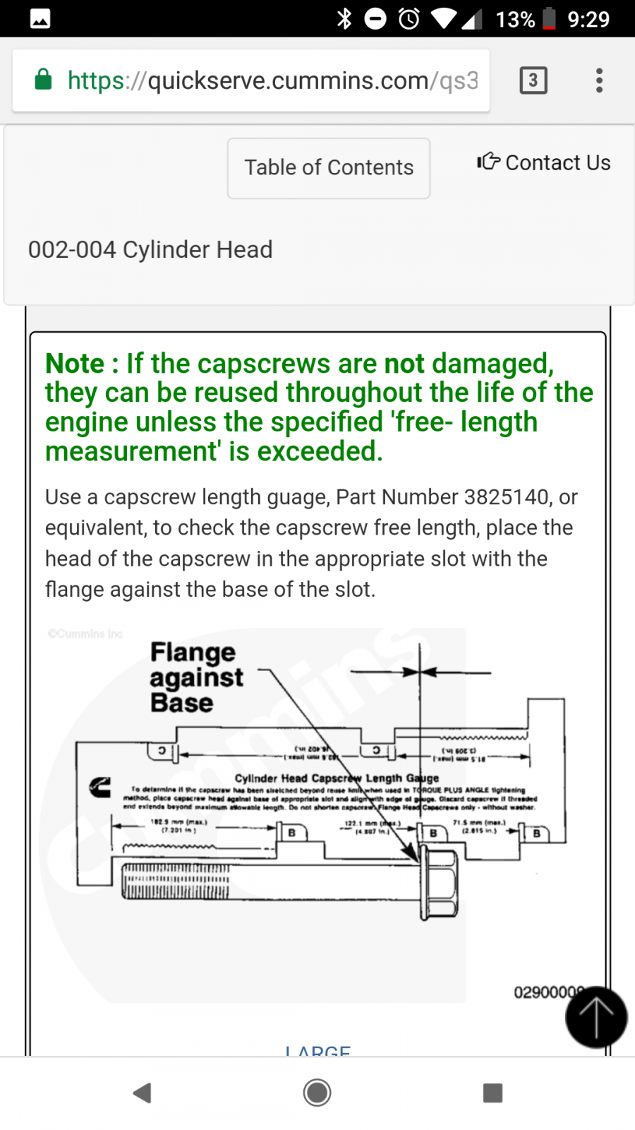

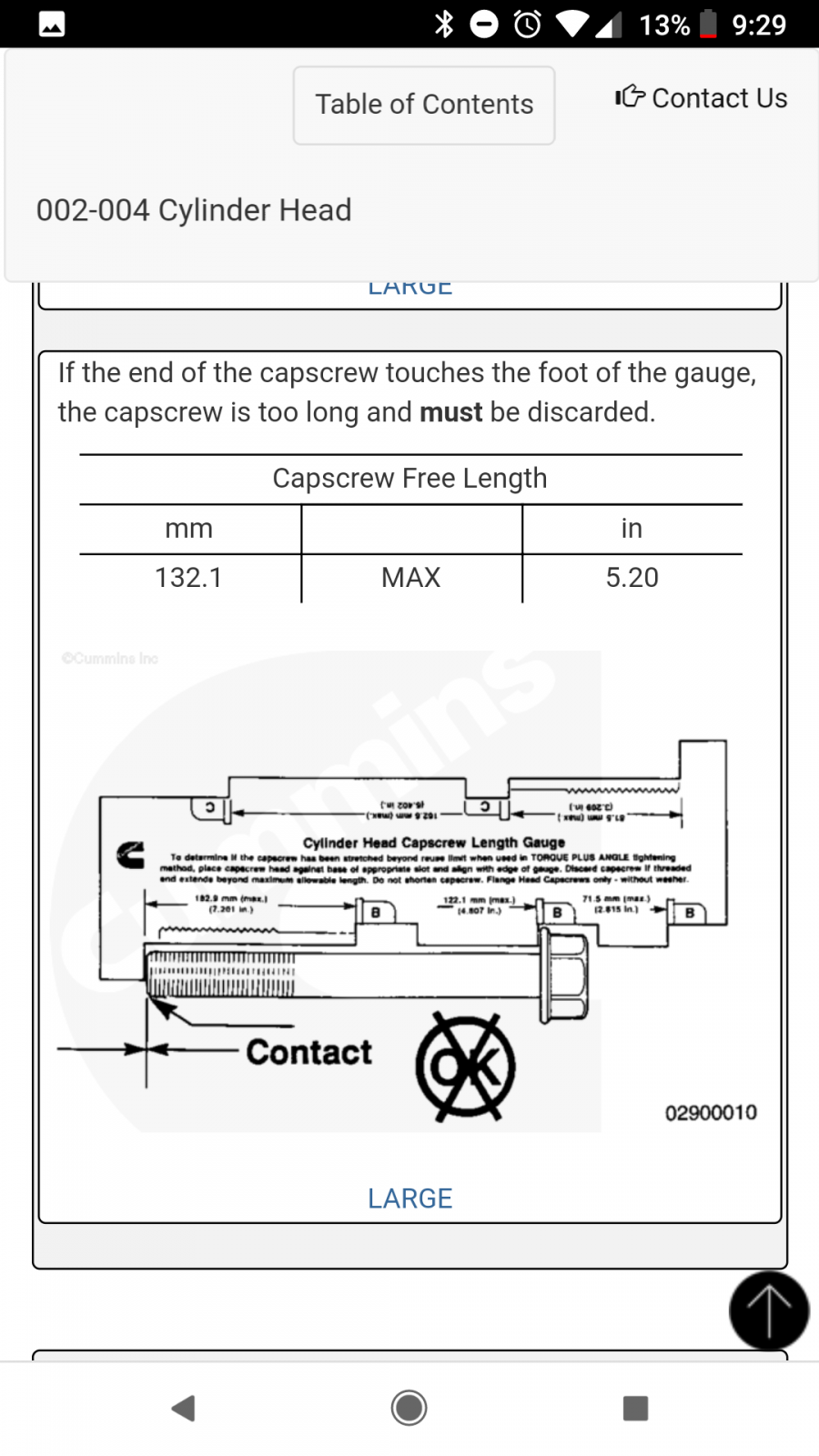

What book says to replace head bolts? The engine designer and builder says head bolts can be reused if bolt free length does not exceed maximum length. The screen shot below is per Cummins on a CM550 VP44 ISB 5.9 engine.

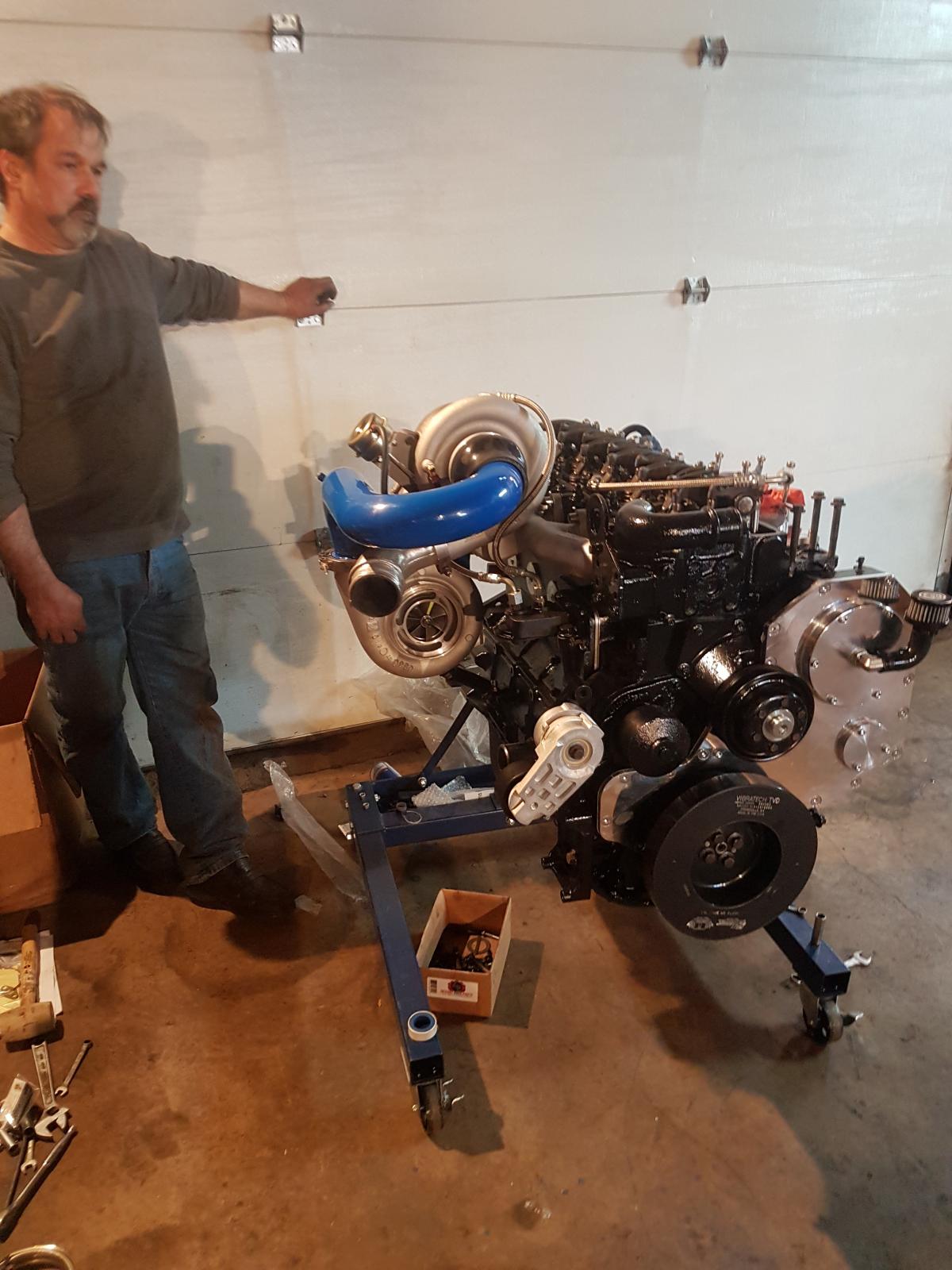

Yes, the bolts are designed to stretch, every fastener on the engine will stretch including main and rod cap bolts, even water pump mounting bolts. Also OEM Cummins head bolts, main caps, and rod caps are designed to be torqued to spec with clean engine oil lubrication, not anti-seize or substitute, on the threads and bottom side of the flange bolt head.
This was the last ISB I built and as of 2 weeks ago had about 20,000 miles on it mostly running from Milan, NM to his home in Dallas, TX and back every week. Not one new bolt went into this build.
I hope my engine sounds that good when I fire it up, think the pipes will thump. Stay in Grants on my way to folks for Christmas past several years in Mesa, run down through Holbrook to Payson , gonna miss this year though.
Here's another thing I've found in the Common Rail 5.9 a few times. I'm not sure if Cummins ever screwed up on the VP ISB. May be worth looking to make sure your rods go in the right direction.

Yep, I needed new pistons and my machine guy got them on backwards, when 1st rod I put in hit block was a big clue. Like that bottom brace, not sure I have enough HP to justify but hey would be nice.
I adapted a fuller FSO 8406 behind this, after 3 NV5600 trans I figured I needed something bigger.
