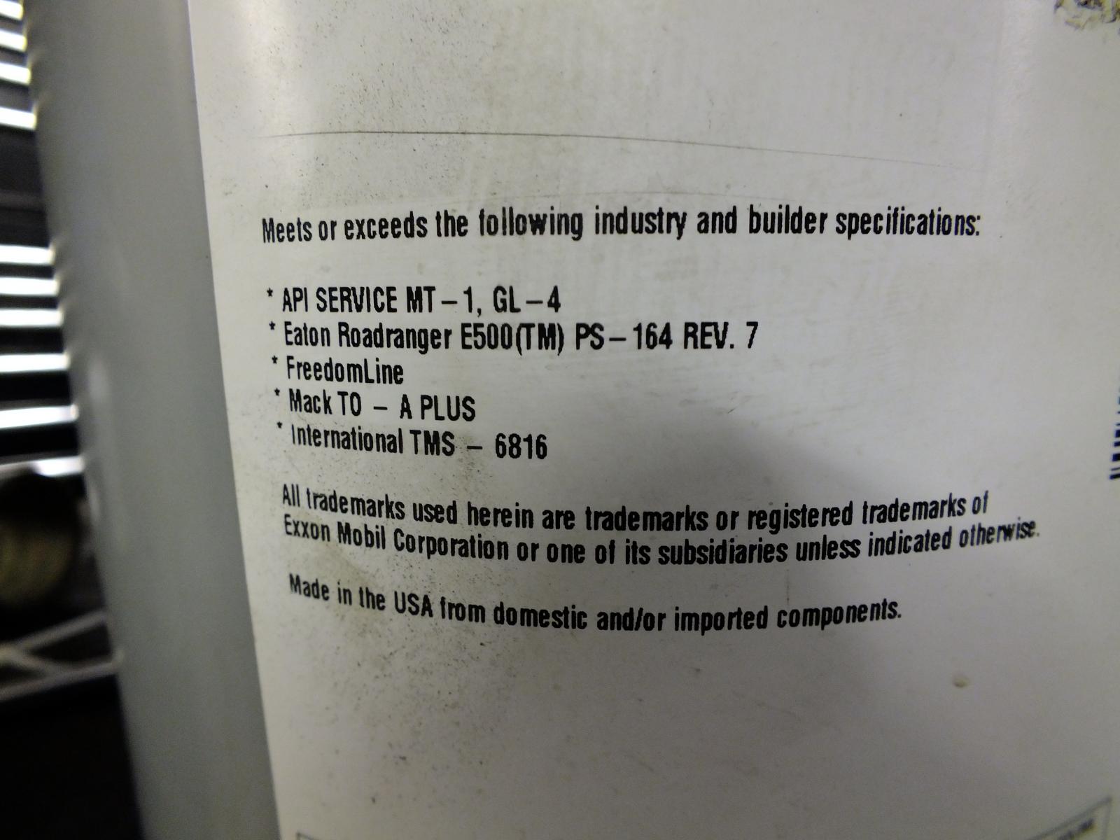

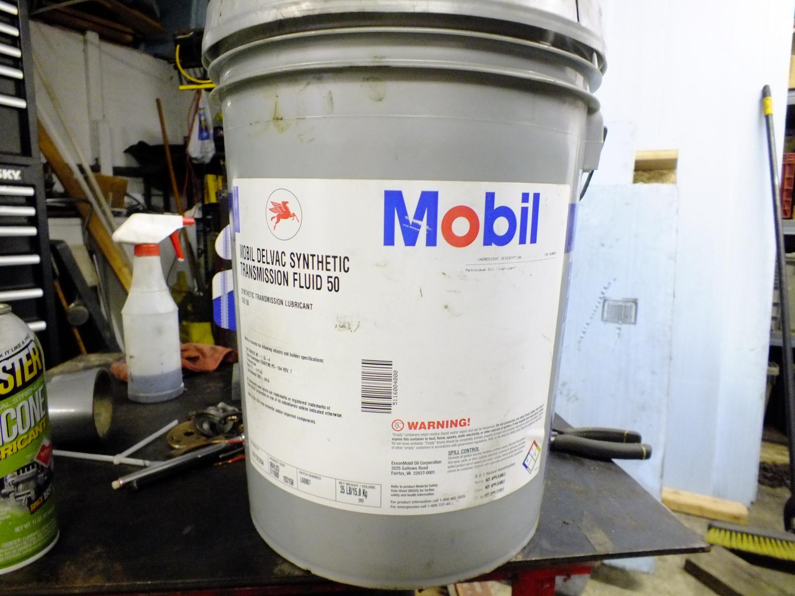

Mobil 50 SAE GL-4 Synthetic Transmission fluid. Same stuff used in Eaton Fuller 10 speed transmissions. I'm at 110k miles and still going... No shift issues even with winter temperatures down to near -30*F and shift like butter. Be aware 50 weight oil is actually 90 weight Gear Lube much thicker. Like 75w-85 for the NV4500 is like 10w-30 engine oil.

Have to remember @Mopar1973Man is running a NV4500, little different animal. That being said what he's using works great for him. Just personally I'll pay 4 or 5 bucks a quart more for the fluid that was made for my trans. If $20 makes or breaks me on a trans oil change every 100k then I probably shouldn't own a Cummins.
