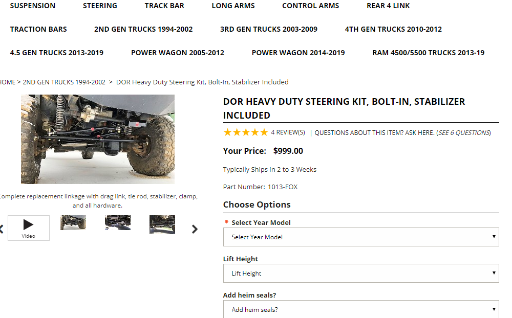

@Kane4sythe have you went to the DOR site yet? This is what you want right here. Comes with all new hardware and steering components.
Next you will need
Then this
Obviously check your ball joints, control arms etc.....
Go to the site and and make a wish list, look at what they have.
I dont work for these guys, or get anything from them I just have experience with there product, customer support! And they are both great! Their stuff is the BEST around...
Wow, thank you for the help! So now is this stuff only needed if I’m planning on off-roading? Because honestly I never plan on doing any sort of off-roading. Is the same some needed if I just want a truck that can comfortably handle big wheels and tires? I’d rather go too much than not enough. My plans are not to go cheap with this truck so if those are the parts you think are necessary, I’m completely fine with that.

You'll want this stuff irregardless if your offloading
Sounds good! Time to start saving.

Usually, heim joints don't last as long in a steering application because of the dirt that can get in them.  With the range of articulation they have, any dirt that gets in there really sands down the metal quickly.  They may offer dust seals, but those tend to break down quickly as well.  And, while easy to replace, heims of that size are expensive!
Honestly, I'd recommend the 4th gen T style steering.  Cheaper, more easily sourced, and reliable.

Ive never personally dealt with Danny at dodge offroad but ive heard nothing but horror stories. You can make a solid front end for alot less $ than all that stuff anyway and its not needed. Mike's stock parts lasted 300k plus and he is on back road and offroading getting wood for the winter. Like mentioned, if your tie rods are shot, do the 4th gen steering or the 98-99HD steering and youll be fine. You do not need to touch your rear differential, leave that to someone that sets gears up.
Still more money. How about the rear? Dont get me wrong, that look is not for me. But it is not my truck and I am a firm beleiver in to each his own. Just trying to figure how you can raise your truck like that and have it structurally sound for much less than 2 grand in parts. Then you got to buy the wheels and tires.
Okay, so if I could afford it though would buying the steering set up from dodge Offroad be as good of a choice as the t steering?

Spending the extra money on the DOR steering is not worth it to me.  It might be to you.  I do have a DOR track bar.  It's been a solid choice, and I haven't had to mess with it in the 2.5 years its been in service.  That part is worth the wait to me.
