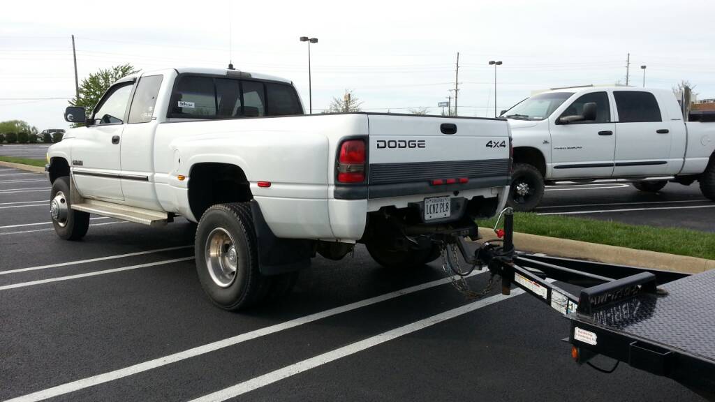

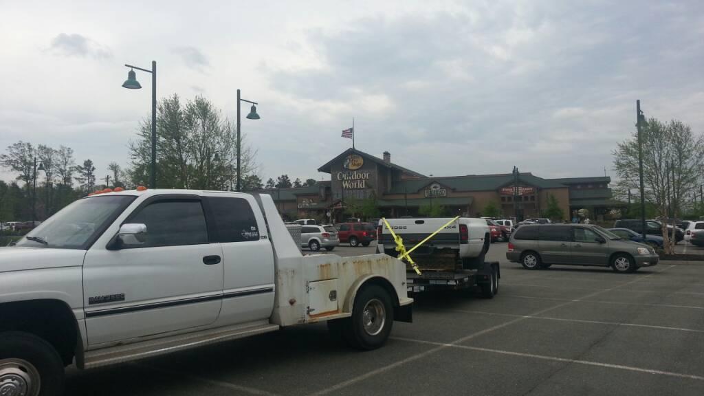

[ATTACH]5393[/ATTACH] [ATTACH]5394[/ATTACH] [ATTACH]5395[/ATTACH] Now I just need to get taillight harnesses and get the bumper on. JD7210 bucket scales showed 1360lbs wow! Sent from my SPH-L710 using Tapatalk 2
Did you weigh the oem bed by chance? everytime I ever moved one I swore they were heavy as hell but in reality theyre just more awkward than anything. Im guessing not much more than a couple hundred pounds. Truck looks great
I think he said 600 something.. but it also had the bumper and reese hitch laying in the bed, along with a wood pallet.

Ok, so anyway, the bed I had was a great bed for it's purpose. If I towed for a living, then it would've been perfect, if that's all I did. But, I needed a truck bed for hauling things without a trailer, or having to tie/strap stuff down every time.The rust looked a helluva lot worse than it was. And that bed was freaking heavy.. The clearance between the overloads and the stops has increased by 2.25" with this bed on, versus the old bed. It was insanely heavy. The Western Hauler beds are overly built. The floor section has cross-beams of 2x2x.25 wall box tubing every 8 inches, from front to back.
