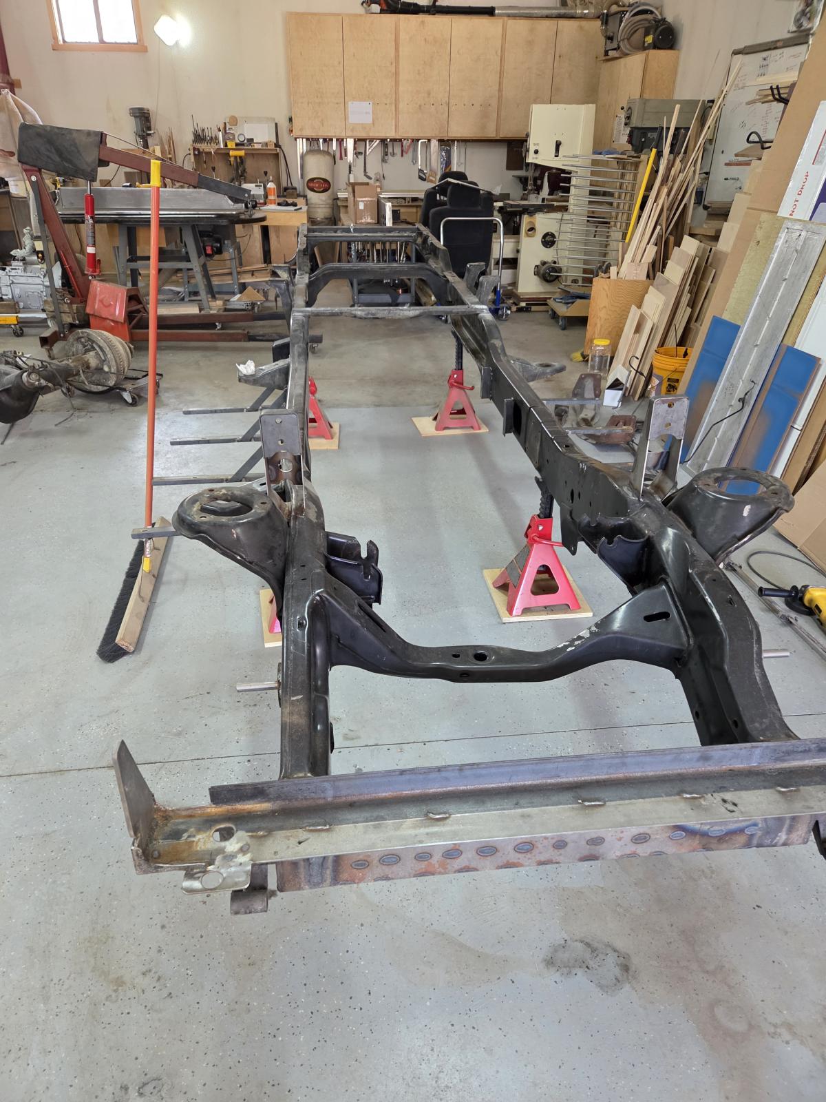

Well, the door "sill" beam that runs across the side of the cab is a 2 x 4 x 3/16 piece of tubular steel, and the rear cross tie is 2 x 2 x 1/4 tubular steel.  The cab mounts are welded thoroughly to these members....if I get broadsided I think I'll be in pretty good shape except for NO crumple zones....PLUS I plan on schedule 40 pipes to be bent and made as the running board main frame.
not fer sale!   LOL.  But I hope to do some serious road tripping before the morons make fuel unavailable and a loop thru the PNW on the way to my buddies in CA is on the list.
