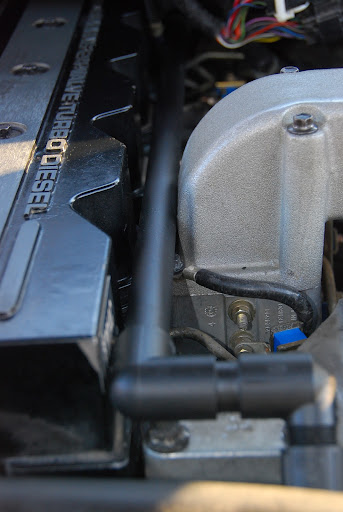

So does the oil actually travel the wole lenght of that piping to get out? Thought maybe it just may build up in the elbows in the piece going up from the breather :shrug:
No... Only thr oil vapor and crankcase blowby gasses travel the pipe. This corrects both TSBs for oils...

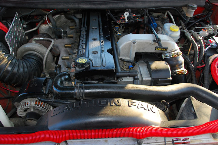

Here's mine;
Posted Image
Posted Image

My radiator shroud
Posted Image
