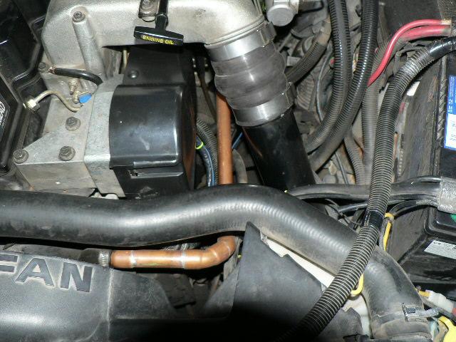

post-213-138698167302_thumb.jpg the reason i guess i wont b doing the ccv upgrade ....unless i am not seeing things right there is no place to attach a line :shrug::shrug:
You already had it done look back on the tappet cover and towards the rear of the engine you'll see you down pipe...
