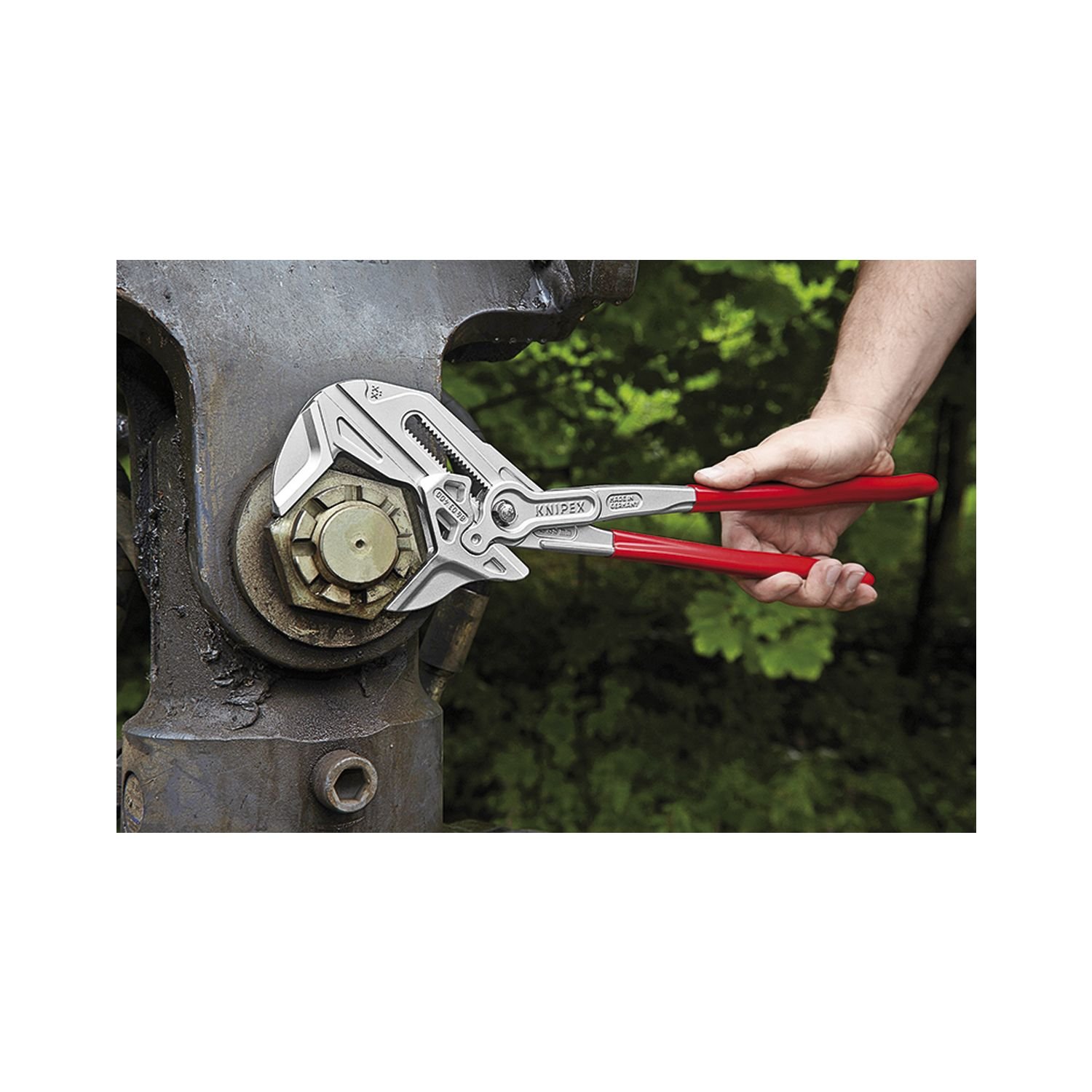

Vise grips are more important than duct tape.  Especially the mini size.
These are the most important tool I own.
The Jaws stay parallel %100 of the time and clamping force is HUGE.  I can do more work on the truck with just those than any other tool.  If they only had a locking feature, BRB searching the net for locking Knipex plyers.............
I was looking for locking plyers.....but I found these instead.....
http://www.amazon.com/Knipex-86-03-400-16_inch-Pliers-Wrench/dp/B00FBPPKPO
Must have
