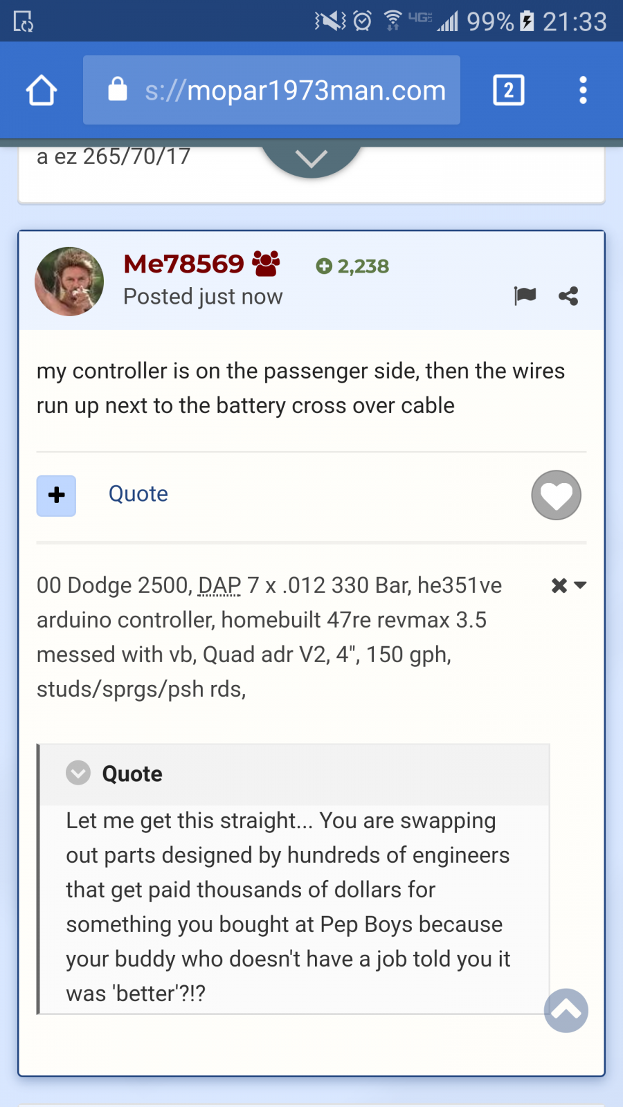

@Me78569 why do I always see a quote at the bottom of your post, is it something you did or is my phone tweaking out.
11 hours ago, Dieselfuture said:
:lmao:good I thought I was going nuts.
Correction...
:lmao:good I thought Me78569 was going nuts.
a long long time ago in a galaxy far far away Me78569 was still sane.
We know you leave in your own world, I do too at times,  but it's okay they know us there.
