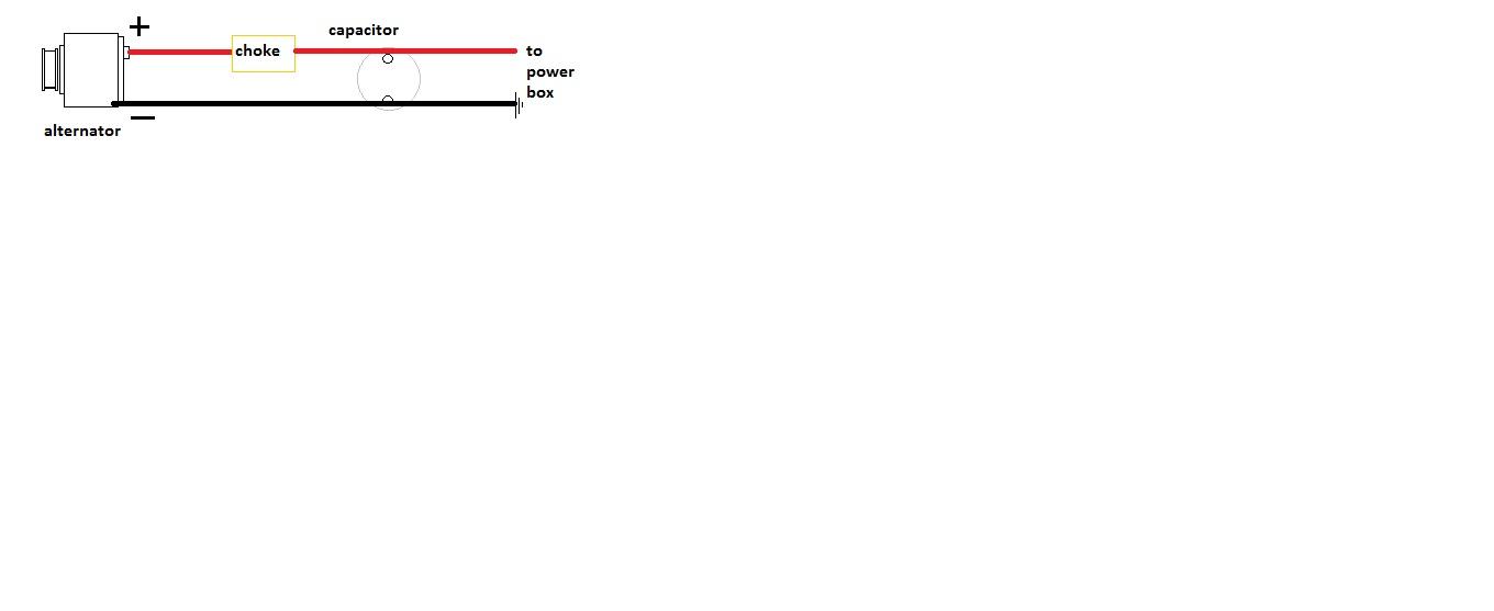

so here is what ive got guys . after some series web sahreddin and a lot of reading there are three modern and accepted ways to defeat ac ripple on dc output
number one involves a resister and a capacitor which is neither energy efficient or economical if even physically possible for this
number two by far a more reasonable and doable approach is the age old choke a wire wrapped around a magnetic core that removes ac from the circuit now obviously your gona lose alittle with this but the key word is a little not a lot some where in the neighborhood of 2 to 3% in voltage drop and the samr for amperage output which is acceptable considering the benefits.
number three is the good ole capacitor which removes ac by simpoly stiffening the power supply a capacitor at base works like a storage battery.... a very fast storage battery. when voltage across the capacitors + terminal is higher than the rated discharge of the capacitor itself the capacitor either takes on dc voltage , ie charge state or it sits idle doing absolutely nothing.
now once say you hit the key and the toasters light off or once voltage traveling across the + terminal of the capacitor is lower than the rated discharge of the capacitor in this case 12 volts dc then the capacitor discharges suppling voltage to make up for the sudden dip in voltage on the system. so now what used to really harm the alternator and batterys has all the juice it needs to do its job without ever dropping below a set threshold which is exactly what our trucks need.
s an after thought because of this constant voltage supply reservoir ac ripple is numerically reduced because a capacitor also limits or stops the flow of ac while permit dc to flow freely so its two problems or birds with one stone right
something for nothing.... whats the down side
first and foremost capacitors are dangerous..... let me put that another way.......if not properly handled they can and will kill you period  dead......... let that sink in...........................
these liul pups discharge theyre whole reservoir to ground when possible ie touch it with your pinky while standing on terra firma... little caps will just sting big capacitors like the 4 to 8 farad designs that will be necessary to do the job on our trucks will kill you. which is probably why current oem engineers don't employ them to much lawsuit risk. now with that sai capacitors can be your bestest buddy ever .
1 rock solid ac ripple less straight dc power all day every day with no delay
2 brighter lights
3 no bouncycomputer stuff
4 wont buy you beer well cant have it all
what you need to know
any time you are going to service the dc systm you need to discharge the capacitorsfirst
on my project I'm building I will include a discharge or service switch that will safely and completely discharge the caps allowing service of the system
now number 4 , and this is where the plotthickens, is the combination of methods two and threein aseries parallel arrangement tbc..........gotta run a kid home
and were back......
 as I was previously discoursing the combination of the two components if calculateded correctly should yield as close to a 0 ac ripple as is possible. which is why I'm considering both units now it is quite possible that the large 4 to 8 farad capacitor alone will do the job and it is the first device I'm going to play with but there is possibility even if the cap doesn't pull it all
the crappy paint picture above shows a basic layoput of the components in  thir respecticve locations
they work as follows
the alternator generates current 13.6vdc to be exact it flows out over the red cable into the choke coil which is available in amperages upto 600 amps @ 12vdc so theres lots of choices . the choke tames ac ripple via magnetic field generation as the voltage moves through the coil there is a slight fee in both voltage and current but its negligible like 2 to 3%which most of you lose more than that with your nasty corroded battery cables so no big deal. next with a greatly reduced ac ripple current thje voltage moves on to the capacitor which again stops ac current while passing on dc. as a bonus the capacitor acts like a tank for current how much of a reservoir is deteremined by the farad rating or capacitance ( hence the term capacitor) the benefits which I described earlier are 10 fold in terms of dc system health and performance.
