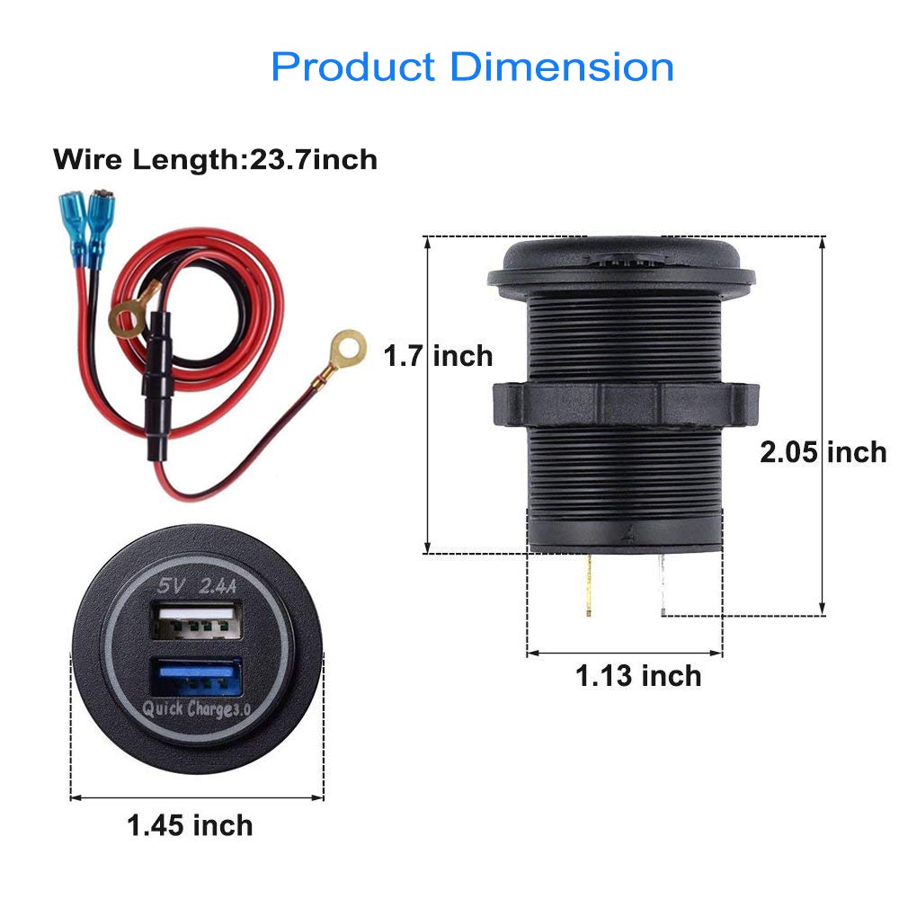

Here you go. The ID of the trim ring is 7/8" and the ID of the hole in dash is 1 1/16". There is room to enlarge hole.20181013_085537.jpg.d57e43eaabed55f371173ac608c82d8e.jpg20181013_085620.jpg.e86a1b292d02342e46a607cde6b410ea.jpg
Please? I'll FAX you a cold beer...
Image result for cold beer pictures
That does look tasty!!
Basically, the USB body is 1 1/8" (1.13"). So if your measuring 1 1/16" (1.0625") that is only another 1/16 of inch to go...
The OD of the trim is 1 3/8". The way it fits the contour of the dash would make the power point face trim a little to big but if you shimmed it out a little you would gain the space you need to make it fit. Not sure about getting the nut on the back though, pretty tight back there. It would be worth a try. I have something similar plugged into the lower power point but its just a cheapie and works ok.

I like that one more. Two 3-amp charger sockets that just perfect. Even its the same 1.13" size barrel. I was just looking at my 1996 if I could stuff one of these USB chargers in there too.
