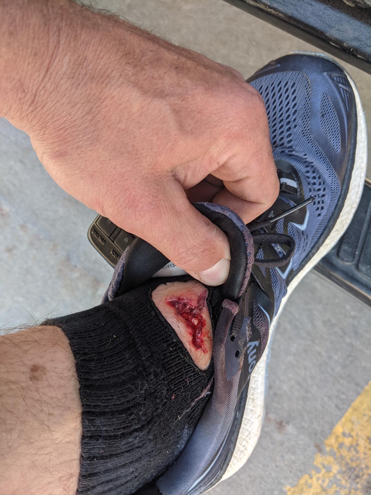

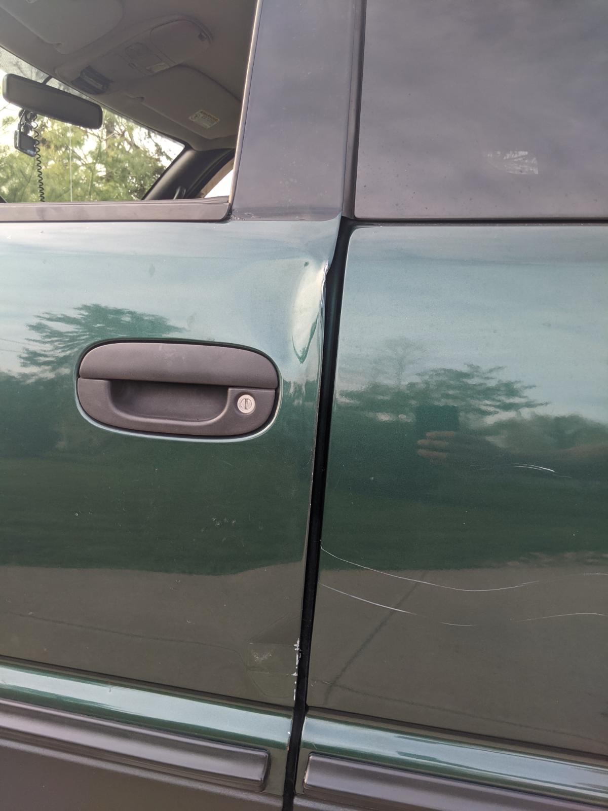

Took the boat out today with kids, got to the ramp backed in set the parking brake started to unload the boat, then all the sudden my truck started rolling into the lake. I ran up jumped inside but my foot got caught between the corner of the door and handrail of the boat dock. I should have known better than trusting the parking brake, usually I put it in the gear and shut it off, the ramp was not very steep and it held fine for good while then all the sudden it just started rolling. I was parked a little close to the dock as I usually unload the boat and tie it off. Everything happens so fast I didn't even realize it till I was walking back to the boat and my shoe was wet. My kids said I had blood on my shoe, look down and there's a nice chunk hanging over. So much for having fun today, loaded the boat back up and headed to emergency room, where I sat for a half hour waiting to get stitched up lol. Good thing I was only a half hour away from the hospital. 10 stitches later now I'm drinking beer. Going to attempt this again tomorrow. Apologized to kids for not making it happen today. Now I need to fix the door as it got jammed between the handrail and stopped the truck from going into the lake. Guess I learned a few things, don't trust my parking brake and don't get in a hurry. PXL_20210430_212122764.jpg.916d20855593f495ea181406109a6113.jpg

Glad everything turned out, for the most part, OK.  It probably could of turned out worse...
Don't worry about the foot, just remember, chicks dig scars! :thumbup2:
Dang! I am so glad you are okay. I was afraid you were going to say that you got caught inside the truck and your truck went in the lake. I think that door did you a good deed.
Yeah I got lucky for the most part, more upset that it ruined the day then anything. Could of been much worse I suppose. Now just need to make sure I keep it clean.

Exactly what was wrong is the cable going to passenger side wheel was rusty and sticking. So when I set the parking brake driver's side was on fully and passenger side was only halfway on, when I started to rock the boat off the trailer to get it the in the water, passenger side cable tighten up more because there was tension on it but that also made the driver side looser. So basically the force from the main cable split the difference between the two and truck started rolling in to the lake not fast luckily but fast enough you didn't really have much time to think about what to do.
I put all new cables on except driver side rear it was still in real good shape and I've changed it some years back. Got the cables from RockAuto I went with rybestos made in China quality seems ok. Then what I did is put one end of a cable in the vacuum and also put a rag so vacuum creates more suction, then I kept putting oil on the other end and moving the cable back and forth until I got oil coming out of the other end that went into the vacuum. Maybe it'll make them last longer, maybe not but I tried. Got everything adjusted works perfect now.

Make sure the two rear cables move together. What I do is loosen the slack adjuster on the side of the frame. Then set both rear shoe adjustment where it barely drags. Then set the slack again so I pulls enough to hold evenly.
That's how I did it, first I adjusted the drag on shoes, then I attached the cables and adjusted the slack on that.
