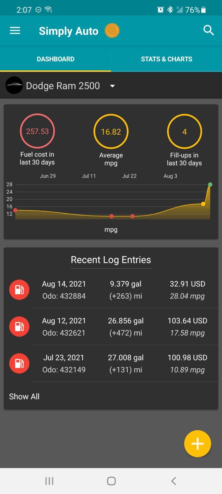

With the Quadzilla you can tune out a bunch of the smoke between the timing and fuel maps. As I've posted I'm maxed out at 28 MPG. I'm somewhere around 500 HP to the rear tires. Personally, I don't need twins for my setup even with last years trip to Arizona hauling my RV. Never had a EGTs issue at all. But again, I've got proper final ratio to the ground of 3.69:1 with the 245's tires. No EGT's issues here. If you lower ratio than 3.55 you will have EGT's issues.
The other trick... You need to have a stock fuel zone. Like I'm running just 100% fuel on the CANBus table from 5 PSI to 15 PSI. Just stock power from the ECM and the 150 HP injectors. This keeps the EGT's down while flat driving. Now put it against a hill it will pull up into the 15 to 30 PSI part of the table and start to ramp up.  Now if I was going all out and had wire tap on too then the wire tap is set to start at 15 PSI and ramp up with the CANBus together. Way better power and better Efficiency (MPG).

Once flipped over to the Quadzilla problem gone being I can adjust timing to meet the engine needs. This also gave me the record on the site for efficiency of 28.04 MPG. Re-inventing the wheel??? Nope... About making the wheel more round which Quadzilla does and not squared like Edge products does... The other fact is I cvan can place in a nice flat stock fuel area where there is neutral fuel... Again another thing Edge can't do...
