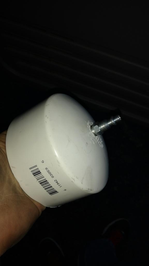

Made a tester, and did a boost leak test. Happy to say everything is TIGHT! Only place air was coming out was the boost elbow :thumbup2:

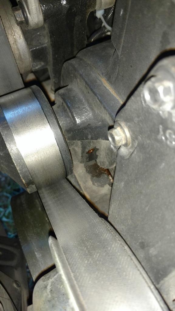

Then did some more looking around and found this. 12K miles :mad: This was a Napa, so hopefully the next one will last longer.
Edited by TFaoro
8 hours ago, notlimah said:
What's the leak?
Water pump. It's coming out of the weep hole, meaning the pump is shot :cry:
Edited by TFaoro
That's the "feature" they add on to ensure you change your coolant each year.   Nice of them.
I guess this is the "early" change version! I think I put it in either at the end of July or beginning of August
only in coolant and gas running back and forth to the store.
I think I have gone through 3 water pumps so far.
What brand?
The pricey orielly brand.  Lifetime warranty, which really means a lifetime of replacing it.
