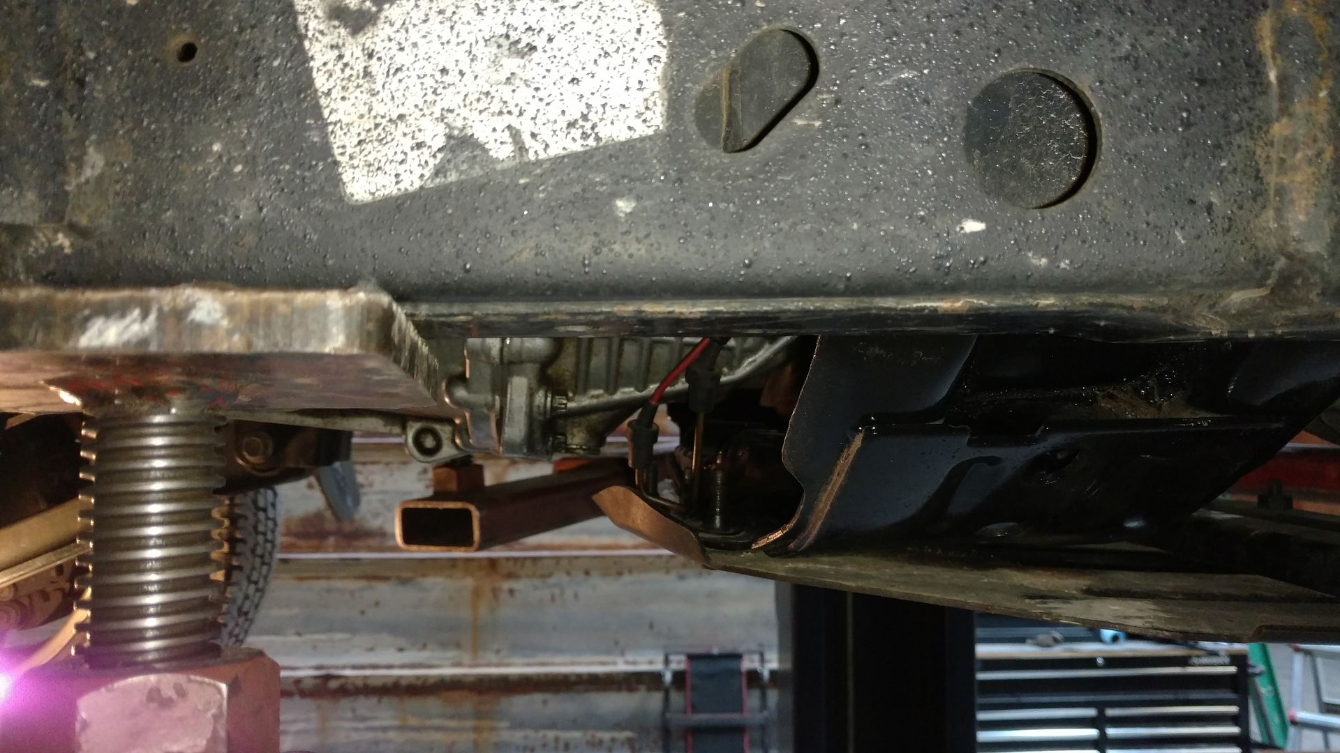

Making some progress. I'm in the process of building the crossmember and will update later IMG_20160429_205232567.jpg

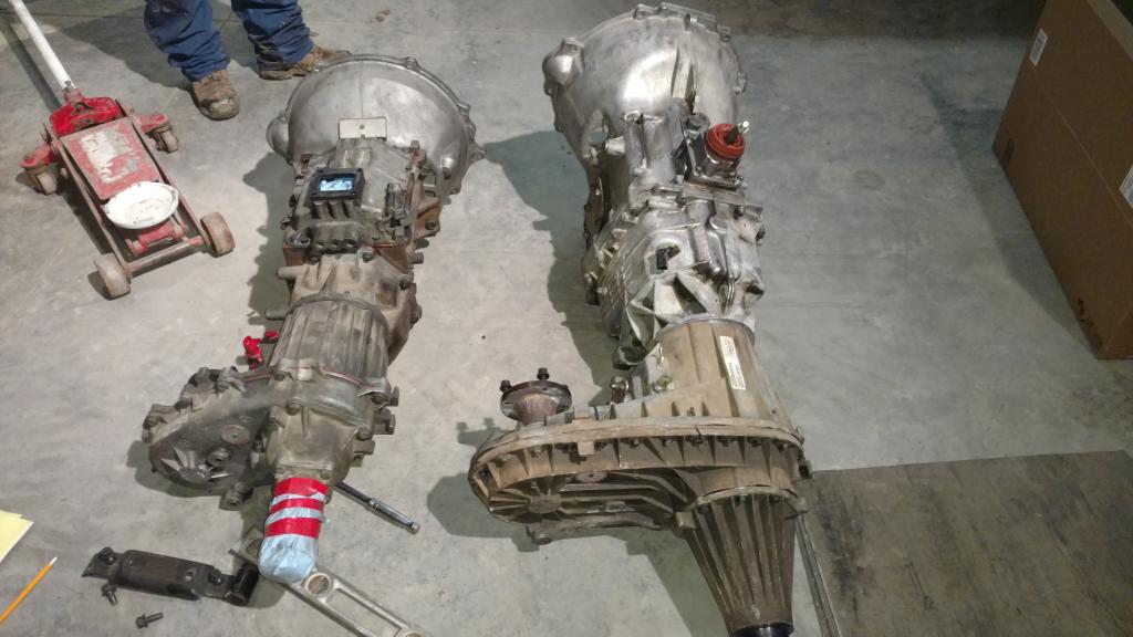

Now, the build. The first thing we did was stuff the new south bend clutch in. It's the "same" as the clutch I had before, just made for the g56. We then decided to take a few measurements of the transmission and transfer cases. The shifter location on the g56 is almost identical to the nv4500, so there was no need to cut the floor :hyper:. We then jacked up the front of the motor and attempted to stab the transmission... No go. The small loop on the top of the trans (You can see it at the front of the picture I already posted) kept hitting the pinch weld. So I cut it off. It then went in nice and easy, like it should. With it bolted up and supported we took the truck to the lift and took it to the top.
From there we started on the transfer case. The np241 has a "block" of vacuum lines running into it to actuate the CAD. Turns out the 4x4 light on the nv271 works the exact same, so we were able to screw that in. The shift lever is also identical, so we bolted that up. We then stuck the Tcase in to check fitment.
It's close to the frame, but it doesn't hit!.
Then onto support the aluminum beast. We were able to use the stock support and bolt it directly to the g56 rather than using the adapter the nv4500 uses.
Here you can see we cut the center section out because it had to drop around 3/4 of an inch. We also had to cut part of the left side to make clearance for the driveshaft.
From there we used 1/4in plate drop the center section. We also made a 45 degree cuts to make strength for the new plate. Where it flattens out we used a rosebud to heat it up and beat it flat. It was the same process to plate the section cut out for the driveshaft. Here you can see some beautiful beads laid down by my father. I believe I'm a good welder, but he is an excellent welder.
From there we bolted everything up tight. The next step was mounting the skid plate. Because of the monster transfer case it had to drop an inch and the nut that mounted the plate had to be removed. I didn't get any good pictured, but I also ground the spacer on the bottom and welded a nut on to hold the plate.
It sits lower, but I feel having a skid plate is a necessity with what I use the truck for.
