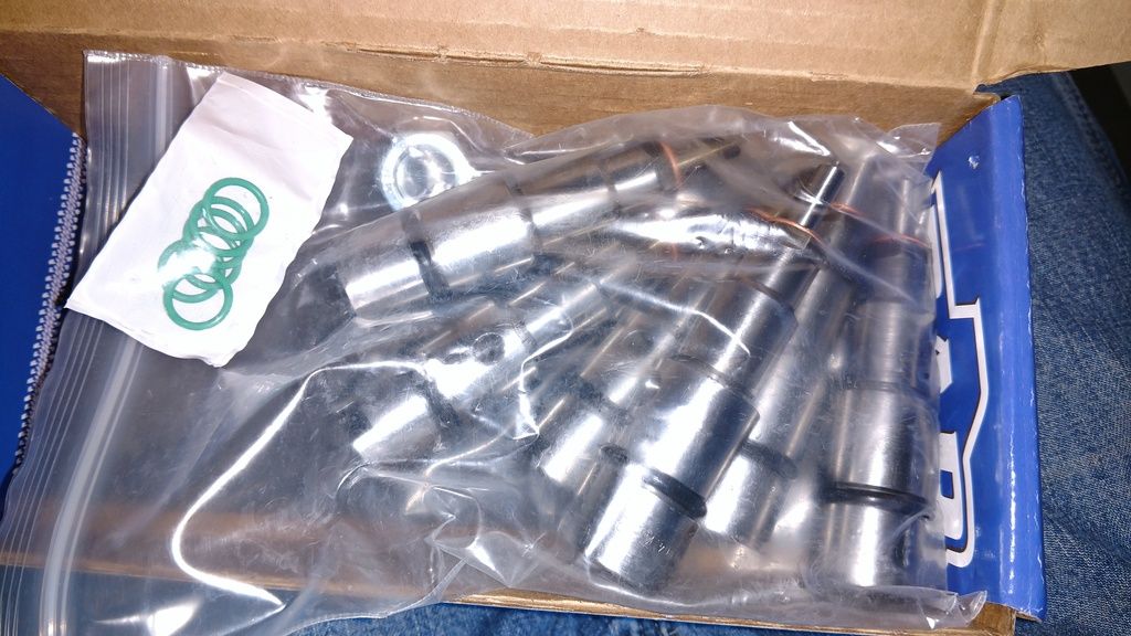

Injectors from DAP showed up. There are 3 new nozzles. Pretty disappointed they didn't put caps over the tips though.

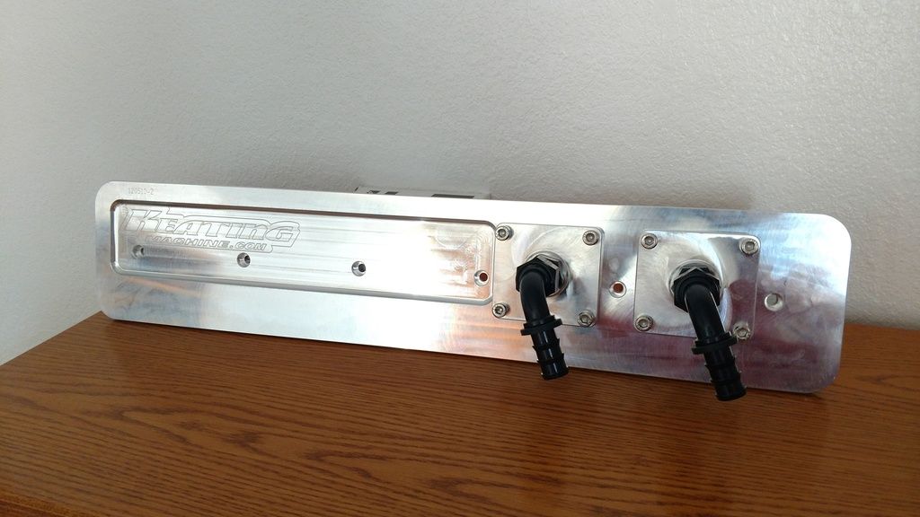

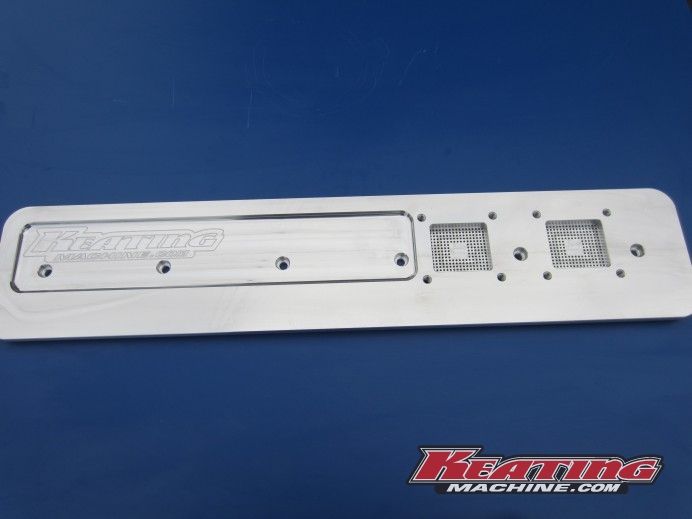

Baffled tappet cover with two -16 AN fittings (3/4in)

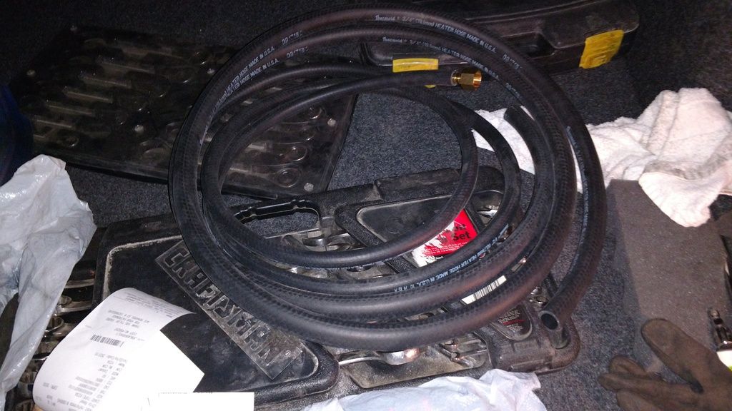

10ft of 3/4 hose and 8 ft of 1/2 hose

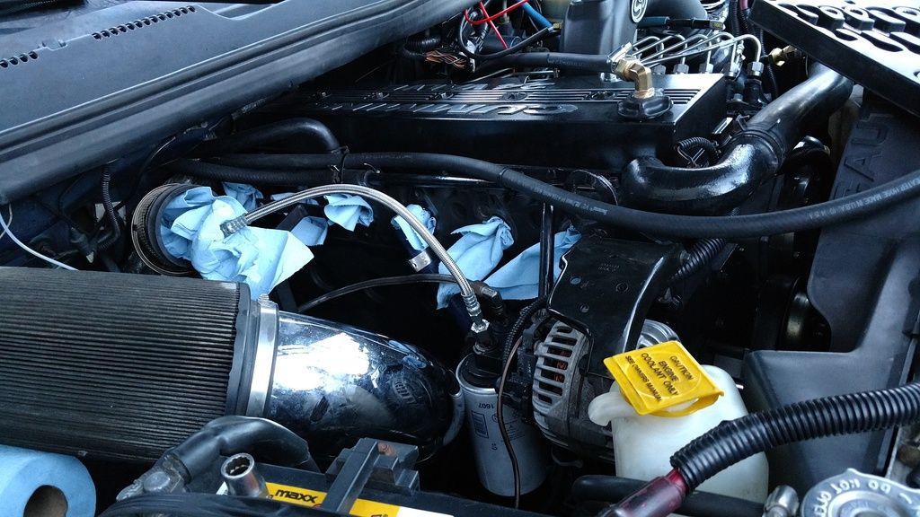

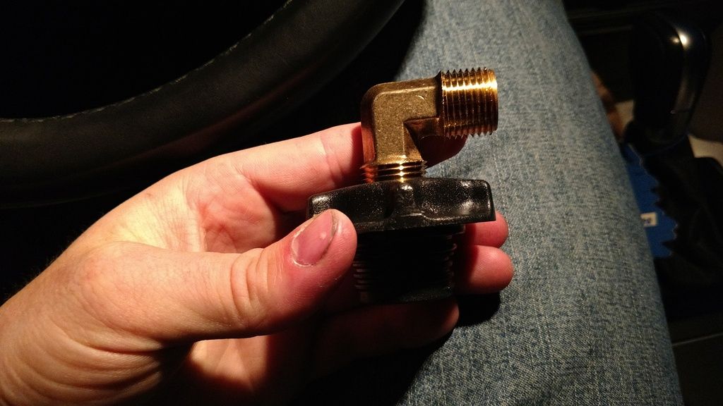

Stant oil cap drilled and tapped for a 1/2npt fitting. I'll run this to make sure the engine will be okay with these 3 breathers. If all is good, I'll probably pull the valve cover and have a 3/4in fitting welded in.
Now finding time to get home and fix the friggen thing. I don't want to pull the effin pump for the 3rd time in 10 miles!!!!!!

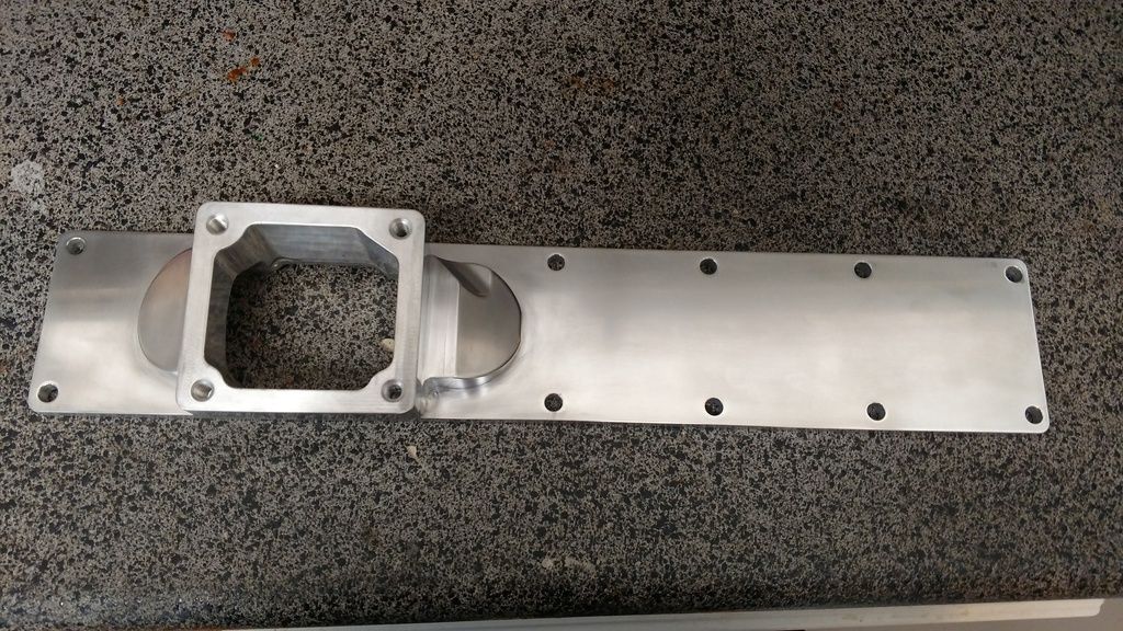

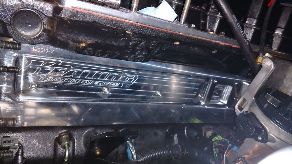

First, these 5 things showed up. Tappet cover, two -12 orb to -12 AN male, and two -12AN to -12 pushloc. $400 bucks there....

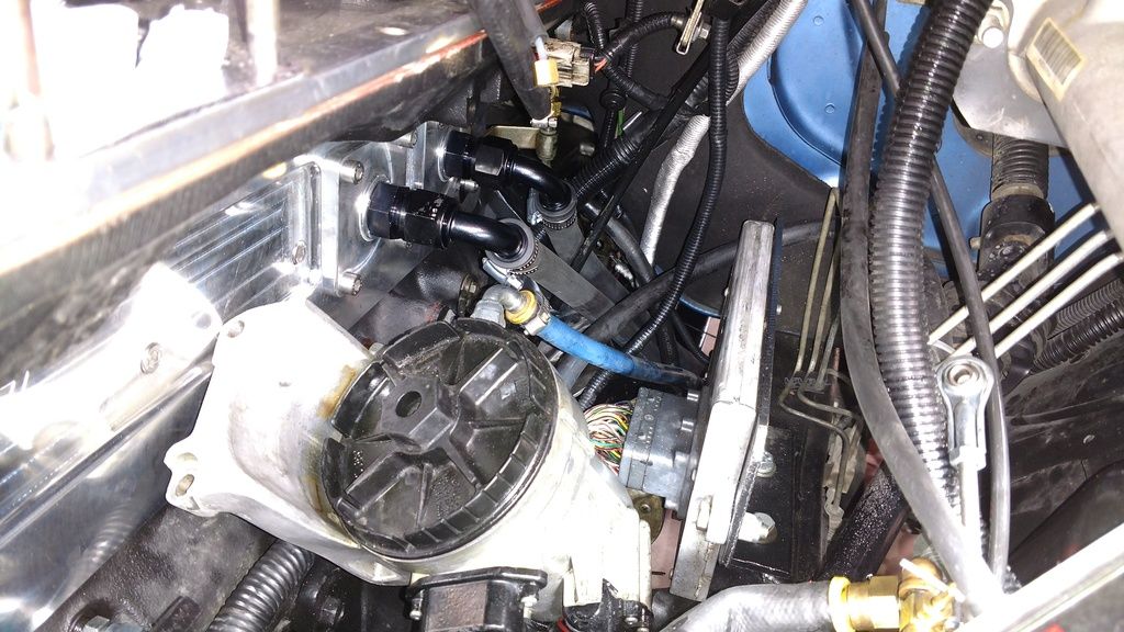

I pulled the pump and all of the other junk out of the way. The 12V tappet cover had blown out about 6 inches along the bottom. I didn't know that much oil ran down by there....
This thing is sexy. Good thing I made an ECM mount, because there isn't any way to mount it with this cover. There also isn't a mount for the fuel line at the rear of the head / pump, so I used a piece of flat strap and bolted it to one of the breather pieces and to the fuel line holder.
You can kinda see the mount at the back of this picture.
All buttoned up.

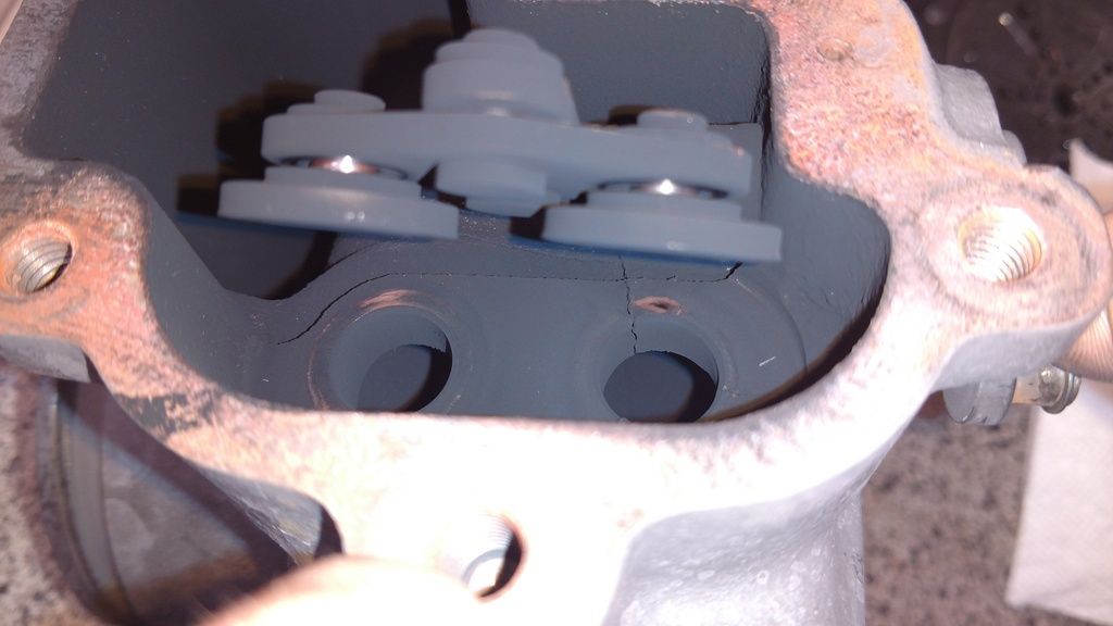

Pulled the spacer off the secondary to put it on my 14cm housing. This one wasn't sealing from the crack. I was hoping to sell it but O well. I have a new paperweight!
Once I get the 14cm housing painted I'll slap it back together.

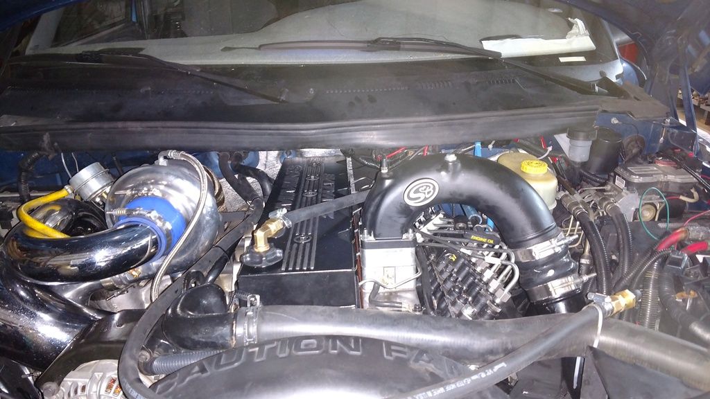

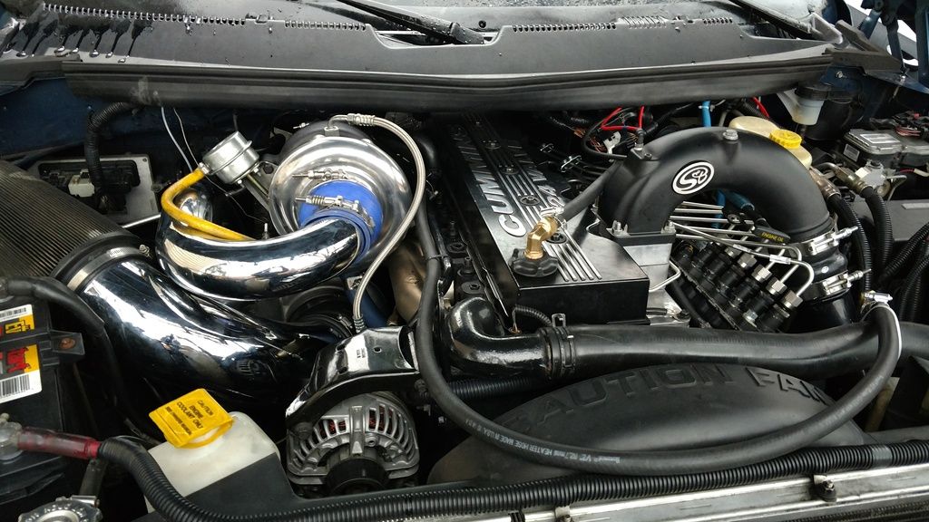

Got the compounds back together and the manifold on.
IMG_20170420_185639538_BURST000_COVER_TO
The beautiful golden nugget is hidden! I did get the rest of the stainless bolts in as well.
The 14cm housing spools nearly the same as the 12. Would it be the same in a single situation? Idk. Probably not.
I do notice the biggest difference from a stop. If I gun it from a stop. It spools noticeably slower. Not a big deal though because it's a manual.
From 1500rpm in 3rd and up the change is pretty much negligible.
Top end is definitely better! I got on it a couple times hard and it was in the low 60s for boost but EGTs climbed much slower and topped out around 1500ish.

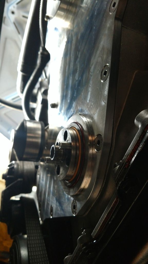

Fixed the front cover from leaking. Dum dum move.
IMG_20170420_122127671_HDR_zpsfiycnp6f.j
Also pulled the damper and fan clutch to tighten the front cover bolts. Most of them were about finger tight. My assumption is the gasket squished down from the heat cycles.
