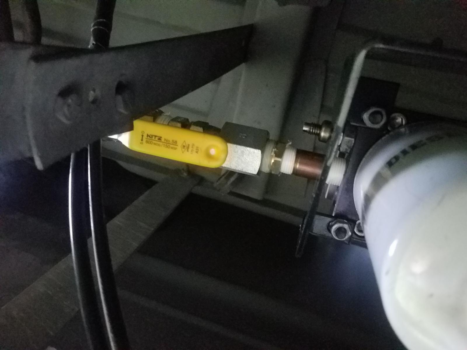

Has anyone done what I was reading about recently where you add a SUMP.. definitely beans single hole single o-ring, the fass one has like 20 screw holes which seems like a leak waiting to happen... then a AirDog or FASS up to a ball valve and a T feeding into the stock canister filter/heater?
I'm thinking that is the route I want to try so my stock system is still there, just turned off at the ball valve and the harness disconnected because its connected to the better pump, and if anything should ever happen I could at least move the harness back to the stock pump and flip the 2 valves to the opposite positions and be back up and running.. Thoughts?
2 hours ago, trreed said:
Where on the truck are you talking about?  If it's on the basket, the return is the smaller line that is closer to the cab.
I found it! It was right there beside the fuel inlet I just didn’t realize that it was the return line. I assume that you just ditch both inlet and return lines?
