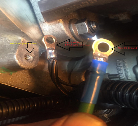

OK, I thought I had this, but I have only to connections that go to my alternator (see pic) and the other end of this alternator lead goes into the large loom & then breaks out by the VP44 and up to the negative side of the PDC.      I also have a power lead going from the drivers side battery to the PDC.
I also have a ground going from the drivers battery to the fender & one from the drivers side to the frame.  (I had already changed out the cables with a kit several months back)
Never had a problem except for T/C lock unlock started happening..unhooked the power from the PDC 140 amp to test.......it eliminated the T/C problem.......changed the alternator out, put on a additional ground from the PCM to passenger battery.  Worked for a while...and now I am opened up the loom seperated out the grounds & I am not sure about what to do with the PDC negative. I would think big awg ground, but why isn't my truck fried?   again no other problems or codes..Ok I figured it out.  It looks like a ground cable, but it is NOT..If I had kept reading which I did..I did run a extra ground battery to battery.

I figured it out
