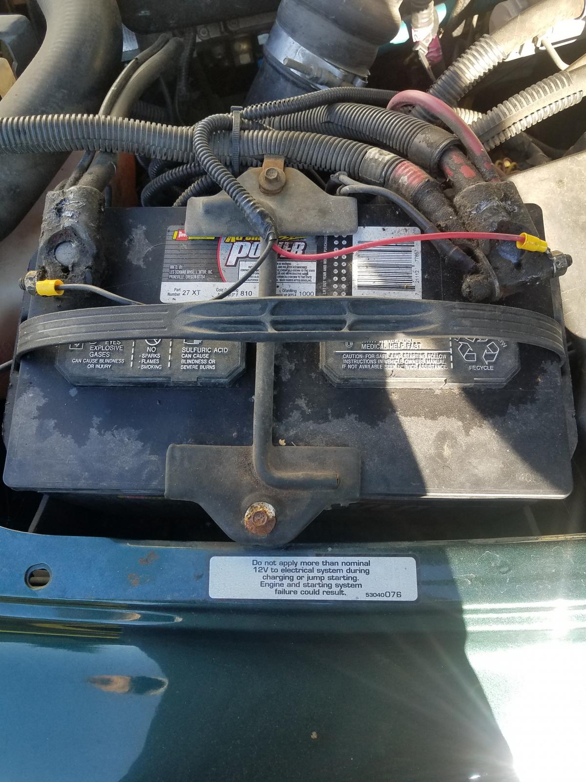

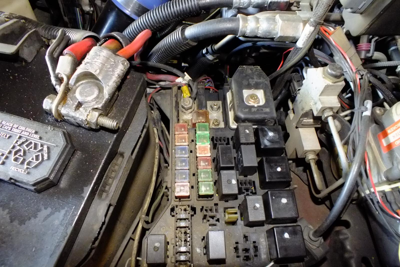

Yeah there is nothing on the alternator charge stud because the W-T ground wire mod has been done. This can become a 140A protected stud now too.
I agree with pos to pdc lug.  Where is your neg side hooked to?
Mind not looking to good, clean wise.
It should look nice and clean...
Until I did wt's ground mod my batterys alway were a tad moist on top as in the pics. Since then they have remained dry as a bone. And the only thing on my terminals is a touch of rust on the bolt heads.
