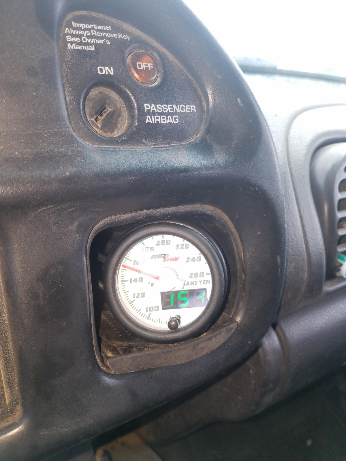

Heres towing 9k on freeway at 70mph bought 1900 rpm. Temp 121
Then this is sitting at a light in boise not sure a added fan would do much since fluid isnt moving like when driving
