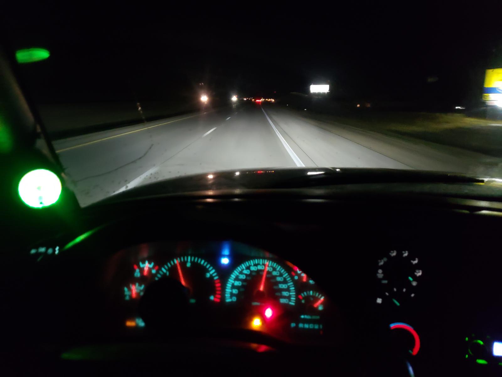

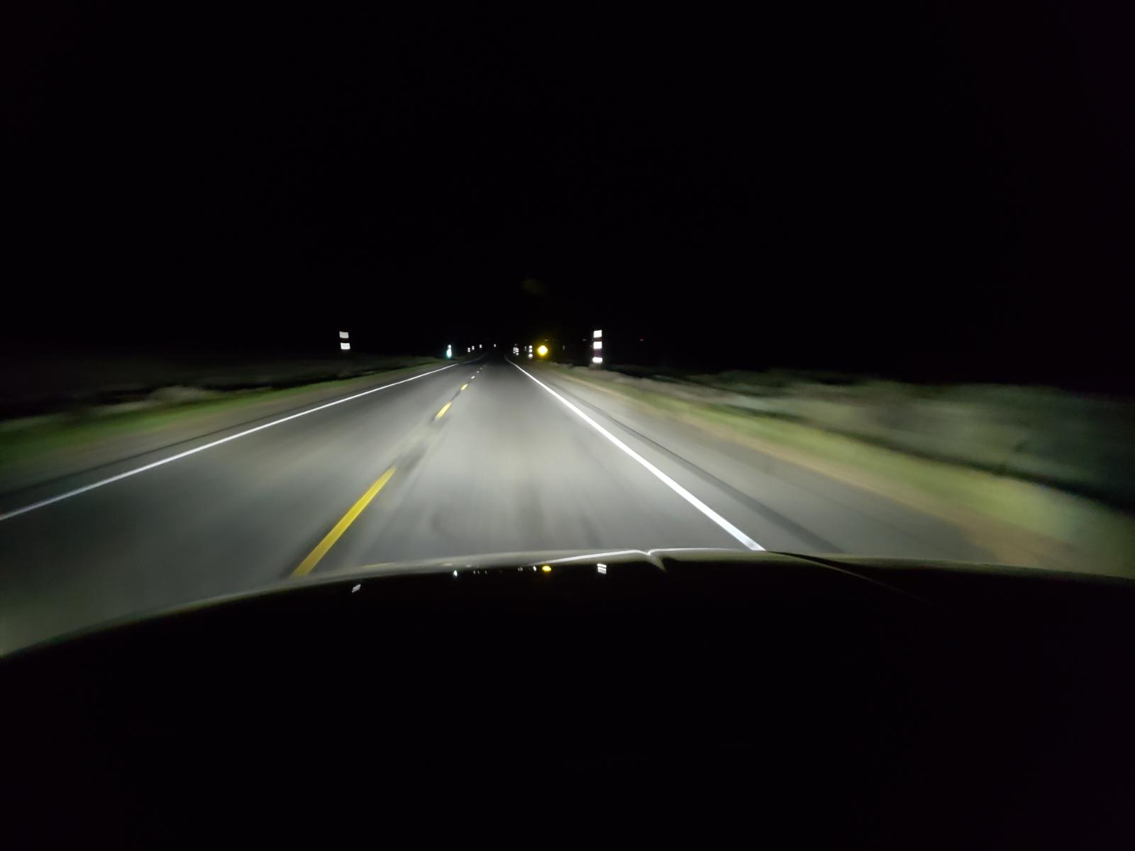

As long as I remember to drop my hi beam that would be the only way I could put light in your cab. On low beams there is no possible way to put any light in your cab or eyes. Even my PIAA 530 LED driving light have a good cutoff line too. Just not possible to blind anyone.
Now with the 1996 Dodge with LEDs bulbs and the clear lens headlights those scatter so bad its possible to catch you in the cab slightly. Again the quality for the 1996 is because of the crude optical and reflector. Hence the scatter.
Now Morimoto HIDs are based on the lens and optics are top notch. Now when the lo beam shutter rises from the bottom the cutoff line is made and the pattern is flipped in the lens so the top side is shadow masked. The cutoff line is is also stepped. The step in the cutoff land right on the center line of the highway for me both beam layout perfect on the highway and the patterns layout perfect not out of place left to right. Now the pattern in front of me is slightly enhanced placing more light on my lane. Then the on coming lane is stepped a bit higher so the cutoff is shorter not to blind on coming traffic. Now the cutoff is very visible and the only adjustment I got is vertically, no horizontal.
Never had any law enforcement say anything about my Morimoto's yet. Even when I was pulled over for not having my headlight on in Nevada (headlight safety area). He even check my lights make sure they lit up and not said anything. This was during my trip to Arizona hauling the RV back in June IIRC. No ticket given just reminder and he left... After the next vehicle without headlights on.

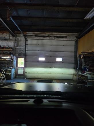

Mike, no way I am saying you should take them out law or no law. I have faith that you are blinding oncoming traffic. Thats the part that pisses me off is the folks that only care about what they can see and all others be damned. Pretty darned selfish. What does one do when the person you have blinded slams into you?
Just consider a 2021 vehicle the comes OEM with HIDs lights... all it takes is a minor bumper push and could tweak the light assembly and be blinding people or just don't care about the fact your lights are misadjusted. This could happen with factory lights or aftermarket.
Difference is I actually verify my headlights constantly. I'm watching lo beam pattern for being high, only time that happens when I'm over weight. Then it will pull the lights excessively high.
Another common is guys doing leveling kits and tire swap to oversized and forget the light pattern changed from the leveling kit and rise of the tires.

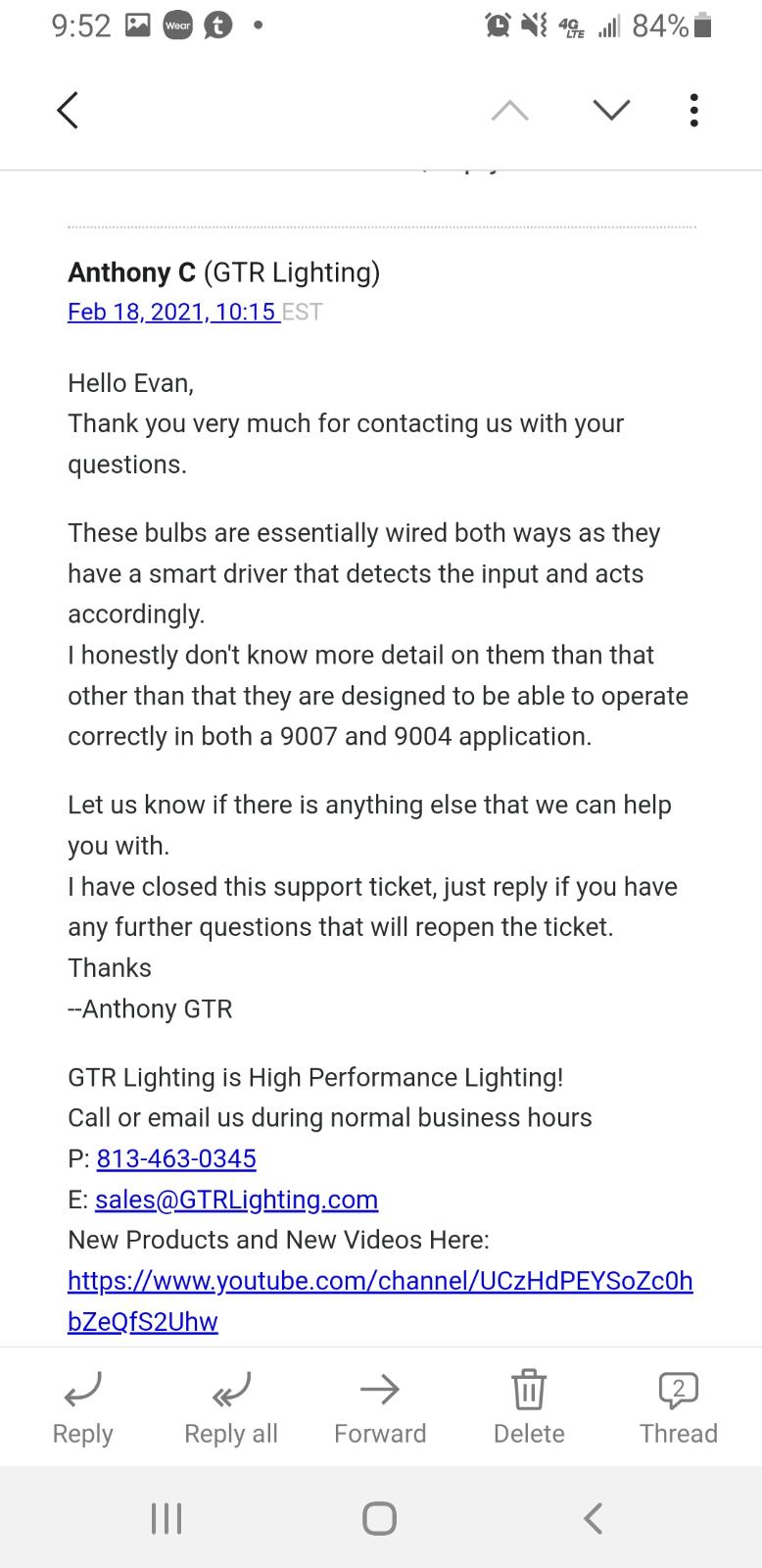

So morimoto is semi helpful but not realy.
On my own I figured out what was stated above. 9007 9004 are reversed high low beam.
The 2stroke 3.0 is listed as a 9004/9007 bulb the bulb is wired as a 9007 wich is reversed hi low in a truck with 9004. Make sense? I believe someone mentions earlier.
These bulbs are not symmetrical too to bottom morimoto has now said to rotate the bulb 180 to correct reversed high low. I said that bulb is designed to run upside down.
Morimoto seems to give information but only when I dig myself and confront them with the info.
I notice the gtr ultra bulb is also a 9094/9007 replacement bulb so its also likely to also be reversed
The sv4 is sold as 9004 or 9007 not as a single bulb to replace either the sv4 is also a upper led bulb contender
Im currently am running the bulb as it should be wich means my hi low is reversed.  Thinking on repinning my headlight plug to correct it.
