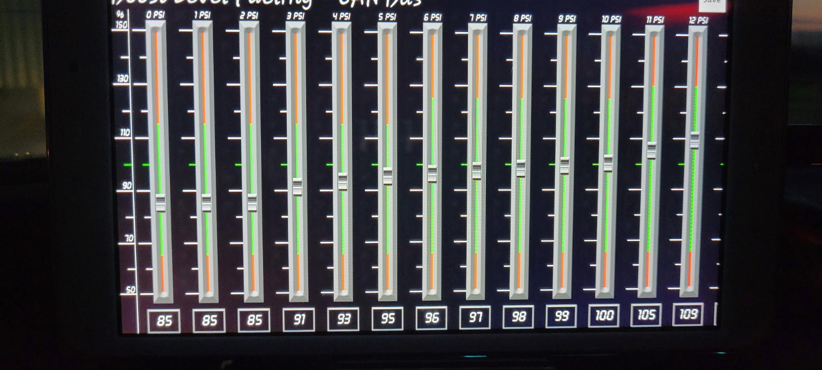

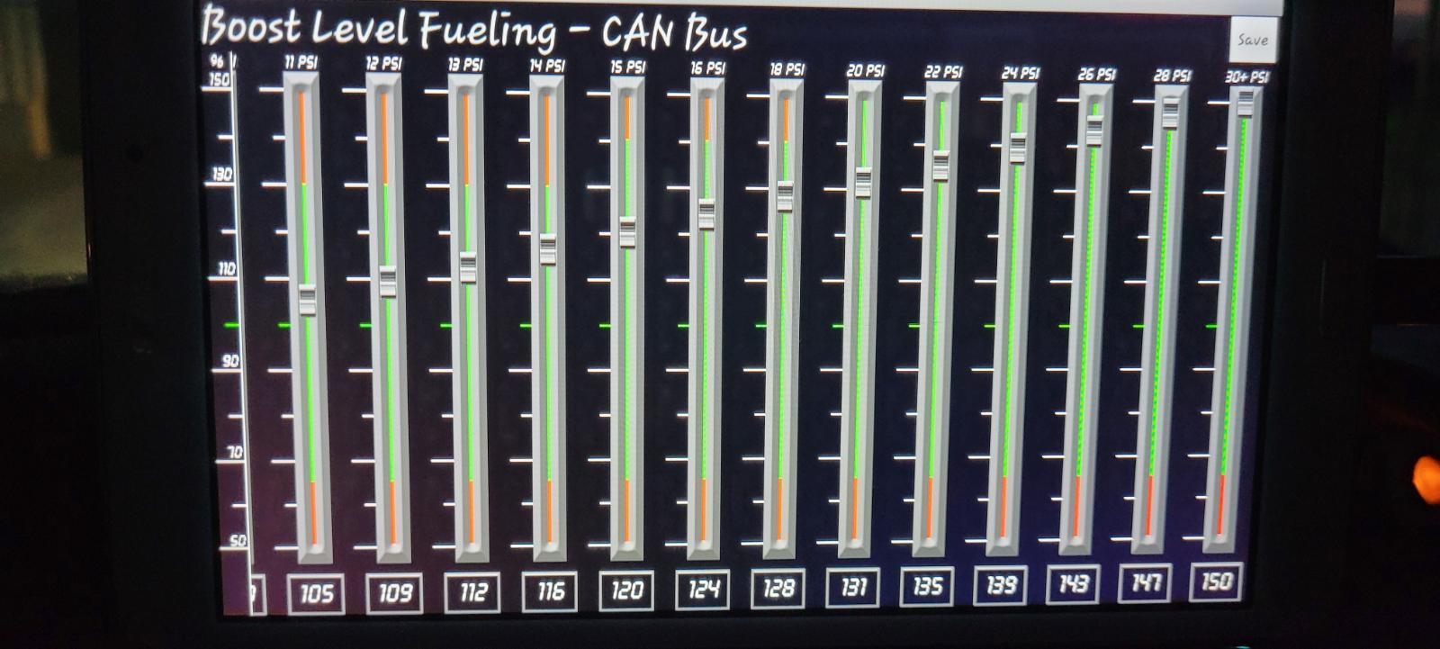

Here is my fueling curve. Try it.006.jpg.b273a42e9afdd3f65b76b5181bf93f0f.jpg007.jpg.e2835f18c4578ffd4d23c9cfa0a68758.jpg
