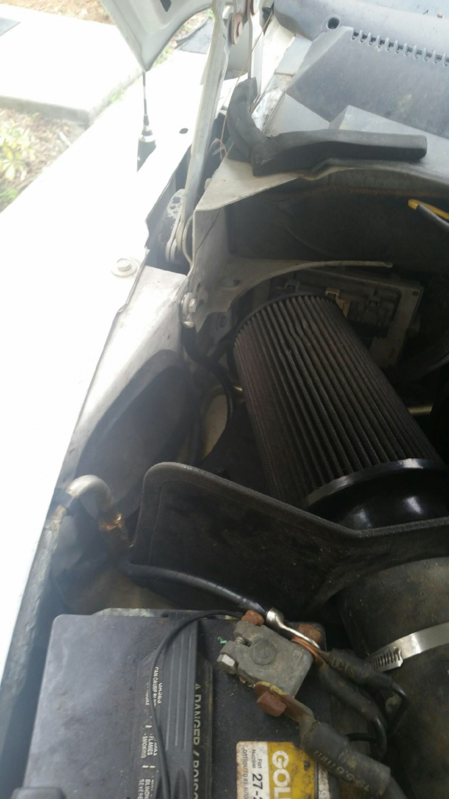

Ok sorry for the delay I wasn't getting notified of all the replys and have had a crazy day. There is a set of wires coming from the alt which are the grounds for it. Two have these grey connectors which I decided to eliminate because they looked all corroded so I used yellow butt connectors to eliminate them. Then there is a third wire that goes to the fender it's secured by a sheet metal screw. I cut that wire off and then decided to take a ground from the negative and ground it on the large bolt for the hood hinge. I didn't re set anythin just cut and spliced those wires and changed the ground that was on the fender. 3 of my trucks have been flawless since. A friend of mine was having the same issue on and off lately Monday I sent him the photos. He changed the wiring and that night the issues were gone. Talked to him Tuesday and again today still going good.  Others who are having this problem give it a shot it's so simple. I couldn't believe it made it go away I was almost to the point of putting in a Manual tranny in one of the trucks.
It's hard to see, but It look like you are just adding and replacing / fixing a ground ( PCM and ECM)?  The main battery ground connects directly to the block.  I am not sure I see the point of the secondary ground.   Not trying to be a naysayer but the 12 gauge wire is not even worth the trouble when you have that 0 gauge wire doing the same thing.  If you PCM / ECM ground wire was bad then fixing that is a good thing.

I'll have to take a better photo in the morning. one comes from the alternator and the other goes back towards the fire wall. I didn't know it was for the pcm.  The second pic was what my buddy did that wire is a lot bigger than the red one I did. I just moved that ground to the bolt for the hinge. Never tested any for ac noise

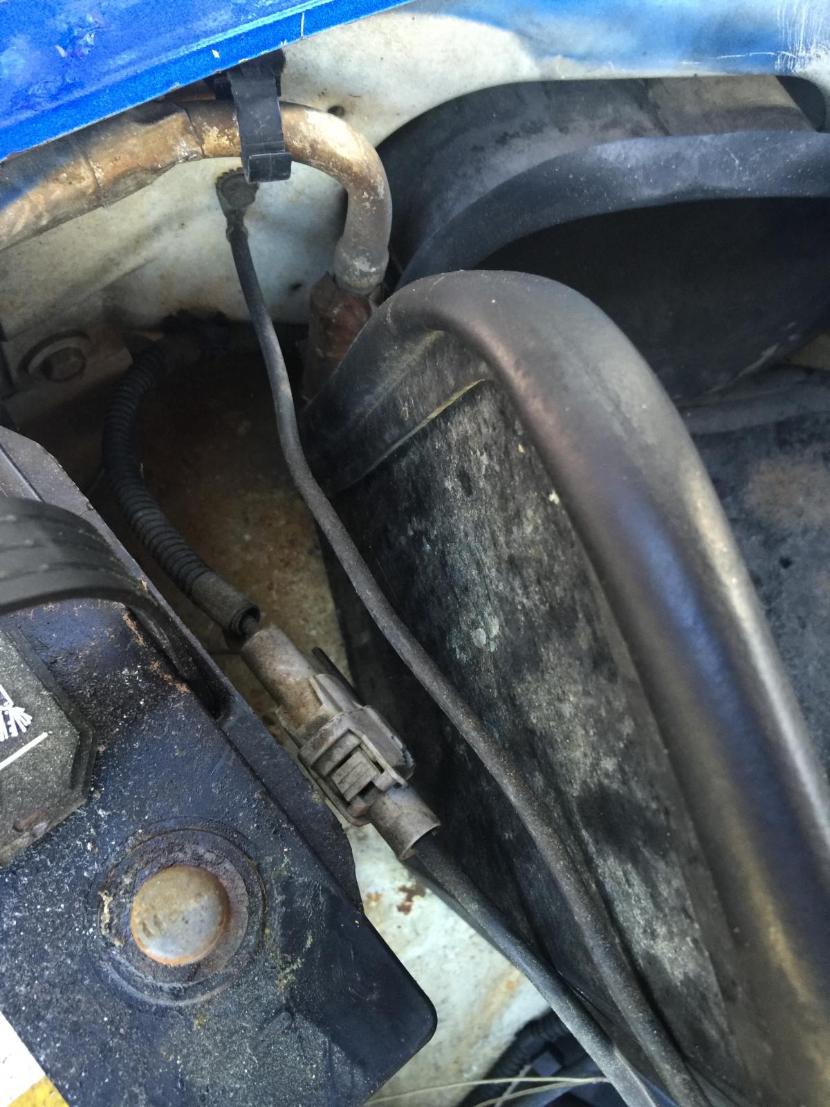

My point is the alternator is grounded to the engine block via bolts / mount, the block is grounded to the battery by two  0 or 0/2 gauge wires.  I don't see how another wire to the alt to ground is going to help, unless your alternator is not making good ground via the mount, which is possible.    The addition of a small gauge wire shouldn't be needed.

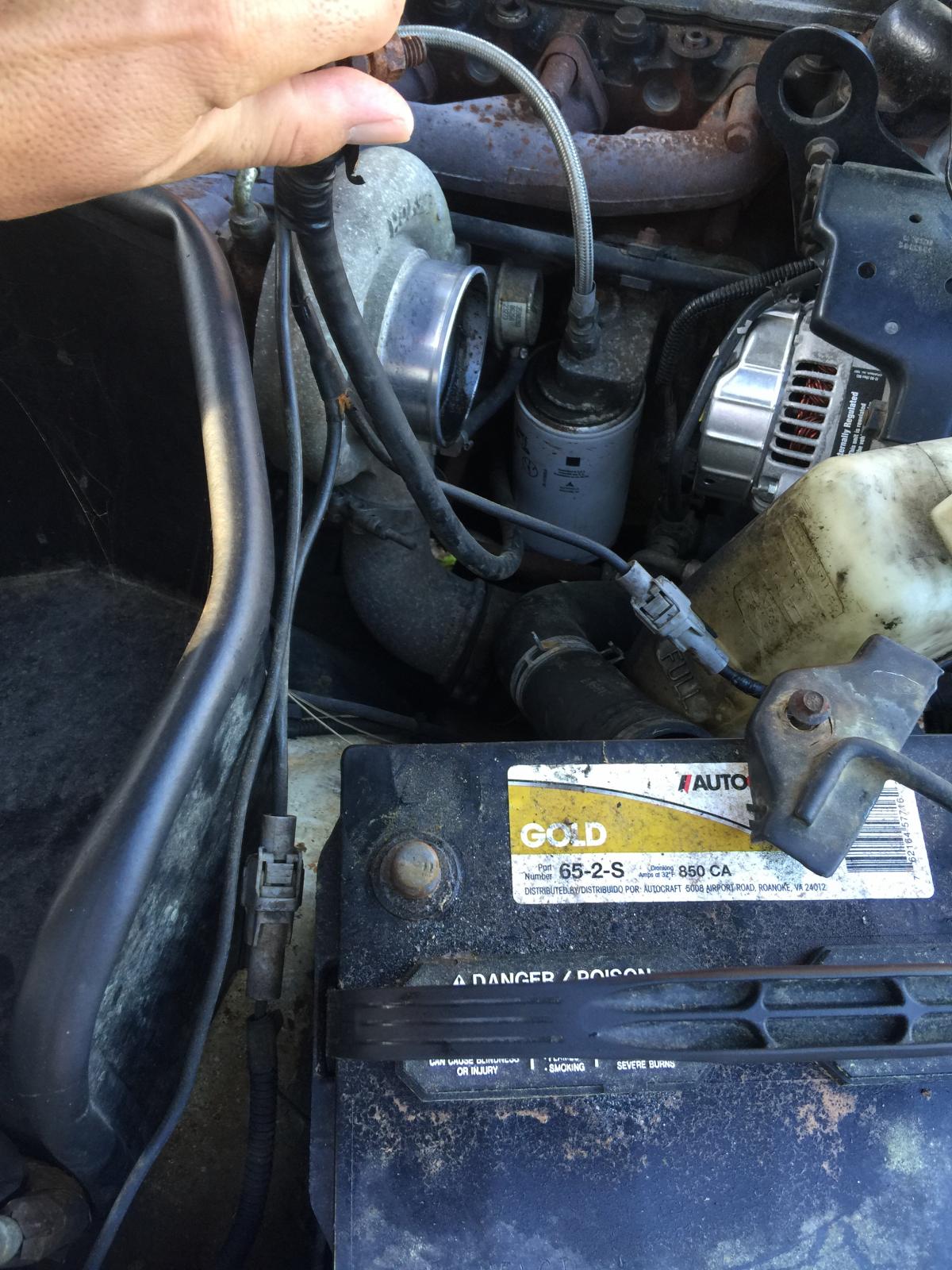

So the wire that you ground via the yellow crimps is the PCM and ECM ground
From what I can tell there is no wired ground to the alternator, it is grounded via the mounting to the block, as shown by the wiring diagram.

Ok these photos are of the one truck I have not done it to as its out of commission and hasn't been on the road in a while. This one did it the worst so I'm waiting on some parts to test this out on it. There are the two grey connectors. All I did was eliminate them and use butt connectors so that it makes a good connection. If you open those up they just look all corroded. Second picture is the ground wire that is just self taped to fender. All I did was take that wire off cut  it and made a new one then relocated it to be grounded on the large bolt for the hood hinge. In that group of wires one comes from alternator, other goes back to firewall into wiring harness and the third is the ground. I just relocated it. Never added any additional ground.
