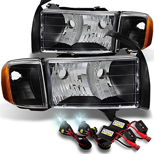

I've seen several Sport Headlights with HID bulb sets. I'm pretty sure this are not going to work very right?
https://www.amazon.com/Dodge-Truck-Package-Headlights-Ballast/dp/B012ER0YBQ/ref=sr_1_3?ie=UTF8&qid=1485364810&sr=8-3&keywords=2001+dodge+ram+sport+headlights
If you want HID's you need projectors,  HID's in a Halogen housing is a Big NO NO.  Remeber they don't have to sell you approved lights.
Cheap housings are also only good if you are going to retrofit projectors.  The reflectors in those are likely subpar.
