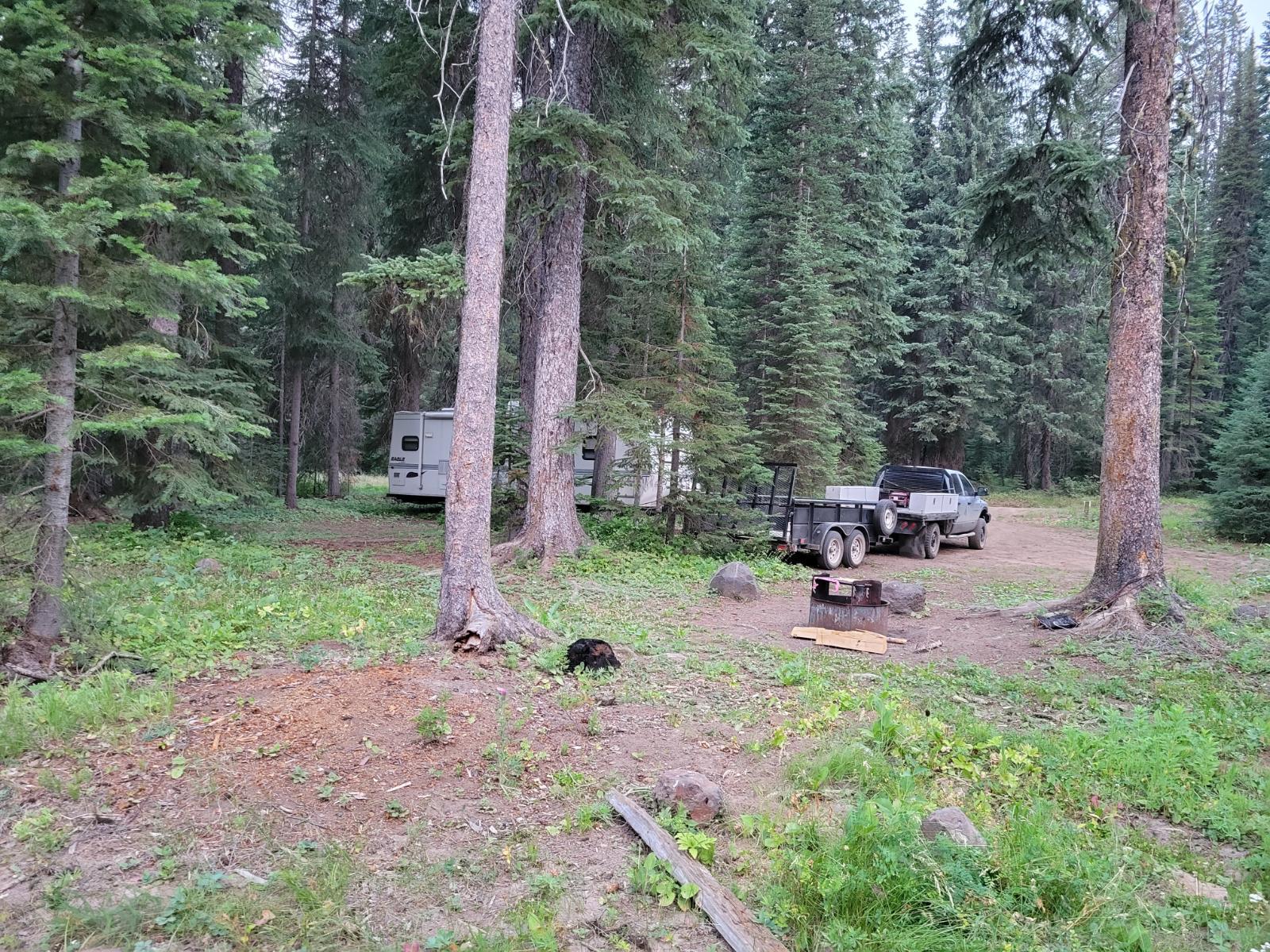

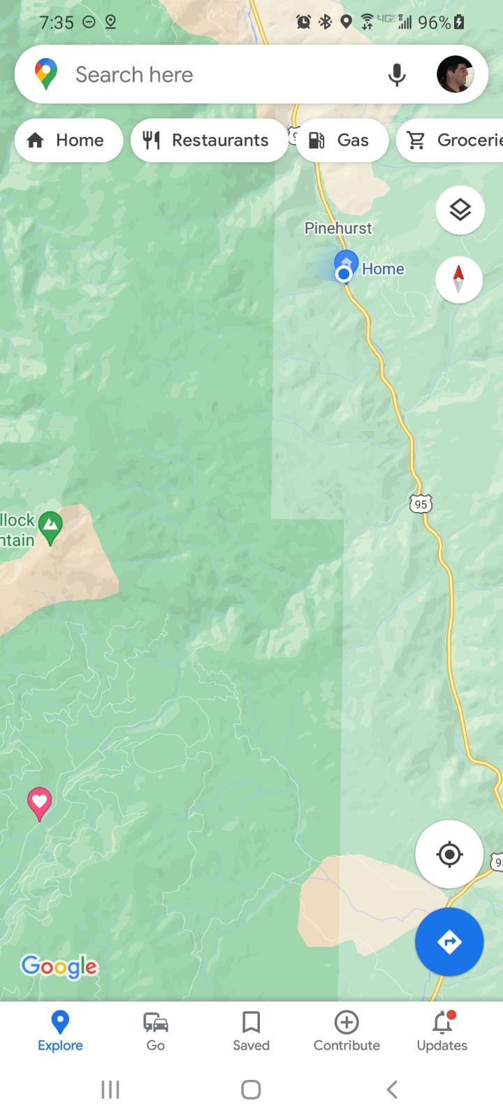

Last weekend... My 2000 Jayco and my 2013 BigTex Trailer.
Red Heart Icon is the camp spot from the highway...
