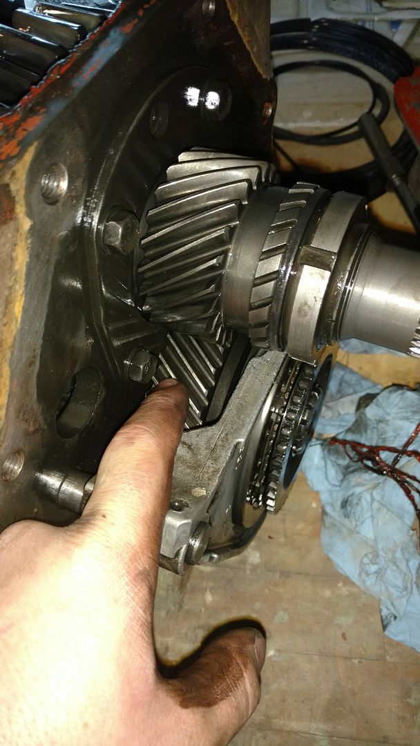

Blew the 4500 on Friday night. Cruising up a hill @20 psi of boost I heard a pop, and I had no 5th gear. I hoped it was just the nut backing off, but it was not. I drained the fluid, and it came out grey... not a good sign. Removed the OD housing, and everything looked okay, so I dropped the trans. Turns out the gear in the picture has stripped out on the countershaft. (Inside part of the gear is stripped) I've never seen a failure there before, but O well. It was bound to blow eventually.
I was consider rebuilding it, but after further inspection the entire trans is filled with metal flakes, and most of the gears are showing signs of surface fatigue on the gear faces. That means I would need all new gears, all new syncros, all new bearings, a mainshaft, and a countershaft. I don't feel like putting that kind of money into a trans that will blow again. I'm on the hunt for a G56 to put behind it now. I'll keep this thread updated.
