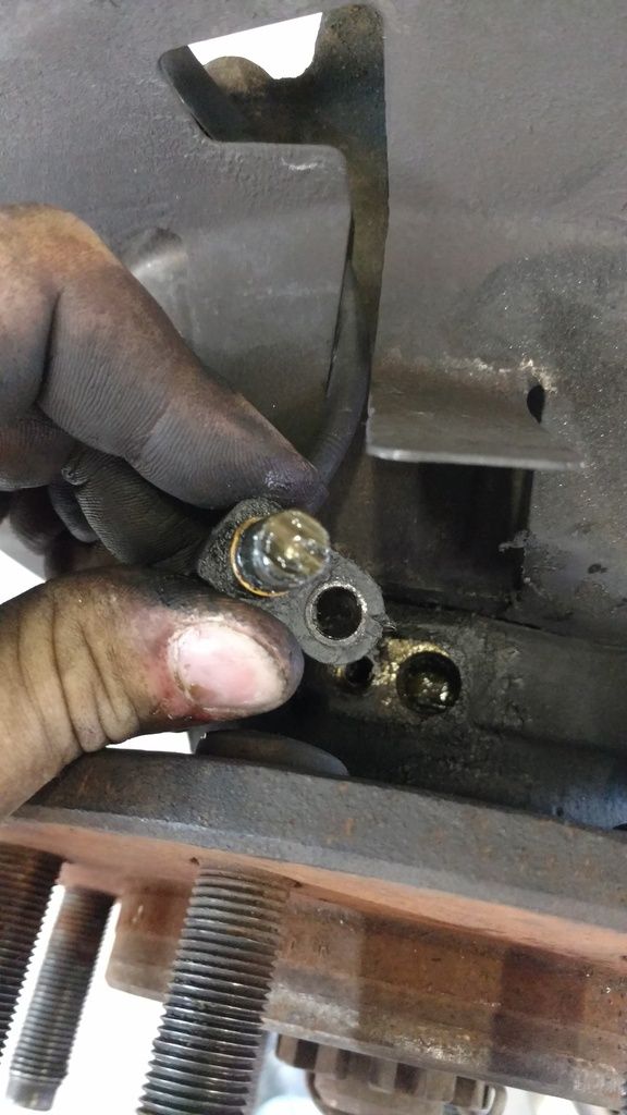

Lots of work done this weekend. I started out by pulling the old wheels and tires off. I then pulled the front brakes and put some grease in the bearings. The passenger side is still leaking, but I think I can limp it until I graduate from school. Still Zero issues with ABS  even though there's grease on the sensor and tone ring.

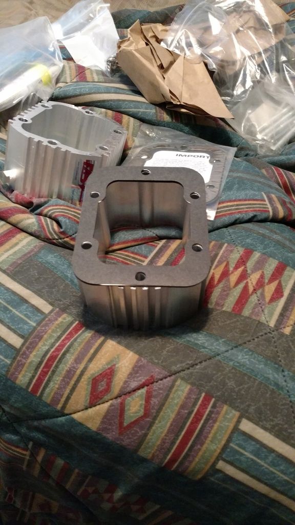

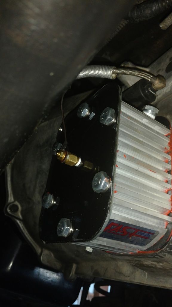

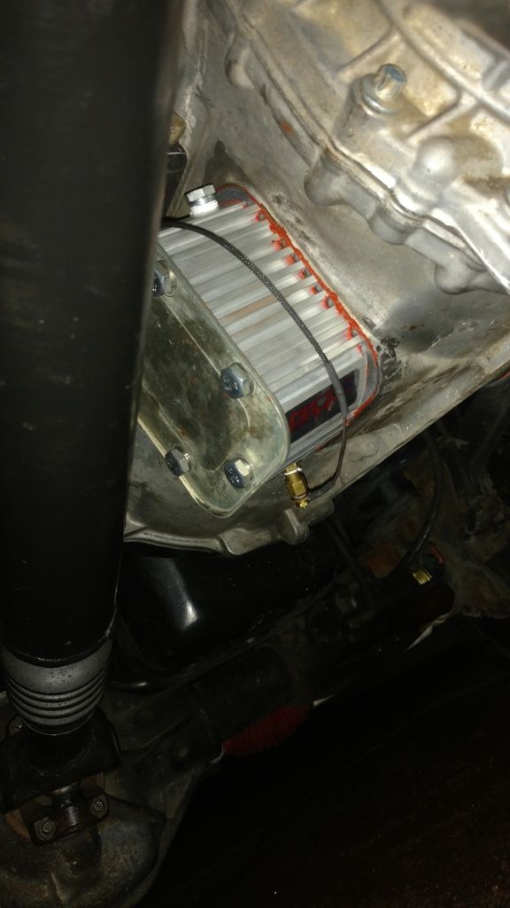

From there I put it up on the lift and drained the transmission fluid. It was Royal Purple ATF, but surprisingly it came out clean with no flakes and didn't smell burnt. The plug had the normal goop on it though. I then pulled the PTO covers and cleaned them up along with their mating surfaces. Then I used the "adapter kit" from Genos and installed a Fast cooler on the drivers side along with my trans temp probe from Quadzilla. The fast cooler only had a 1/4in NPT plug, so I had to use a 1/4in to 1/8 in adapter. This has made the temps completely inaccurate. After driving 45 min or so at 72mph the gauge read 120 on the quad. I Checked it with a IR gun and the bottom of the case was 165. If I have time this week, I'll pull the cover and weld a 1/8in NPT bung to the inside of the cover so the probe actually sticks into the fluid. VERY FRUSTRATING TO DO THINGS TWICE!!!! Anyway, here's a couple pictures.

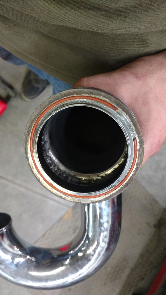

I then pulled the secondary turbo off to replace the gaskets between the manifold and the turbo because they were leaking pretty bad. I found a chunk of O ring missing on the intermediate charge piping. I've still got to track one of those down, but it doesn't seem to be affecting it too bad.

The picture on my bed.... The picture of the transmission has the cooler hanging off the side :thumbup2:

Well I wasn't happy with the sensor location.... Down where it was it would catch snow, and I don't think I was getting accurate readings. So this weekend I drained all the fluid again (came out nice and honey colored like when I put it in) removed the PTO cover and got to work. I picked up a steel double female 1/8in NPT bung from napa and cut it in half. I then drilled a hole in the cover and welded the 1/2 bung to the inside of the cover. I figured the further in the better! Sealed everything up and was good to go.
I drove it 140 miles yesterday with good results. Running about 65-70 in 6th gear and 70* ambilent temps the transmission stayed around 130 to 132. After getting on the freeway and running 75-80 for 40 miles or so the temps slowly climbed up to 139. Traffic then got heavy and I bounced between 0mph and 50mph. When traffic slowed down the temps dropped back down to 130. Looks like the fluid is staying cool and doing its job!
