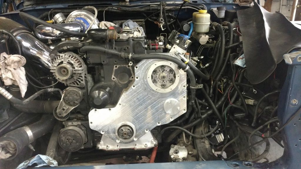

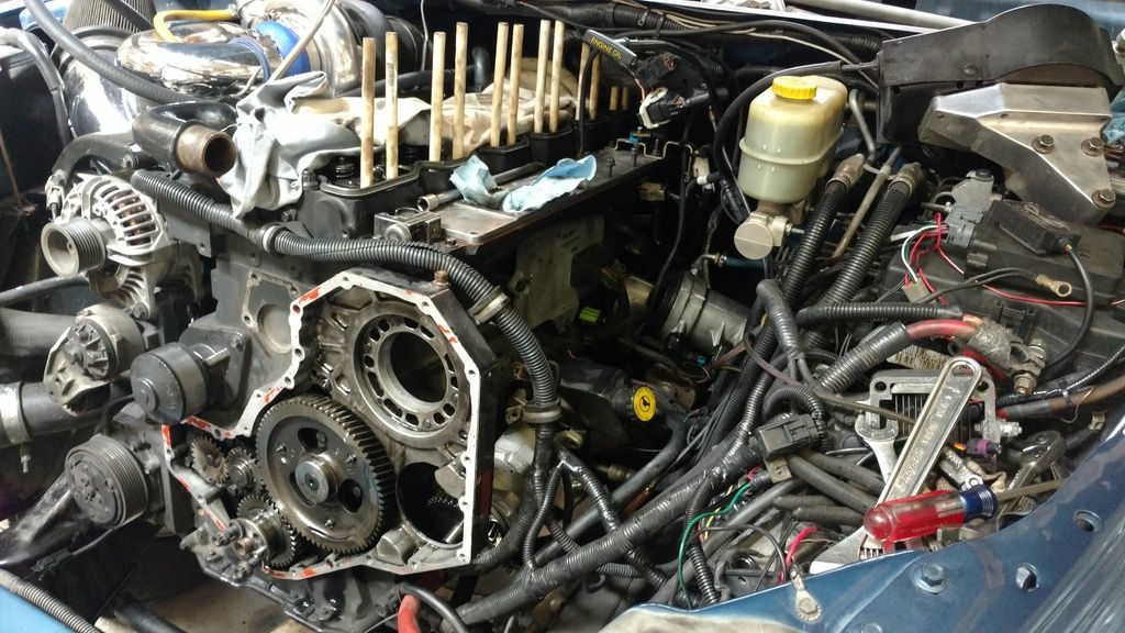

Teardown was pretty fast and easy. I got some POS dowels and #1 intake tappet fell into the pan later, but I was able to fish it out.

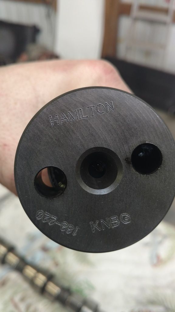

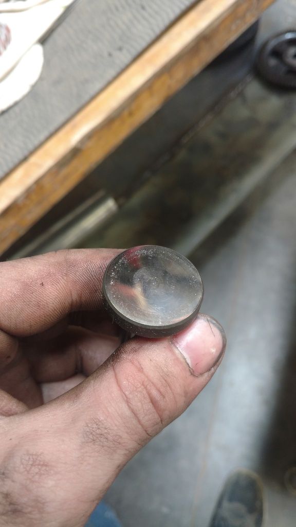

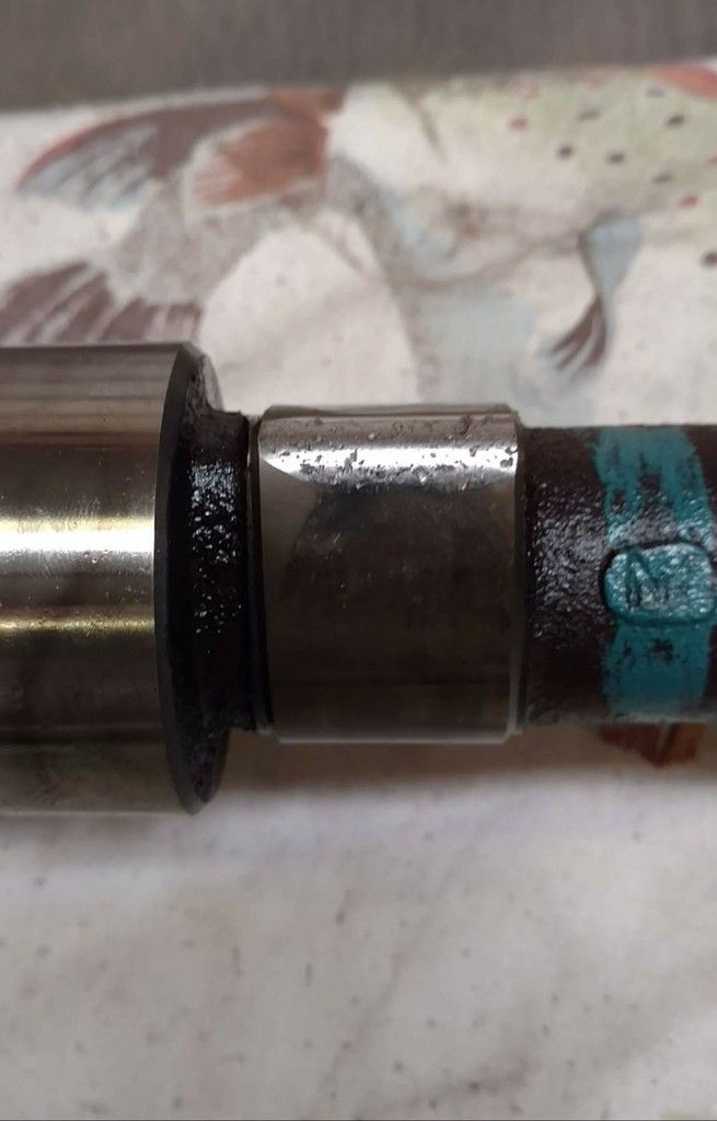

Then I pulled the cam and that's where things got ugly. Only a couple of the lobes weren't worn down bad. I checked the tappet on the worst lobe and it was just fine, so that tells me the cam is a POS. I did hamilton's break in procedure, always ran their zink additive and what not so I put the stock cam back in it.

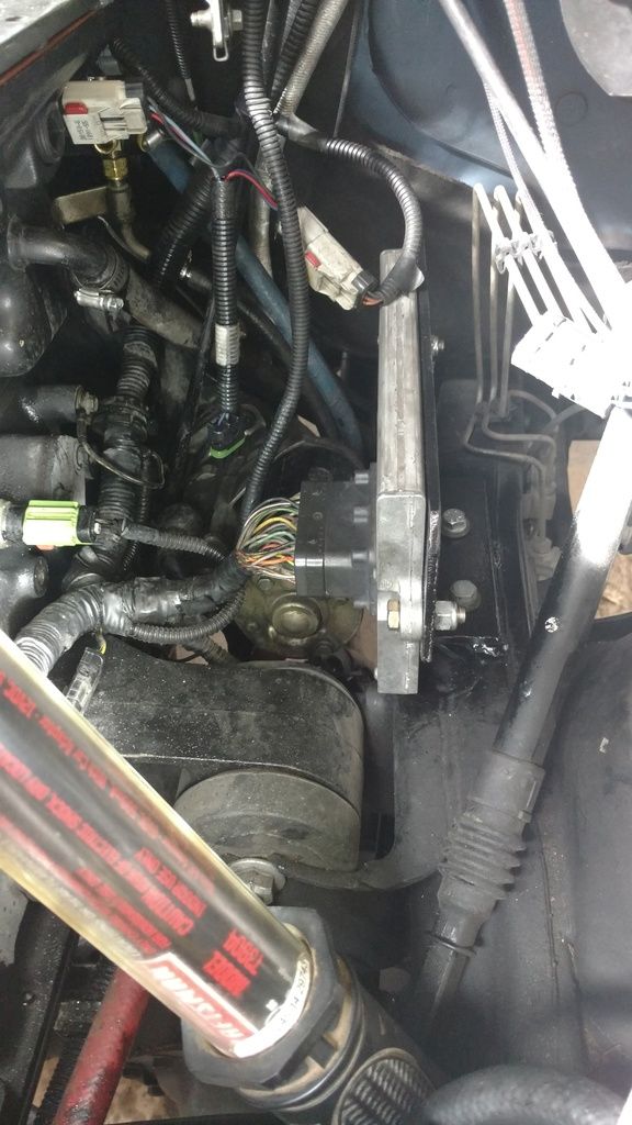

My dad built an ECM mount since I have a 12v tappet cover and the ECM couldn't just be spaced out like people normally do.

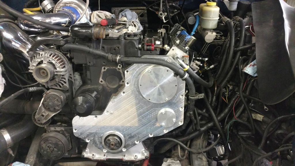

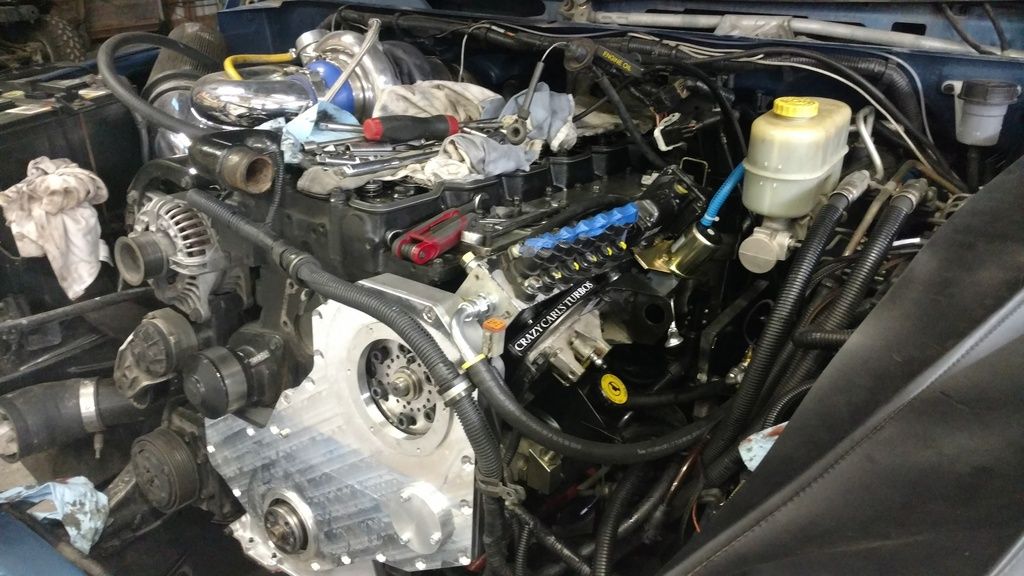

I put the case in, stuffed the cam in, and realized I forgot to file out the cam sensor adapter hold. So I pulled the cam back out, filed the hole out, put the sensor in, and stuffed the cam back in. I then put the pump in, timed it (pin timed to 14* then moved pump 3 holes on the adjustable gear to get 20*)
I put the rest of the front together, pump lines, etc so I could start it.
Then the pump was leaking around the O ring hole. So I pulled the pump out, went to Cummins, got a new O ring and put it back together. It leaked again after that, so after talking to Seth and Jacob I RTV'd it in the hole and it quit leaking.

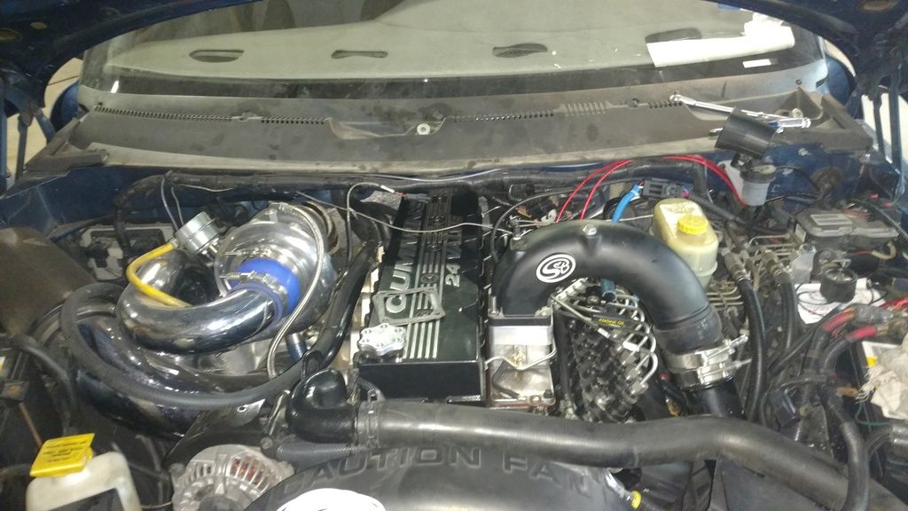

I made new studs for the intake horn until my tunnel ram shows up (@turbolvr you guys must be swamped with orders to be backordered that far!!!)
I ran the AFC live hoses, wired in the shutoff solenoid, hooked up the APPs stuff and probably a bunch of crap I'm forgetting.
I then took it out to drive and for some reason the shutoff solenoid keeps dropping anytime the truck builds boost or gets to higher rpm. It dropps at about 3800rpm or 40psi of boost. Whichever comes first. I even tried hotwiring the solenoid open with no luck. If anyone can give advice on this I'd love to hear it!!
So I wired the solenoid up to drive it a bit. I had one small leak on the front cover where a bolt goes in, but I think I can RTV that to fix it. I got it on the highway and made about 60psi of boost with stock HO injectors :hehe:
Took it back into the shop to find it puked over a gallon and a half of engine oil. I think it was the tappet cover, but I didn't have time to tear it all back apart and put it back together. So I left it at home and headed back to school. I'm going to pick up a billet cover, run a breather out of the oil fill, and possibly put another in the valve cover. Maybe @turbolvr has some advice on this??
So at the end of the day it's still a cursed pain in my a$$ that doesn't want to be reliable with a Ppump....yet.

What's the purpose of the dowels?
3 hours ago, notlimah said:
Might not be reliable yet but at least it looks good!
The dowels get shoved into the tappets to hold them up. Otherwise you can't get the cam out :thumbup2:

At least you got to drive the Frankenstein
Oh it's very nice to drive. I was FAR from having it dialed in correctly and the engine sounded 10x better than a healthy VP. Also made a ton more power with those stock injectors than I could have imagined.

I called Hamilton and they were less than helpful. I told them how I installed it, how I had ensured clearances were good etc. etc. All he had to say was "well this doesn't happen often. I can get you a new one for $450" - Like hell I'm going to pay another $450 after ruining one in 25k miles.

It's not like they tried to deny it was their fault or say I did something wrong. They fully accepted responsibility when they said it doesn't happen "often." I was at least expecting them to ask for pictures so they could figure out what went wrong, or ask for the cam back so they could know where one of their processes went wrong. They just didn't seem to care.... didn't seem surprised in the least bit that it happened. I will be recommending against their products from now on.
