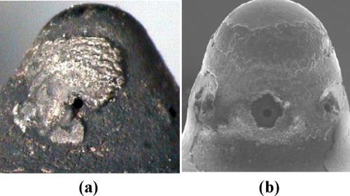

The only residual film should be oil. There is no ash in quality US made 2 cycle oils today. I seriously doubt there is anything left after the burn process occurs the remaining should be burned off as part of the fuel. Now back in the days of WEO usage that was very very true. The high amount of carbon and ash in the used oil would absolutely build up debris.
Ash deposits from ATF or WEO.

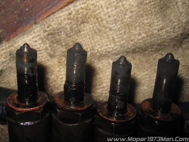

Again... Ash deposits.
