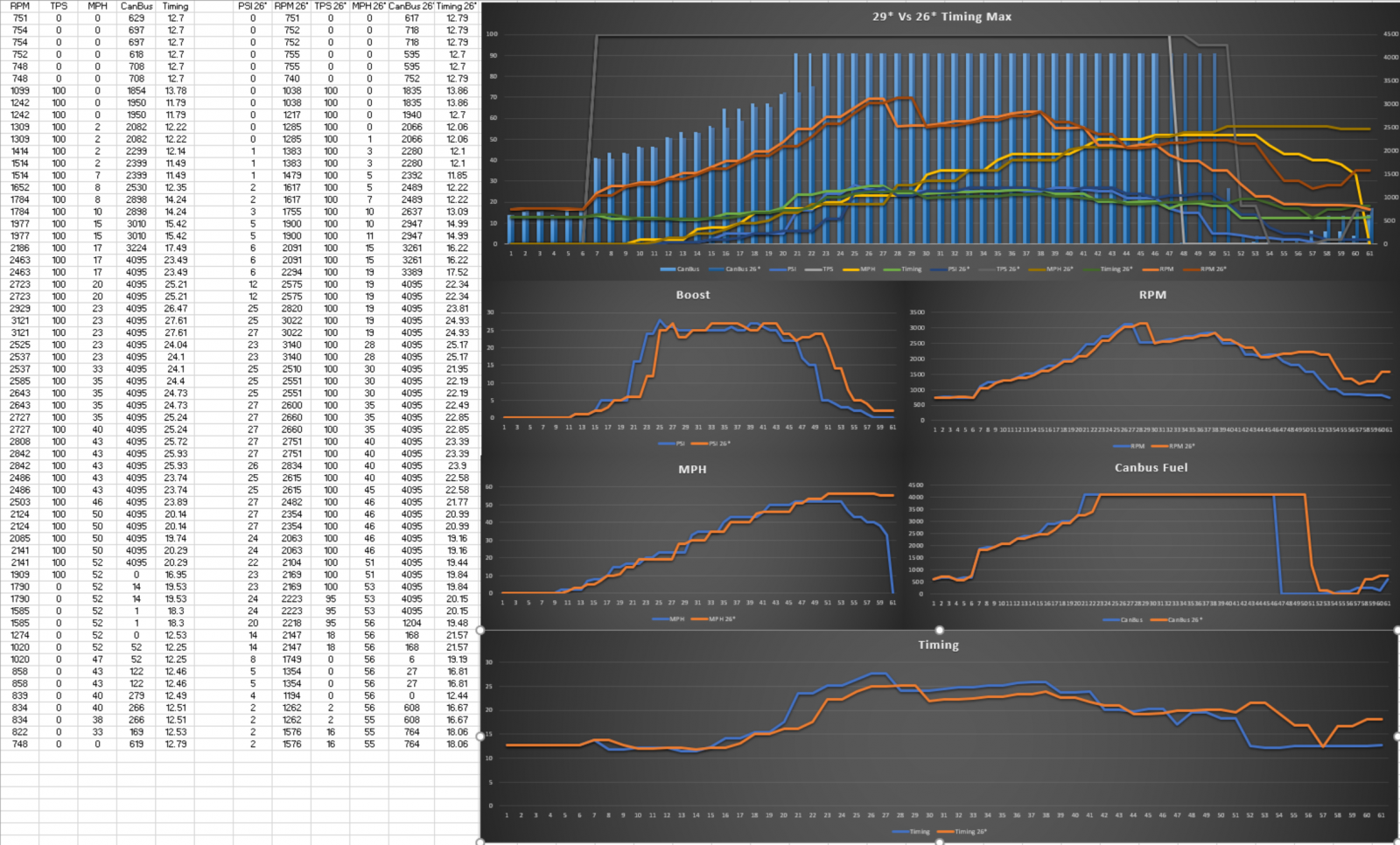

I saw it threaded onto them but couldn't come up with how I could use it I guess lol... Anyway I did a thing tonight, 0-100 on my daily tune with no wire tap... Couldn't see smoke output but its next to nothing I imagine... Here's a video of my dash and a data log... (all done on closed course....... Of course...lol)
daily0-100.csv
daily0-100.csv

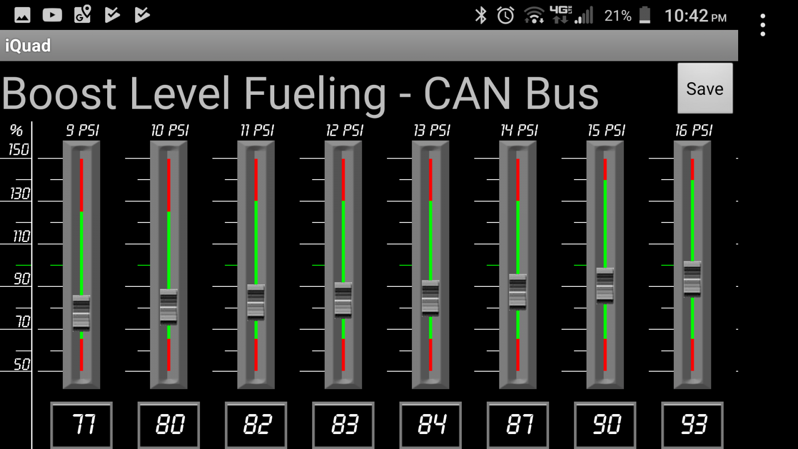

I'll just leave this here.  Went for a quick spin and the three tunes I built need a good bit of work so no data or videos for now.  More to come hopefully tomorrow.
Looks good! Looks like a very slight haze??  Mine are about a third the amount of haze compared to my 6x.013"
