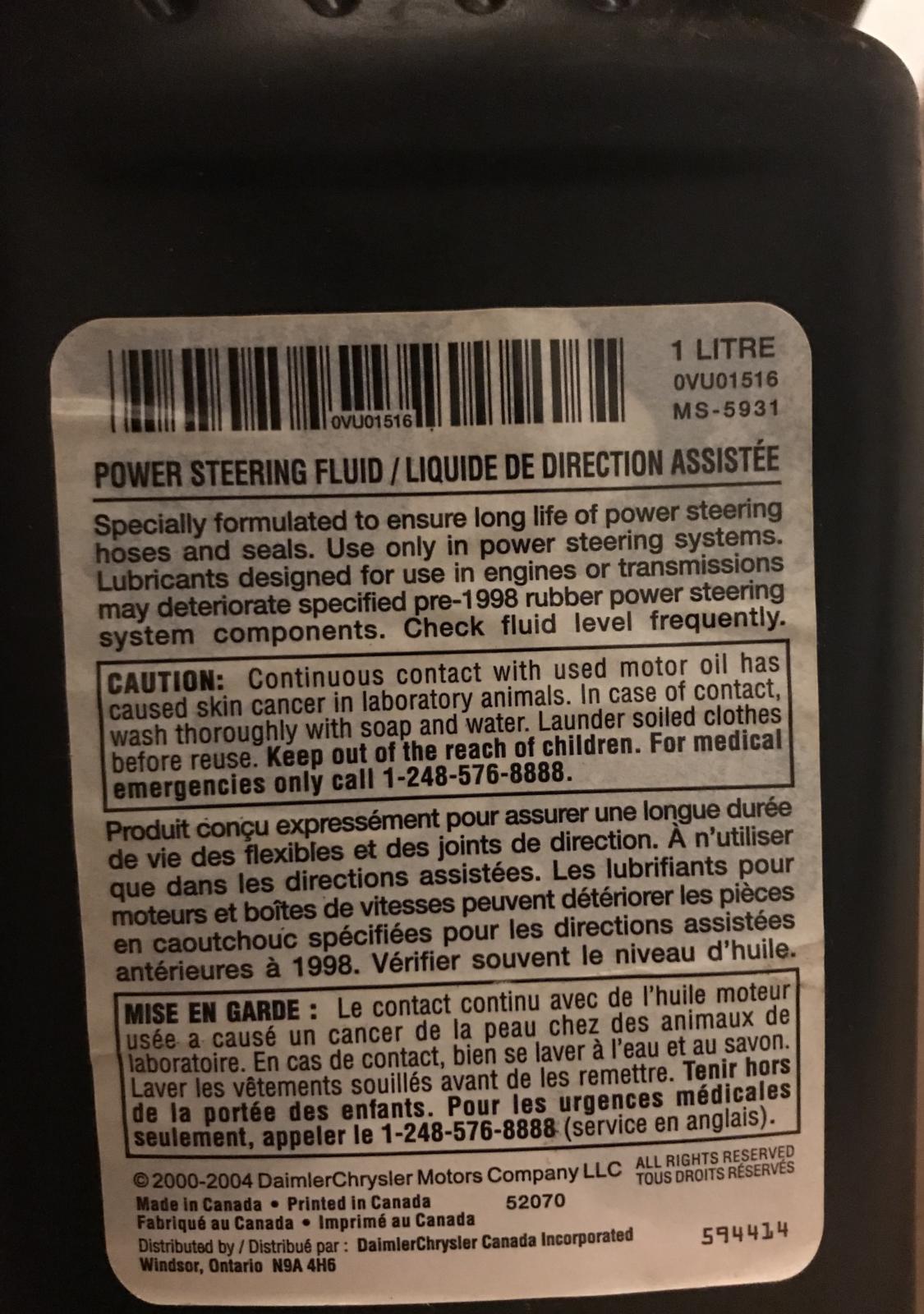

47 minutes ago, ofelas said:
For pre 2003 vehicles, I use MS-5931 (or an equivalent parts store spec fluid in a pinch), though the back label does imply that ATF can be used in post '99 vehicles
Haven't had a problem yet in temp extremes FWIW.

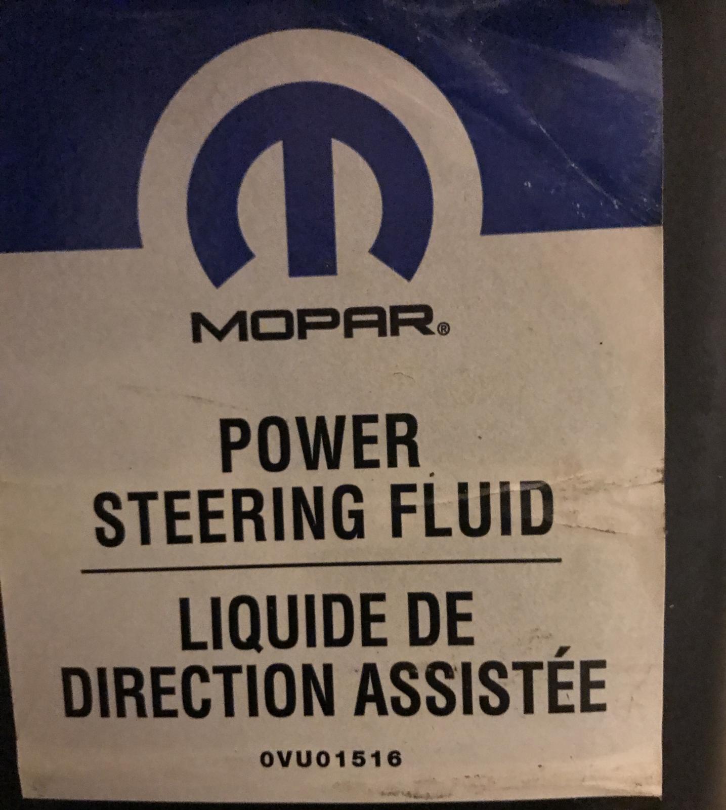

this is interesting, what I don't like is the "use ONLY in vehicles pre 1998"  is there another Power Steering fluid from Mopar that is for post 1998 vehicles?
23 minutes ago, portlandareae28 said:
its pronounced, "wine"
No, it doesn't say "use ONLY in vehicles pre 1998".
It says - "Use only in power steering systems", - as in don't use in transmissions.
It goes on to say "use of engine or transmission lubricants may deteriorate pre-98 rubber PS components" - as in don't dump your favorite Rotella or ATF into pre 98 power system reservoirs.
The French, despite their odd habits, appear to have a superior public school system when it comes to deciphering English labels.
For your 2001, MS-5931 is ideal; ATF+4 from 2003 onwards, but doable from 99-2002 as well.
We can, of course, blame the Germans for these confusing labels as they took over Chrysler in 1998.
