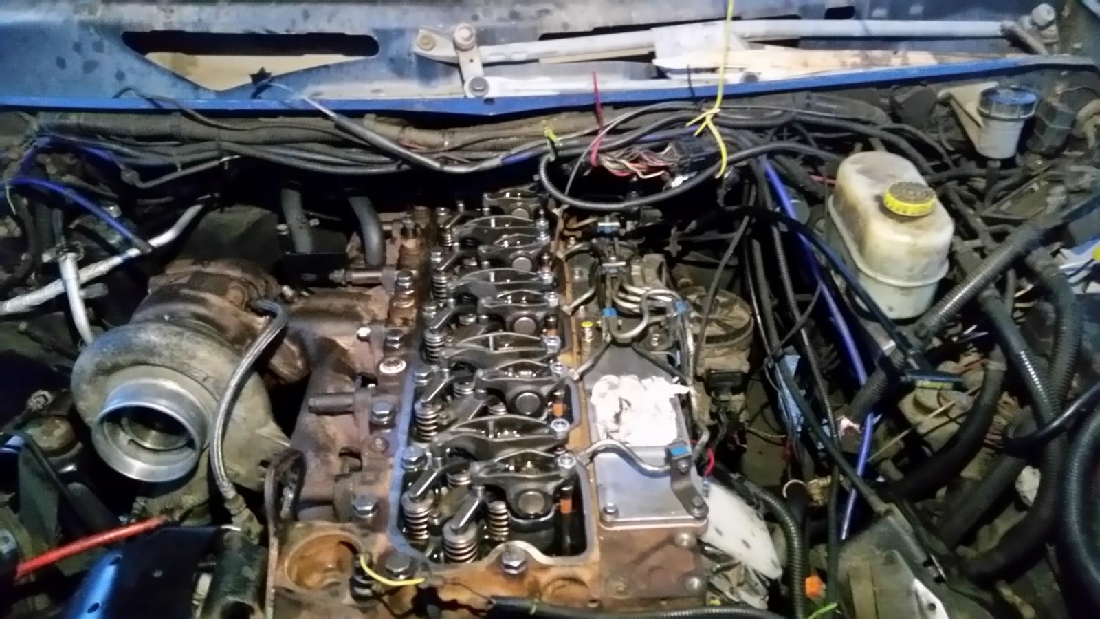

Struggled a bit on the test drive. Didn't get to the main road before I could tell that one of clamps on the intake horn was loose. Still ran good just made a strange noise.
Go back and tighten it up and head to the main road. All is well. Turn down the main and a miss slowly comes on. Turn around and head back and it gets worse. It was a  strange miss not like a dead cylinder. I get back and open the hood and its a miss I have never heard. Very erractic. I have raw fuel and a slight hint of blue smoke. Also have 2 injector lines weeping a little but never had a miss from a leak that small. Got to dig a little deeper.
I pulled the valve cover and low and behold the intake bridge on #6 has fallen off the valves. I can see the push rod is way up above jam nut. Not sure what to the think, I know the mechanic says he tighten them. So I reinstalled it and I see what happened. There is only a small arc open in the rocker to turn the wrench. I caught myself again thinking it was tight only to realize that the wrench was hitting the rocker after it starting snugging up. Had to reset the wrench to really get it tight. Double checked all of them just to be sure. Fire the truck up and its running fine.
Took another test drive and all is well. I don't  figure I have hurt anything but I out my realm on that one. What say ya'll?

It doesn't sound like the intake valves were held open - that's good.  Were you able to rotate the afflicted pushrod to see if it is still straight?  If the pushrod is straight I think you are good to go.
The raw fuel symptom makes sense - no fresh air entering the combustion chamber.
- John

7 minutes ago, trreed said:
@dripley it'll be fine just fine.  I had an intake rocker pull the threads out of the head, and it was knocking and smoking like a Power Stroke.  Put a longer bolt in the head, and it's been good to go ever since.
Manton guys were nice enough to give me a free set of longer ARP bolts for rocker assemblies when I purchased trunnions from them

5 minutes ago, Tractorman said:
The pushrod absolutely needs to be straight, as it rotates constantly while in operation to ensure uniform wear on its mating surfaces on both ends.
- John
I realize that and will check it soon. For today I am done with #6. If its bent I have spare push rod and adjusters. Lets hope it is not.
Edited by dripley
