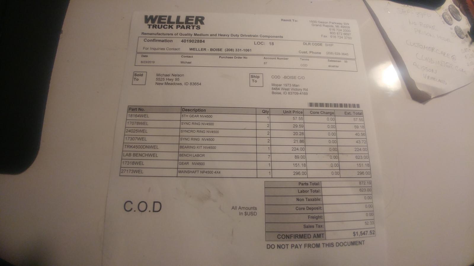

Then the only things replaced previously was bearings, syncros, mainshaft, and larger 5th gear (hard facing was bad in the bearing hub).

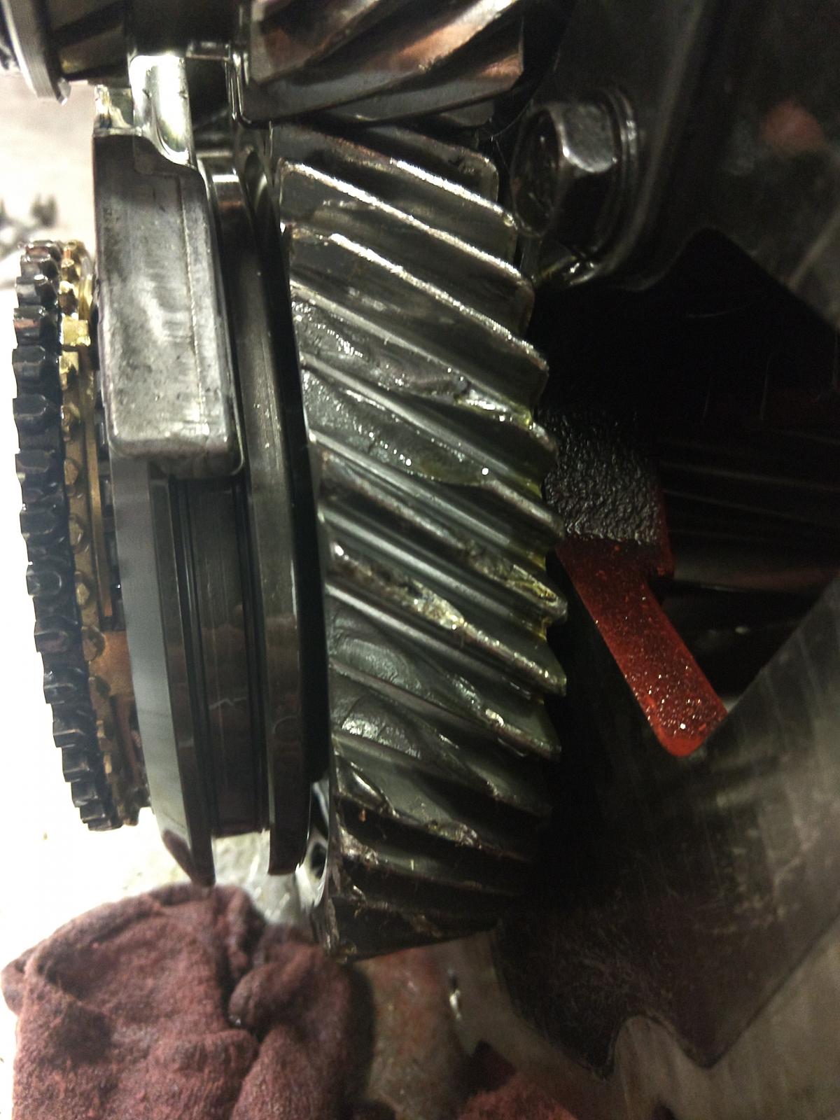

Close to 500 HP. Did it on the interstate west Caldwell in the 80 MPH zone. Back off for semi truck to pass another. When it was clear rolled into the power and hit resume on the cruise. 5th gear disappeared.
Drove home in 4th.
