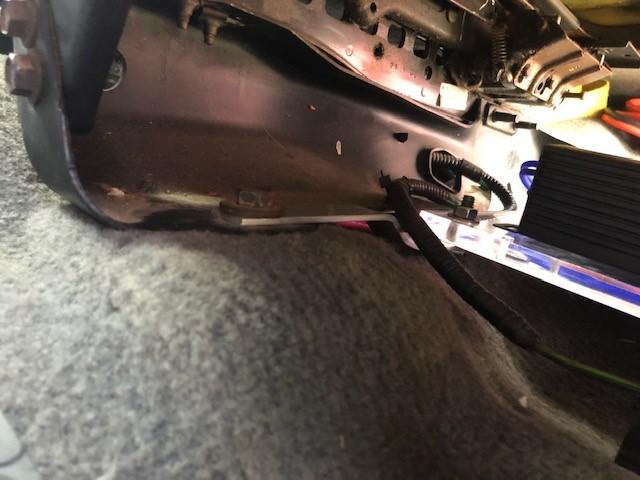

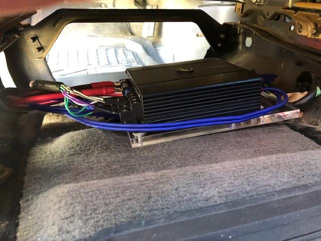

Rear view of amp under driver's seat.
the nine wire speed cable (on the right) is connected to the amp speaker out put and the switched power terminal.
This is the input signal from the factory radio head.
A nine wire speed cable is used for this also.
